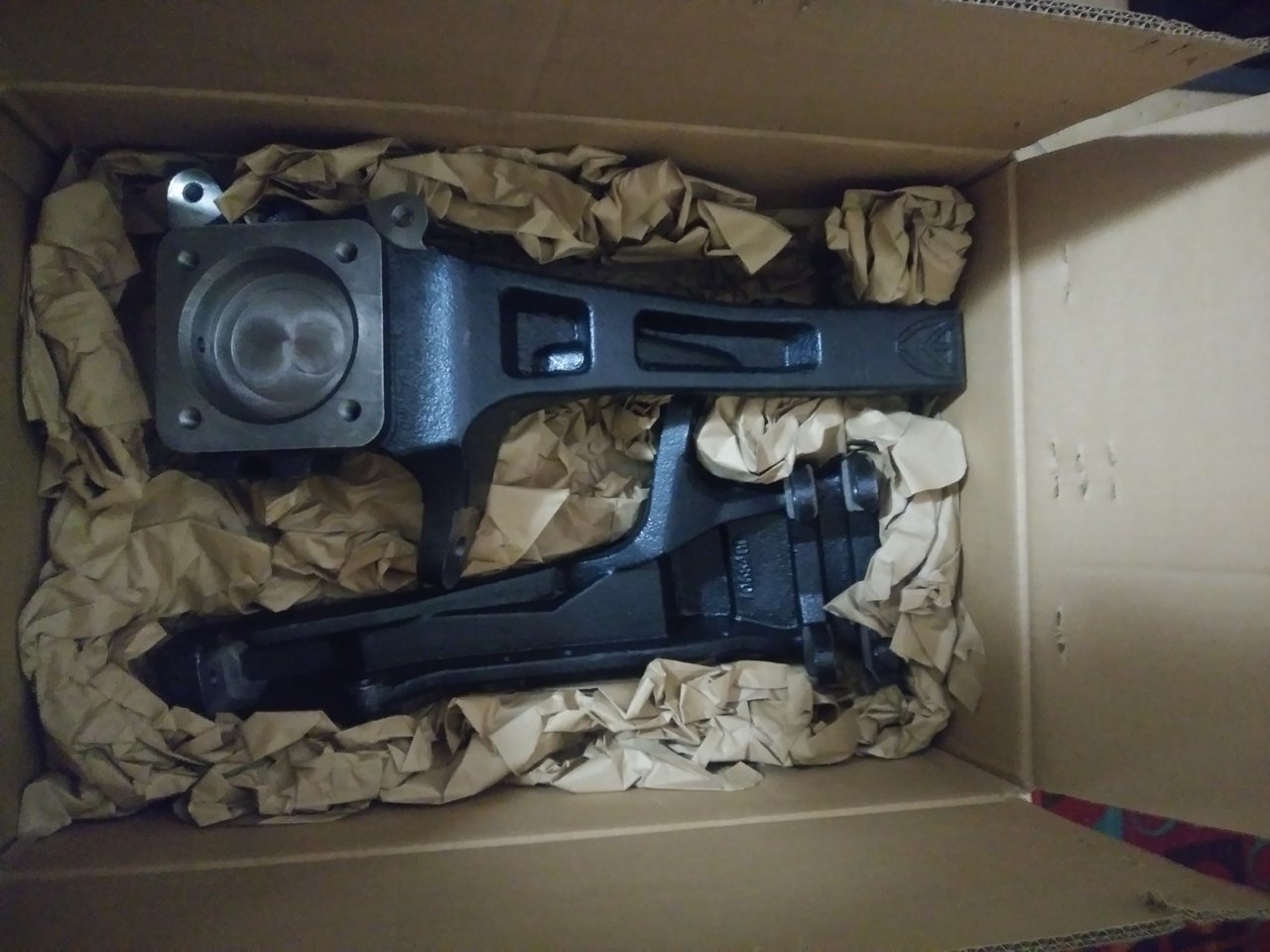

    Yes, I painted them yesterday! 2 coats of self etching and 3 coats of rust-oleum. :)

    What do you mean?

    There are threads inside the load bearing section of the spindle. Looks like it's almost bottomed out too. Maybe its just the angle.

    Anybody have an estimate on what it would cost to have spindles powder coated?
