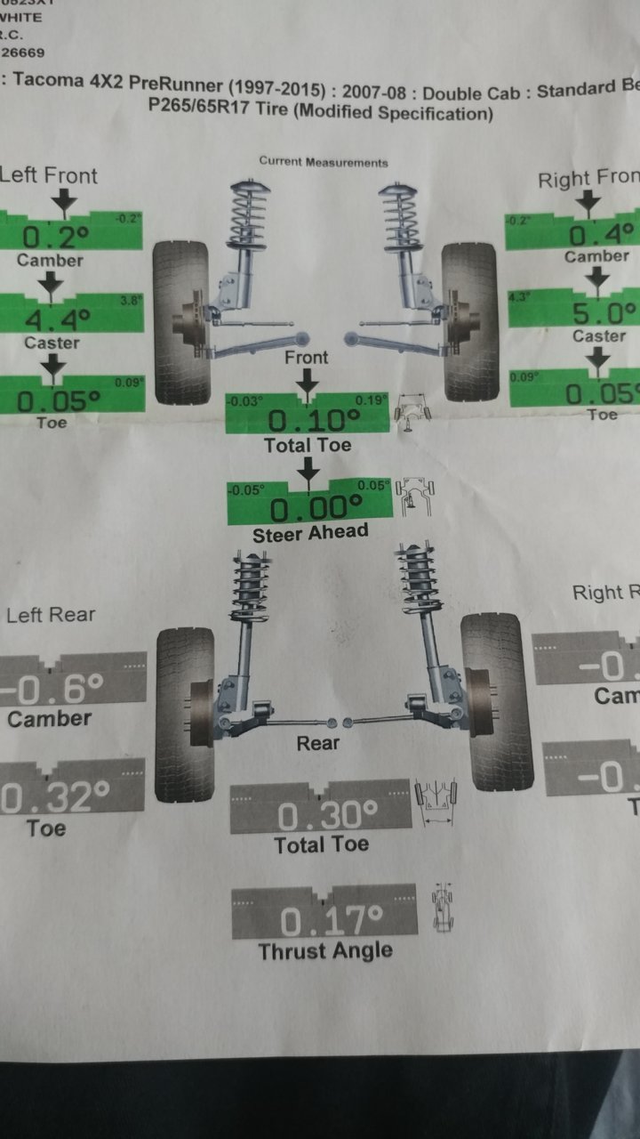

    Hey guys, since I have uniball ucas would this alignment be ideal?

    I'll check to see if I have some extra extended length brake lines. If I do, you can have them.
    Toe: good
    Camber: decent - if you're going to go back see if they can even up the numbers
    Caster: that's a lot of caster. Couple things to think about. The delta between the two sides will mean that the alignment tech is "compensating road crown". Also, with that high of a caster, your steering may feel pretty stiff. But, those two things are driver's preference. I like my caster to be equal to one another and closer to 3.5, but that's just me.
    Overall, a pretty decent alignment.

    Yea I'm planning on going back because as I was driving back on the freeway, I noticed the steering wheel had a slight tilt to the left when driving straight.
    Thanks for the input !
