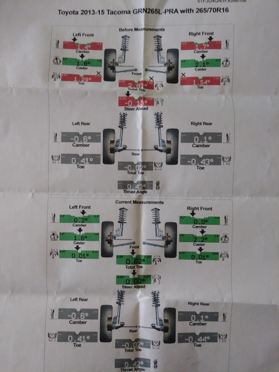

  15. Sep 4, 2018 at 8:48 AM
    sblspawn
    sblspawn Well-Known Member
    Apr 24, 2018
    #251505
    1,067
    Still shaking randomly between 50 and 60mph. This is the alignment print sheet.
    ChadsPride likes this.
  16. Sep 4, 2018 at 8:56 AM
    Biscuits
    Biscuits Thorny Crown of Entropy
    Aug 8, 2010
    #41397
    15,577
    Swiggity swangin' biggity bangin'
    Those are good alignment numbers.
    The shaking you're feeling is endemic to everyone who lifts their Tacomas. Now enter the troubleshooting phase. Were you able to take a picture of the driveshaft at the slip yoke?
