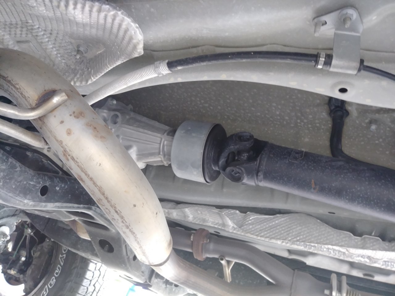

    Pardon my ignorance! I' just learning here, but how can be related the carrier bearing with the steering wheel shaking awfully? :confused:

    In the broad strokes, lifting the truck alters the geometric angle of a rotating mass (drive shaft). Once the angle of that rotating mass is out of alignment, even by a single degree, with everything else it connects with, it'll vibrate at a particular rpm range. The sole purpose of the carrier bearing is to serve as a center support bearing for your drive shaft. So as you lift the truck and alter the angles of the driveshaft in relation to the pinion and transmission output shaft with a third joint in the middle (carrier bearing), you have to do something to return the angle delta of the driveshaft to near zero. Lowering the carrier bearing will do that. The biggest question is by how much does the carrier bearing have to be dropped.
    I mean, if you really want to get into the nitty gritty, we can start measuring angles and doing the math. If that's the way you'd like to go I'm more than happy to help. But the options I listed above are quick and dirty one size fits all solutions that most people have had success with.
