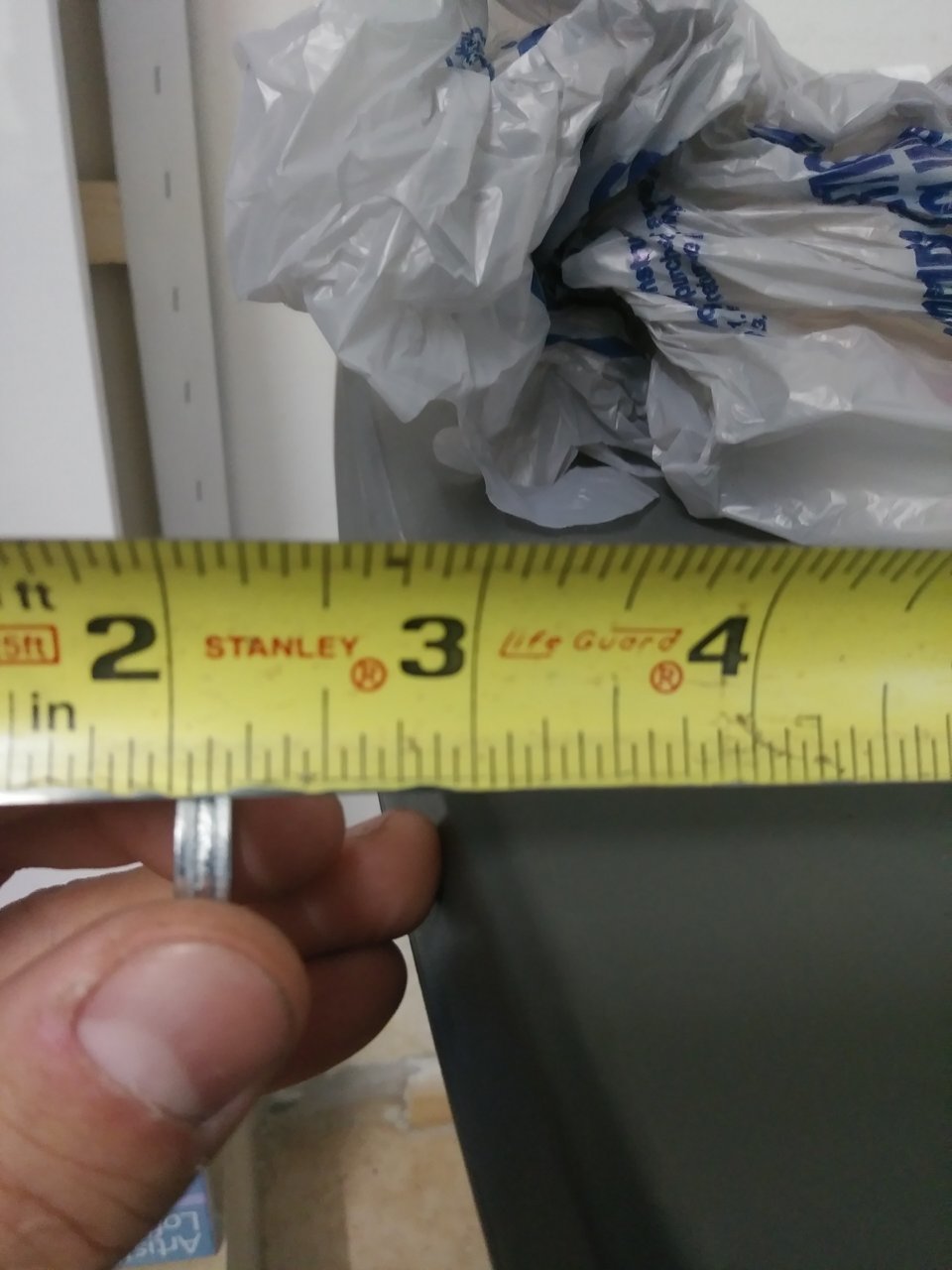

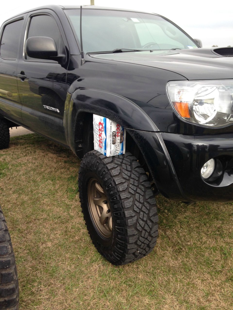

    Since this is all about MaxTrac spindle lifts...
    ...and the only way to properly measure clearance:

    Oh that's nice! How come I've never seen this truck b4??

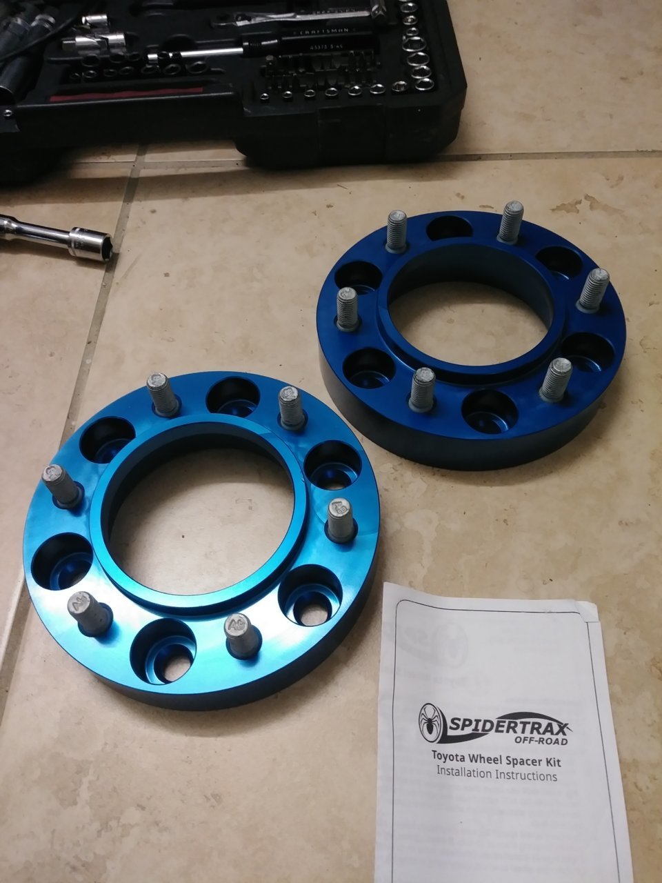

    Spidertrax 1.25
    They come with the red loctite, but I won't use it, I will use the blue one instead that is more easy to remove if I need it... Or should I use the red one???

    Red. Insurance of nothing coming lose > having difficulty removing later
    For all those troublesome nuts and bolts, invest in an electric impact. I have a DeWalt 20V and it's one of the best purchases I have ever made.

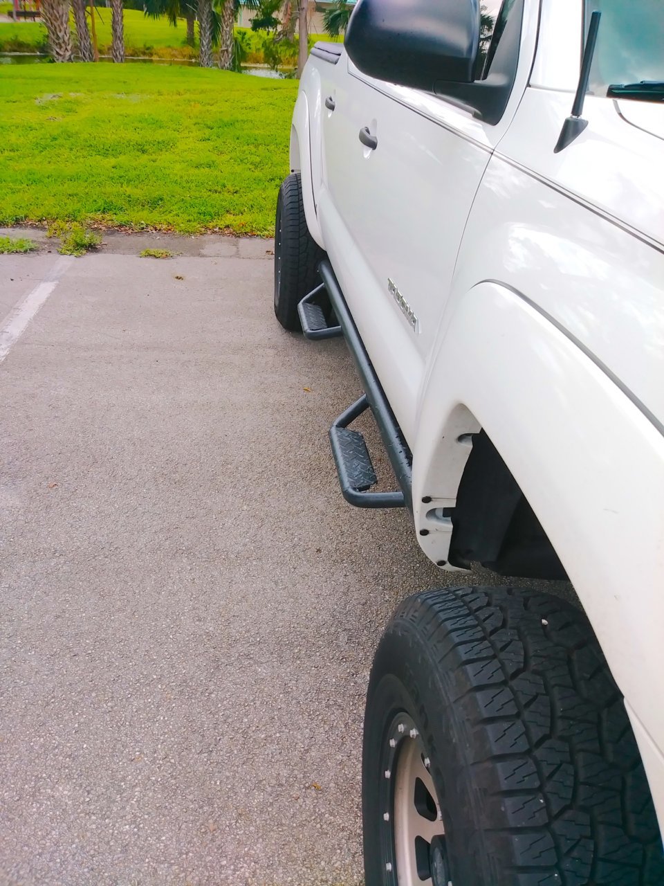

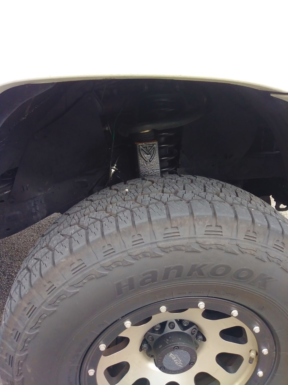

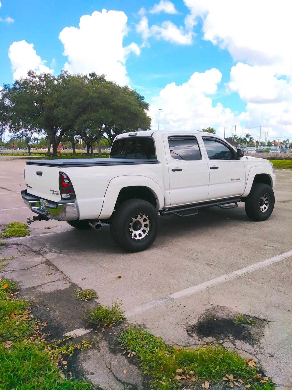

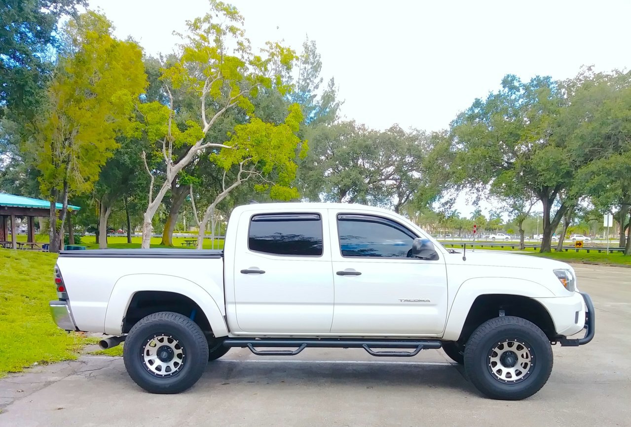

    Ok, guys! Today I installed the rear 1.25 wheel spacer and they were perfect! Still I'm fighting with the front driver wheel noise and the wobbling steering wheel. What I'm going to do is dissemble the front brakes again this weekend, lubricate the calipers and bleed one more time the whole system. Let's see what happen! Here are a few photos of my baby! :)

    Nice!!! Looks awesome!! :woot:
    What shocks and coils are you running again?
    sblspawn[QUOTED] likes this.

    It's got a really sharp stance!
