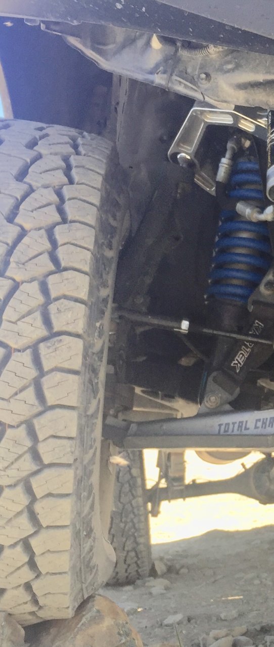

    4.5 backspacing 16 inch wheels and 35s on mine. You’ll be fine. 126CF403-6973-4EDD-BFF4-20948EA82C01.jpg

    WOW! :eek: It's basically eating the whole spindle! 35x12.50??? Not rubbing at all?
