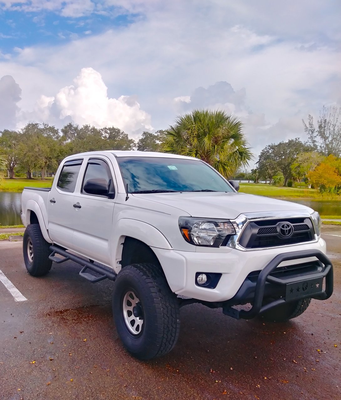

    5100's set @0 with 887 springs and 1.5 AAL. Satoshi Raptor grill, Halo Projector led Spyder headlights and syder taillights, Projector led Halo fog lights by Zack/Taco Nation, LED's everywhere else, Raceline 16x8 Assualt wrapped with Goodyear DuraTracs 285/75/16. Wet Okole seat covers, Paracord headrest handles by Cole/Dessert Dunes, Weather tech floor mats, JVC Arsenal KW-V200BT, 2 10" Kicker shallow mount, Alpine components, Alpine 1000 watt amp, interior is completely Dyna matted
    Good looking truck.
    What did you add to get that xtra inch up front?
  18. Nov 16, 2018 at 6:39 AM
    sblspawn
    sblspawn Well-Known Member
    Apr 24, 2018
    #251505
    1,058
    Thanks, man! I had a set of a 2018 TRD struts with only 200 miles on them hidden in the garage plus a Headstrong 1/4 plate. So I should be now between 5" or 5" 1/4 now. I'm planning to buy Dakars for the rear and use them with maybe a small block to go over 3"
    nach73[QUOTED] likes this.
