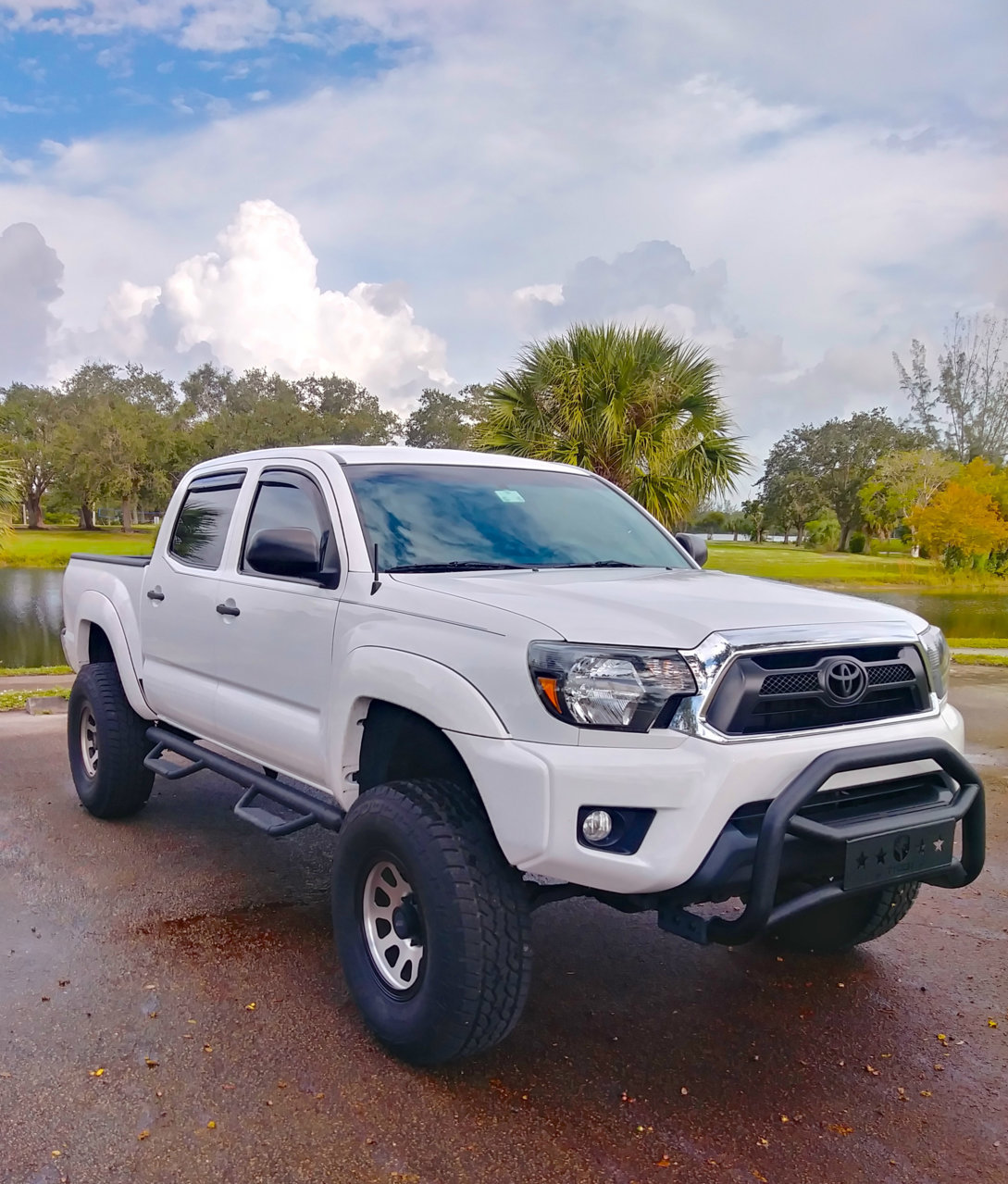

    At that moment I had 4" of the Spindles and 2" in the rear. Yes, those wheels have 4.5 of backspace, but some of the weights of the balancing, rubbed on the Calipers when the wheels was spinning, So I had to grind the calipers a bit and the problem was solved. I had to install wheel spacer on the rear to match the 0.75 of the Spindles. Now I have 5" - 5" 1/4 using 2018 TRD struts, but the front is stiff as fuck. This how the truck looks nowadays.

    The truck looks awesome! Are those 285s? You still have just a 2” block in the rear?

    Yes, they are 285/75r16. Right now I have a 3" block in the rear, but I'm saving for Dakars. They are a bit expensive, so, step by step. :D
