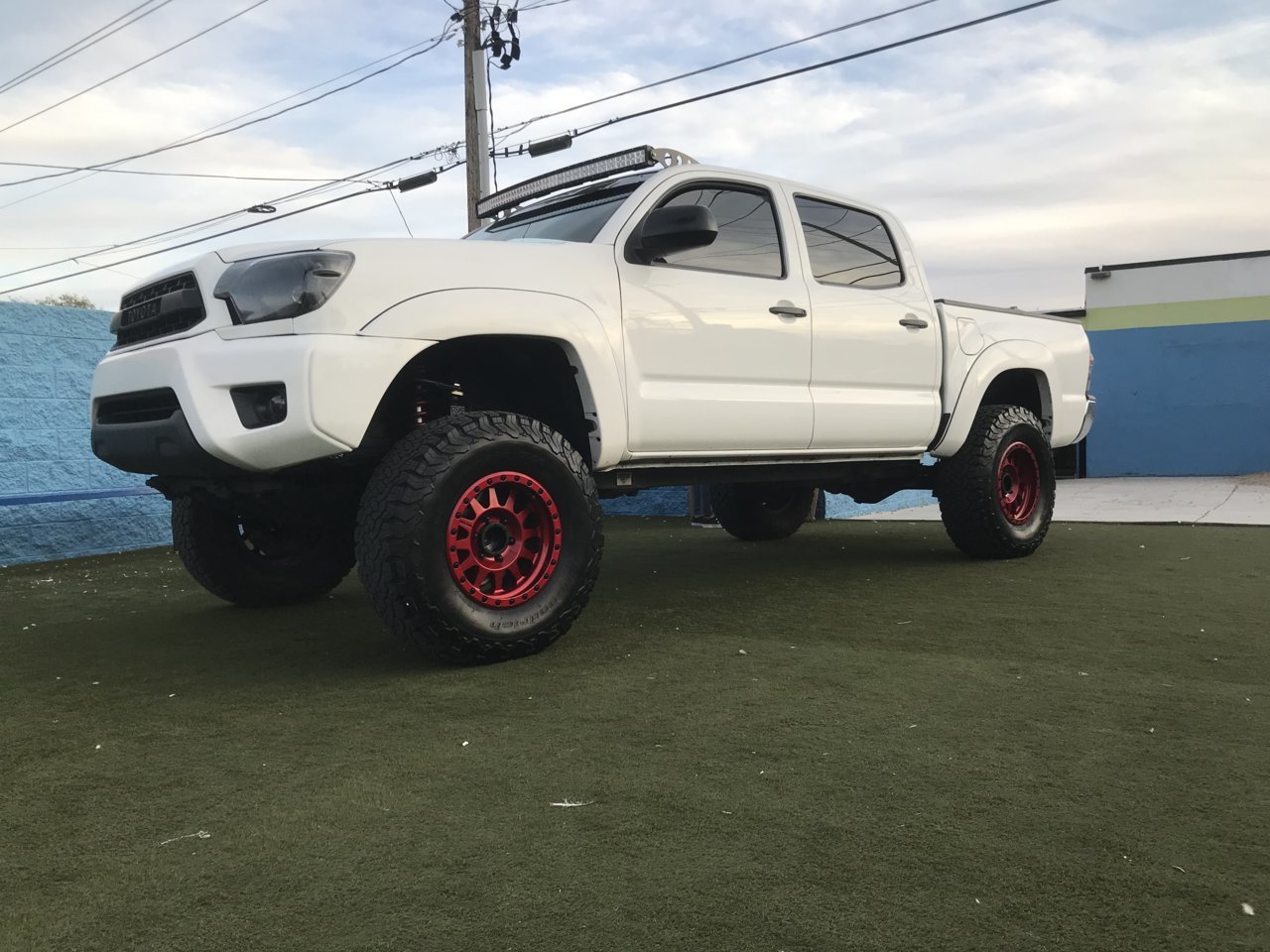

    Hi guys been a while

    Happy thanksgiving bro! Truck is looking puuuuuuuuurty!

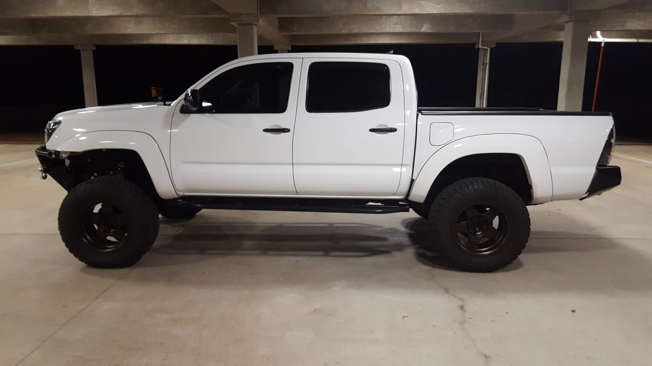

    I need to take some fresh pics
    The front has settled a hair since that one

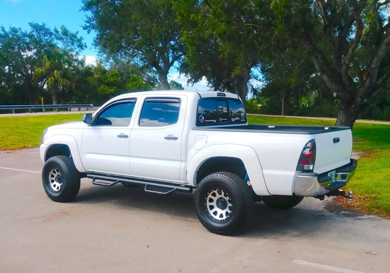

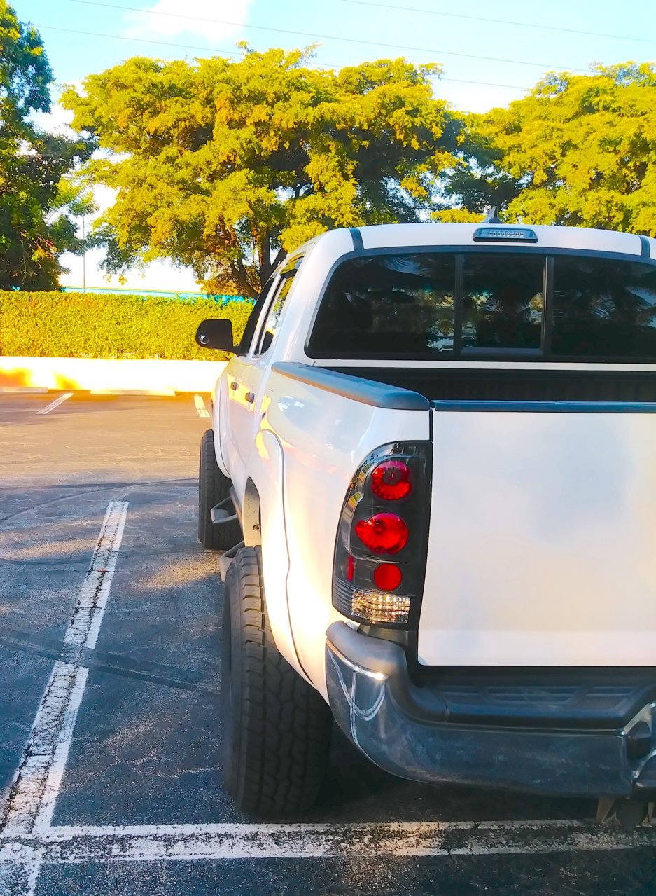

    This is my truck with 285/75r16 on 16x8.5 -6 Offset 4.5 Backspace
    One more thing, the truck is always dirty on the sides. :(

    That's an aggressive stance for -6. Looks good. Spacers?

    1.25 spidertrax on the rear to match the 0.75 of the Maxtrac Spindles. No spacers on the front.

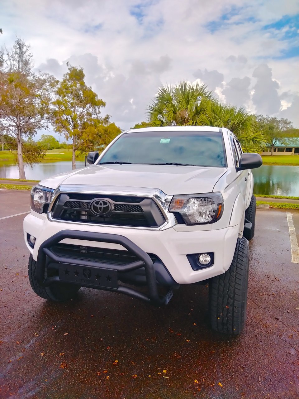

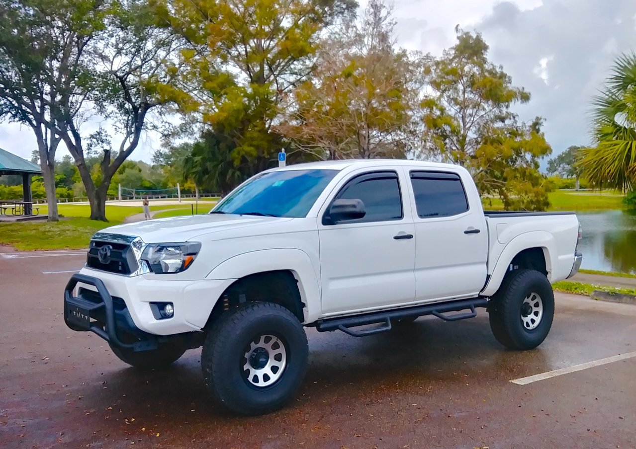

    Here is a photo of the 4 - 2 with 265/75 tires, before the 5 -3 with 285s

    How did you get the 5/3 leaf packs or blocks in the rear

    Blocks! But it's just a temporal lift! I'm saving for OME Dakars. :D

    Those wheels are dope as f@#$!
    Good looking truck as well.
