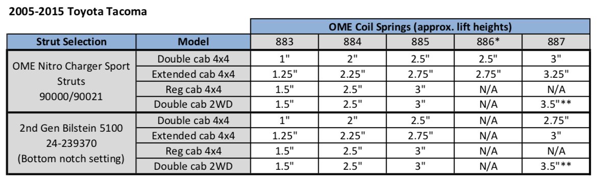

    No, no, I will set the 5100 to 0 (No lift) with the OME 883. The specs says that the 883 lift the Prerunner 1" 1/2.
