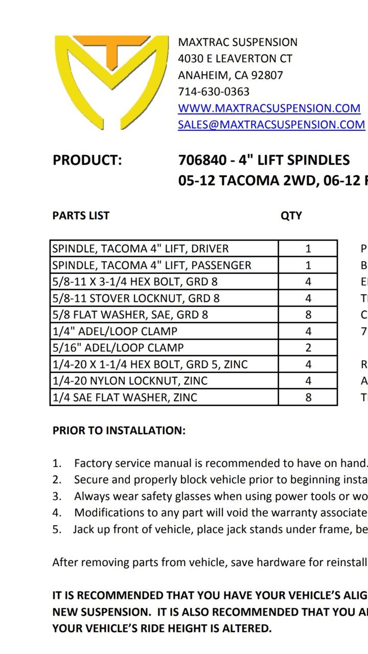

    Question. When you order the spindles, do they come with any hardware or anything? Bought mine second hand and they came bare
    ChadsPride likes this.
  12. Dec 20, 2018 at 7:28 PM
    ChadsPride
    Nov 26, 2014
    #143119
    127,312
    Sponsored by TacomaWorld.com
    Yes. I would PM a vendor on here and get the list. It may have been posted in here before
    Kolunatic likes this.
  13. Dec 20, 2018 at 8:18 PM
    Jimmy92870
    Jimmy92870 Well-Known Member
    Apr 2, 2018
    #249239
    803
    Texas (DFW)
    07 DCSB PreRunner

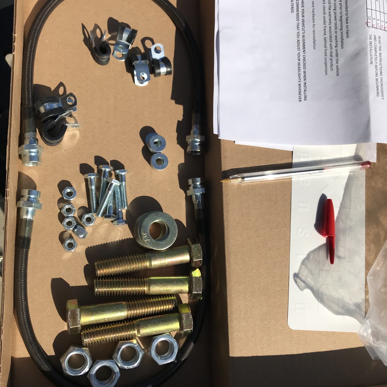

    I'd contact vendors and see if they can sell just the hardware pack to you. I think some people just source the parts at hardware stores. Screenshot_20181220-201616_Drive.jpg
  14. Dec 21, 2018 at 2:08 PM
    Thesandaddict
    Thesandaddict The dude
    Mar 22, 2016
    #182067
    2,768
    Harley
    West Covina, CA
    2010 tundra bro-dozer
    Maxtrac just emailed me this. Looks like I'm headed to the hardware store

    799B885C-1E59-4AA4-B122-94A3FC056629.jpg A7746198-8019-4A55-A3E8-F0A967922864.jpg
    In case you wanted the visual version
