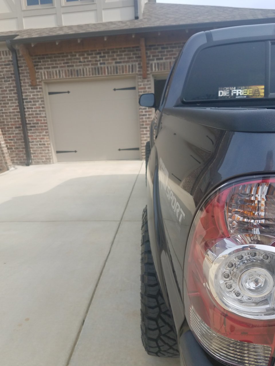

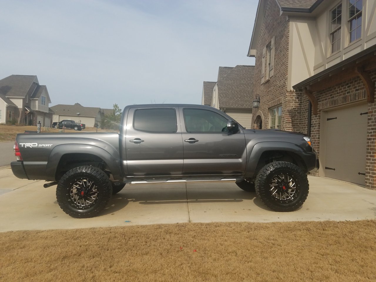

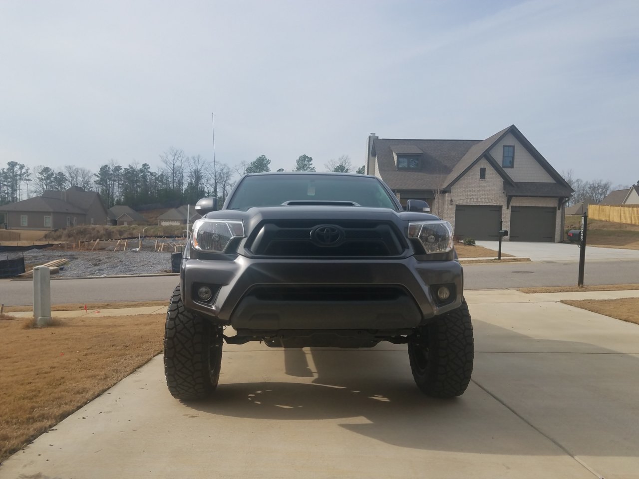

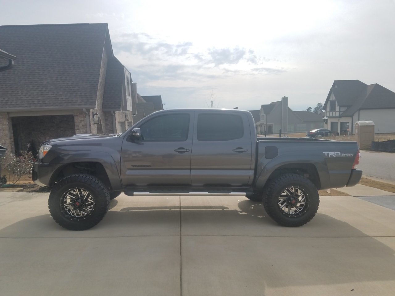

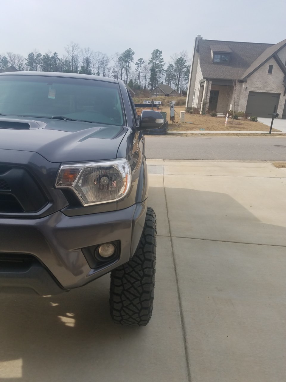

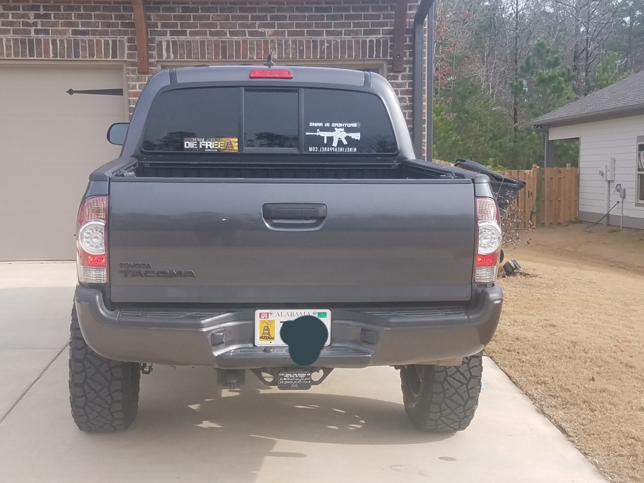

    Got my maxtrac 4" lift on finally trucks on 20x10 and 285/55/20 Toyos. Can anyone tell me what I could use to lift the rear another 2" because I plan on raising the front to 6.5 and I don't want a bro leanIMG_4333.jpg IMG_4335.jpg IMG_4336.jpg
  4. Jan 6, 2019 at 7:39 AM
    ChadsPride
    Nov 26, 2014
    #143119
    127,312
    Sponsored by TacomaWorld.com
    Holy crap your truck is sexy!!! What are you running out back currently?
    I would go ahead and pick up a set of Dakar leaf packs. Can put a small block under there if you need more height.

    Dakars should get another 2.5" or so

    All I've got is some 2inch blocks in the rear that came with the maxtrac kit

    Could I stack the dakars with these 2" blocks I'm already running?

    For sure. But check out alcan leaf packs. They can custom make you a set to your desired height.

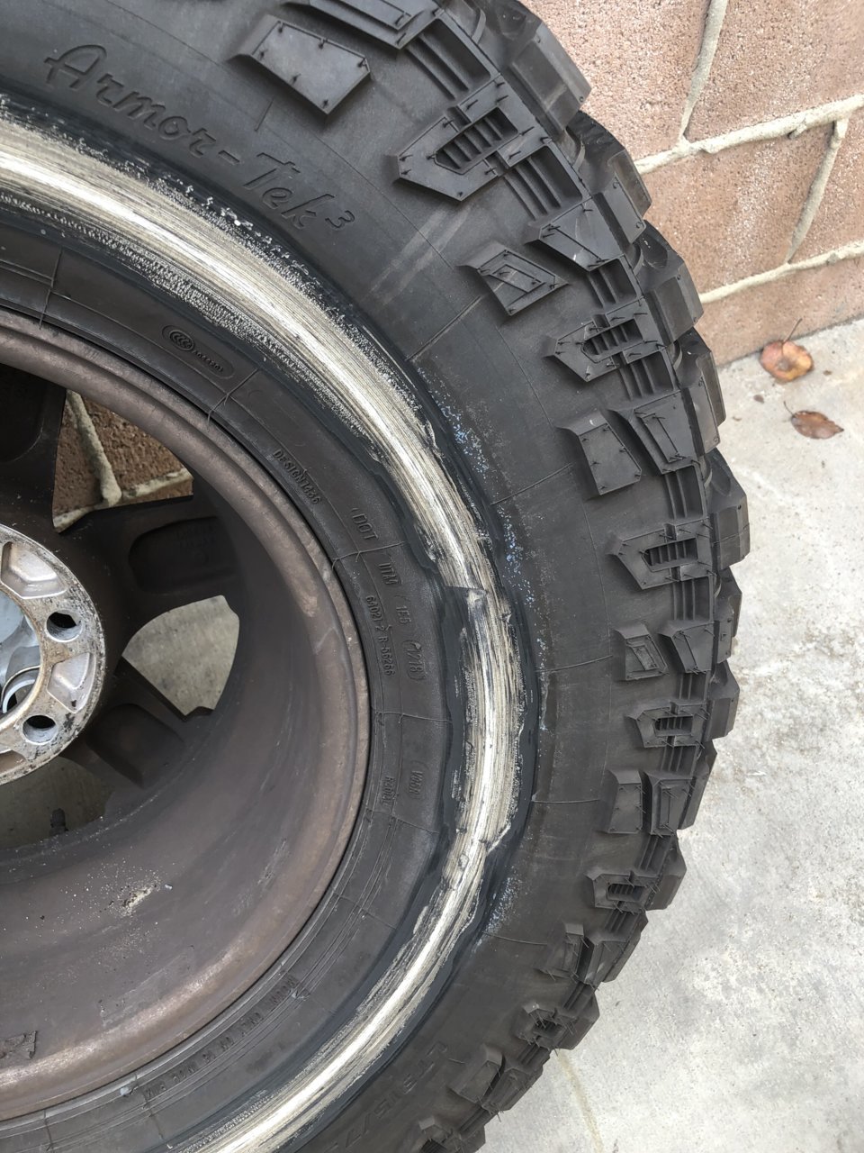

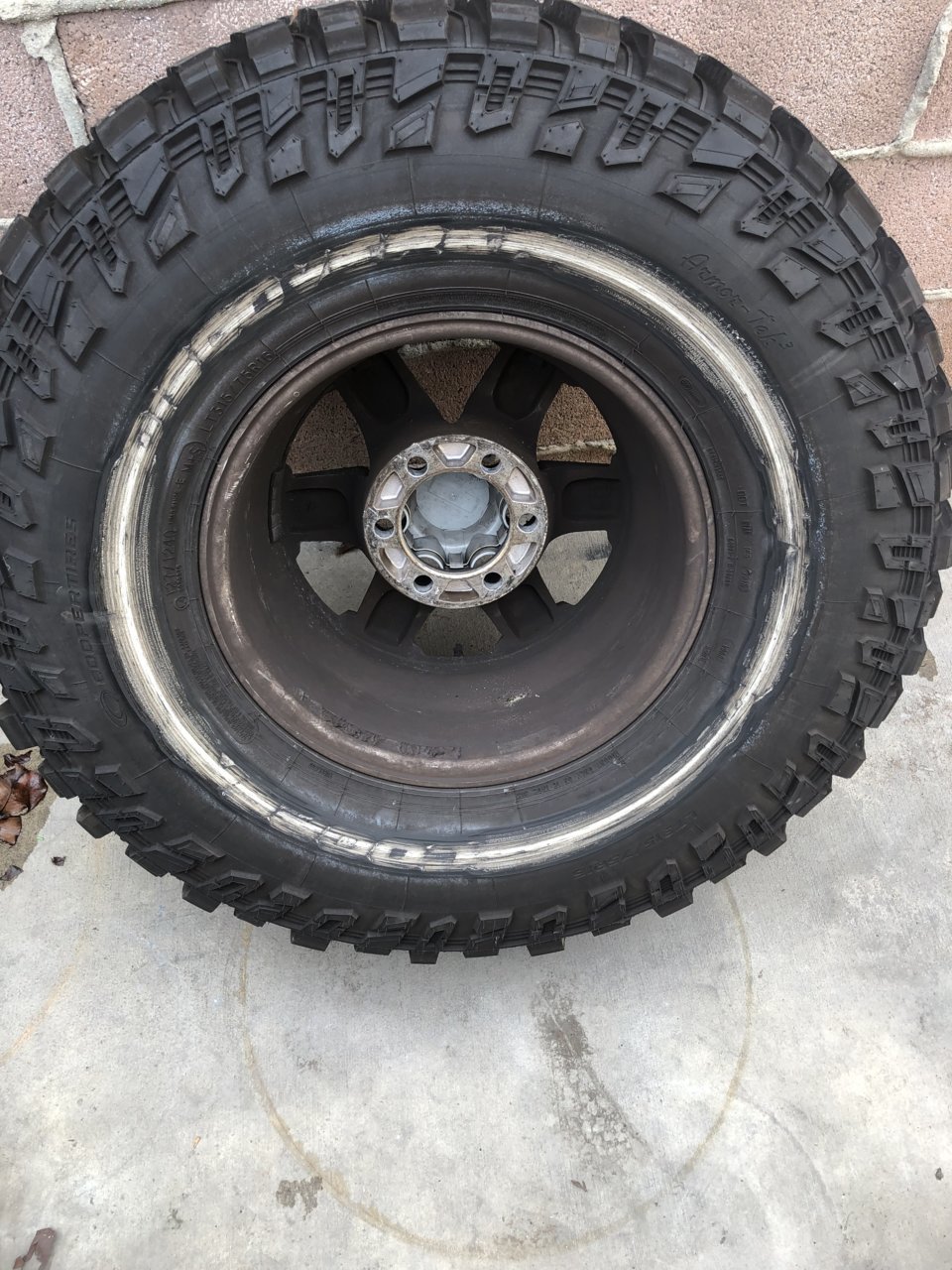

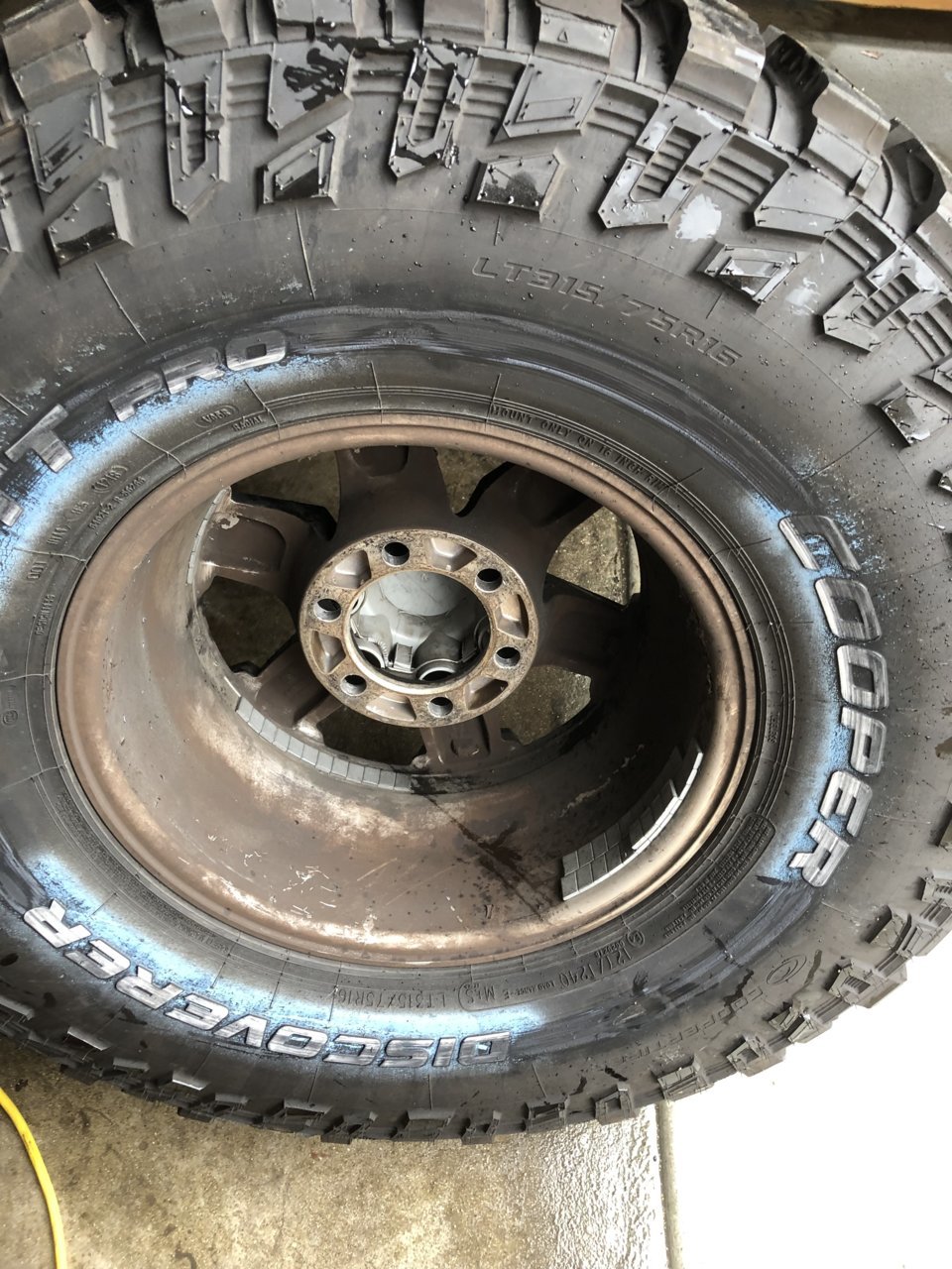

    I have to put a disclaimer here before I said it was fine @285/75/16 : going up to 315/75/16 I would suggest wheel spacers . These tires only have 5k miles on them.
    B1C9BB85-9017-4908-BA2B-7FA3CBD27015.jpgD30C7939-FE9B-446C-816A-7A5665C81206.jpg This was the wheel I rotated to the back after 5k miles .
    This wheel was rotated to the front , this happen after 60 -100 miles , after I got the tires rotated and wheel alignment.
    The shop never told me my inside sidewalls was scraping. Just said my tie rod was bad . I only found out when I went to replace my tie rod .
    ChadsPride likes this.
  20. Jan 18, 2019 at 3:21 PM
    ChadsPride
    Nov 26, 2014
    #143119
    127,312
    Holy crap, what upper arms were you running?
