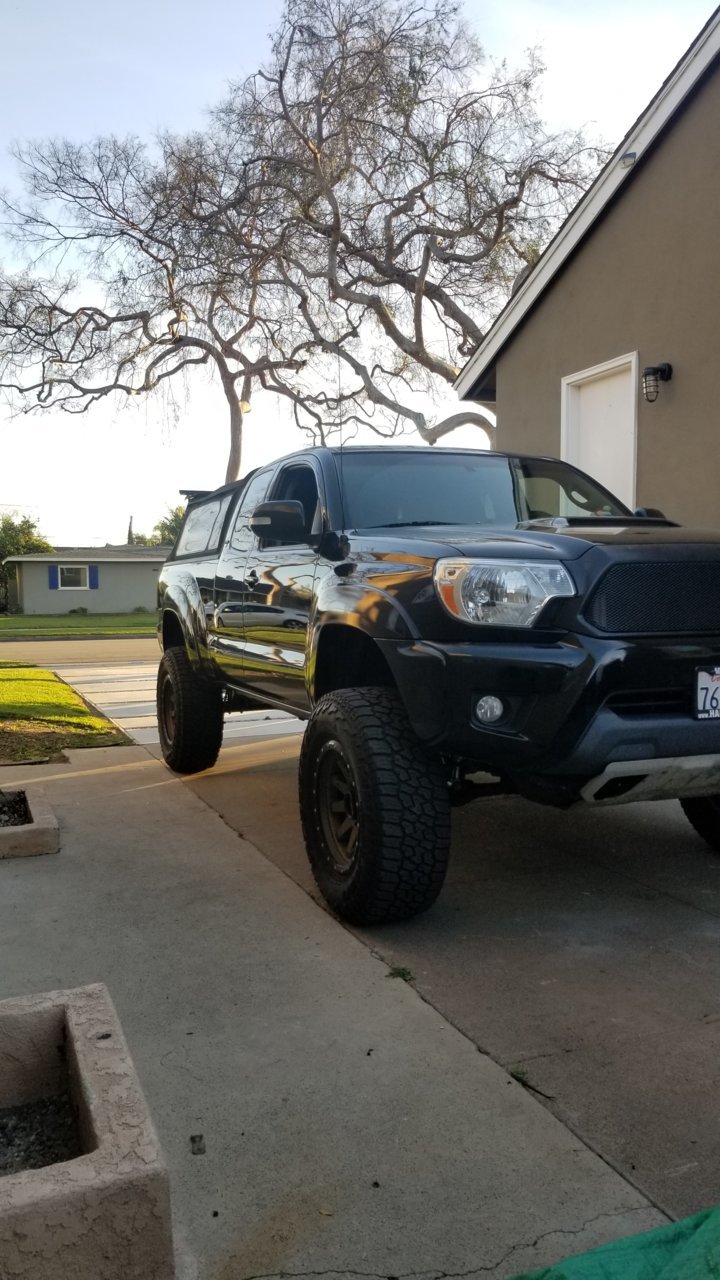

    20190127_163238.jpg Alright thanks guys it's all in I'll make a CB drop at work and I guess I gotta get my vac reset but any idea how? Besides jumping the obd2?

    Tires rubing anywhere? Rack and pinion bushings worn out?

    Nope tires clear everything fine. 90k on the truck and it didnt make noise yesterday so I'm assuming its install related

    Have you checked the torque on everything? Lca, uca, ball joints. Sometimes those alignment guys dont torque things back to spec

    Yes. I think I got it. Uca bushings were bone dry lol. Took a full tube for both. It went away in the driveway I'll check again tomorrow
