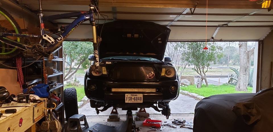

    So I couldn't wait and i did my lift yesterday... took all day but i finished it. Ill takes pics of the results when i get a chance to clean my truck. my tuck no longer fits in my garage lol.

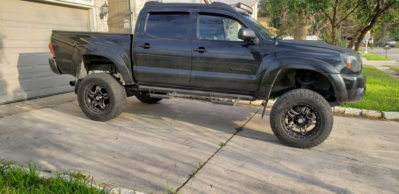

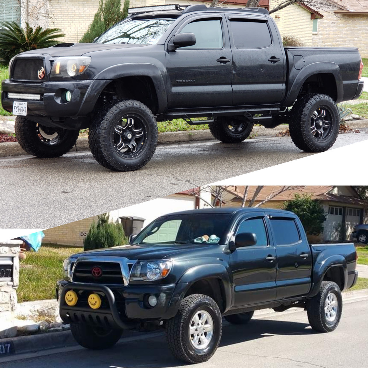

    Some shots after I got the alignment done after work... thank God for Mexican shops that work on Sunday. FYI don't drive your truck without an alignment and all that stuff.. it's scary AF.. also had some face casualties

    Your truck looks freakin awesome, sorry bout the face!
    Lol, my truck way scrubbing pretty bad tire on pavement just after the spindle lift before alignment.
    Smooth as butter now
    RexsTaco[QUOTED] likes this.

    Yeah I could hear the tires squeal when I turned lol
    No the plate for the U Joint flew at my face while I was trying to put it on lol... it’s tot worth the pain lol
    Thank brotha my truck is getting better and better slowly

    Looks wicked brotha. How much lift you running?

    Thanks brotha, the numbers say 7 in front and 6.5 in the rear. But in reality it’s probably settled to 6.5 in front and 6 in the rear

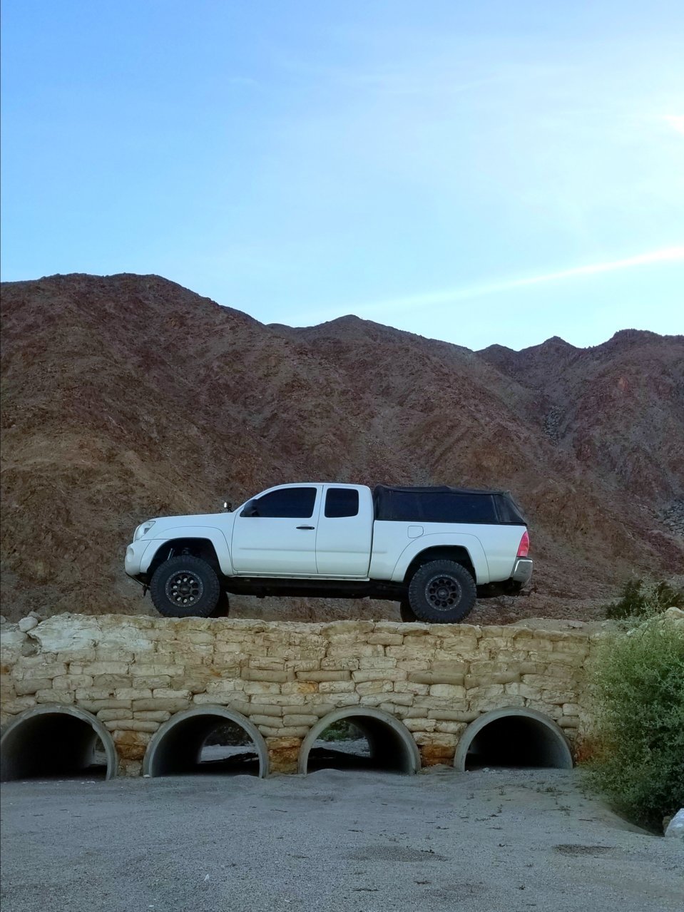

    Pic from Superstition a few weeks ago. Front is looking great! :militarypress:
    But....the AllPro leafs have settled over a few years & now my rear tires are trying to rip the bedsides off. Could install an AAL but that would require new shocks. So instead of dipping my toe I'm just going head first down the rabbit hole:
    -sell the +2.5" Icon remote resi
    -new BAMF leaf hangers & shackles (5/8" lift, + ~4" droop)
    -new 4* axle shims (~3/8" lift)
    -new BAMF shock towers
    -new King 2.5x14" smooth body remote resi
