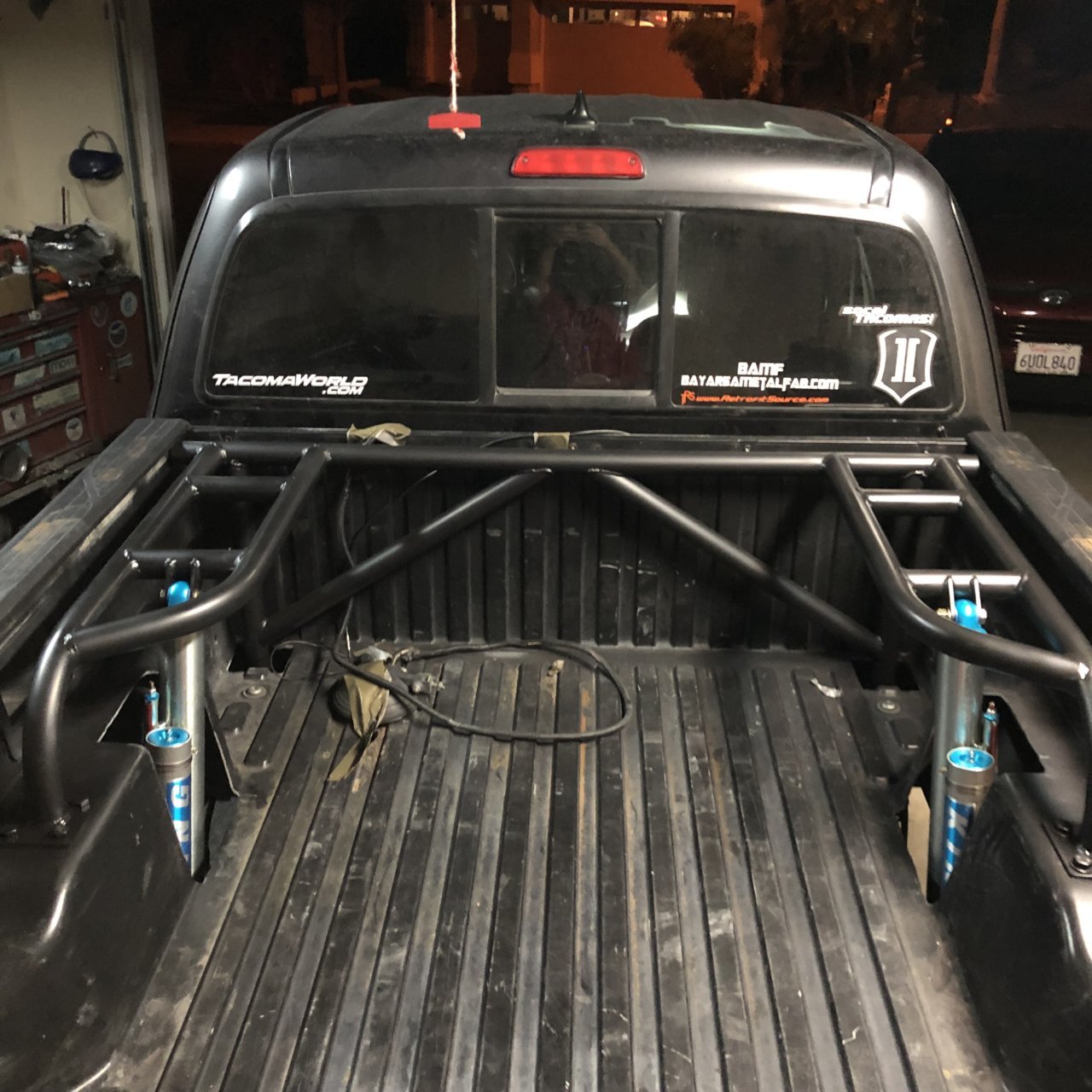

    Yup..Garage Fab by me and @Yotamac

    Thanks...appreciate you visiting. There are a ton more photos on my Flickr account if you are interested. I dump all my pics there unedited. https://www.flickr.com/photos/19843514@N03/
