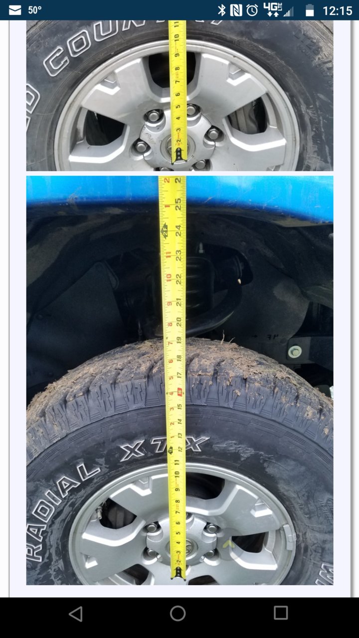

    This guy using the same wheel I have he has maxtrac spindles but is he using a spacer or not Screenshot_20190306-121532.jpg

    What is your measurment supposed to show, if you are running 16” you need wheel spacers or choose to just grind up components and risk catastrophic failure accident and possibly death.

    No my question is what backspacing is required for proper clearance of those spindles

    I currently have those wheels if he has them on with maxtrac spindles is he using a spacer or not

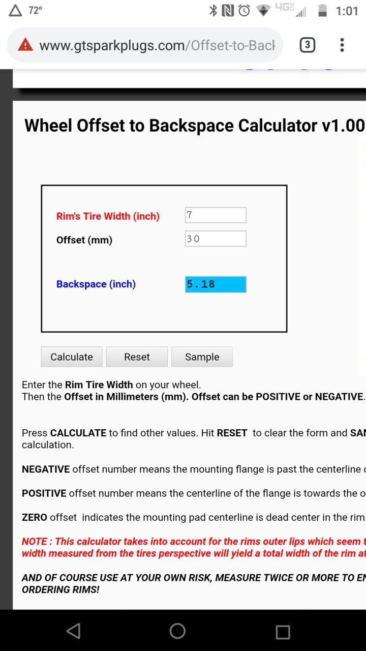

    This is what I found on factory 16x7 trd wheelScreenshot_20190309-010144.jpg

    Most likely it’s 1.25”.

    @05prerun82 next time you have the wheel of, lay it facing down (you'd be looking at the back of the rim). Lay a straight edge across the lip of the rim and measure from the bottom of the straight edge to the mounting surface of the wheel that the hub touches. that will be your backspacing.
    Id does sound like that example you found, he has to be running spacers. If you go with 1.25" spacer, that will mean you are 2" wider per side (4" wider on your whole track width).

    The factory 16 is at 5.5 backspacing
