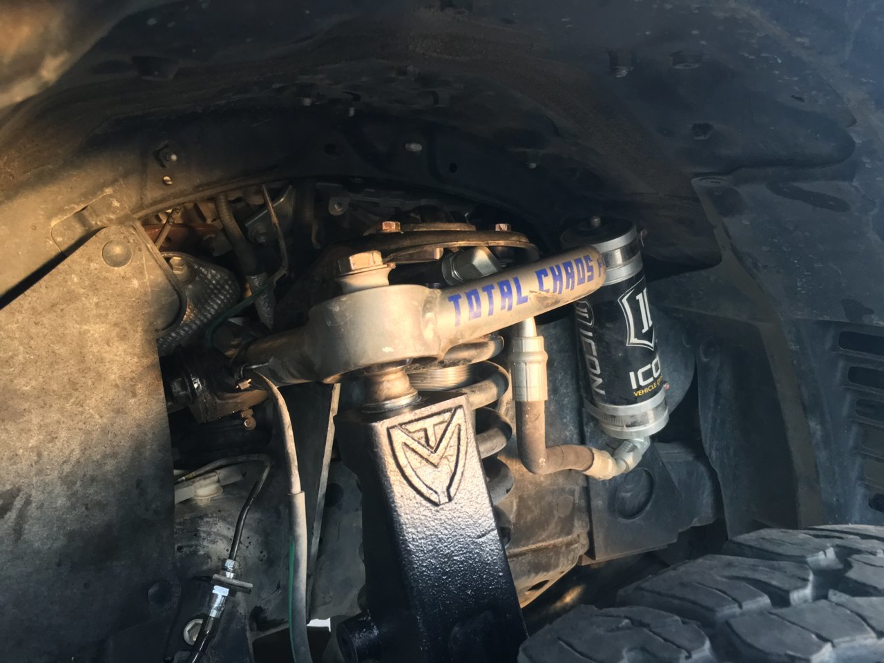

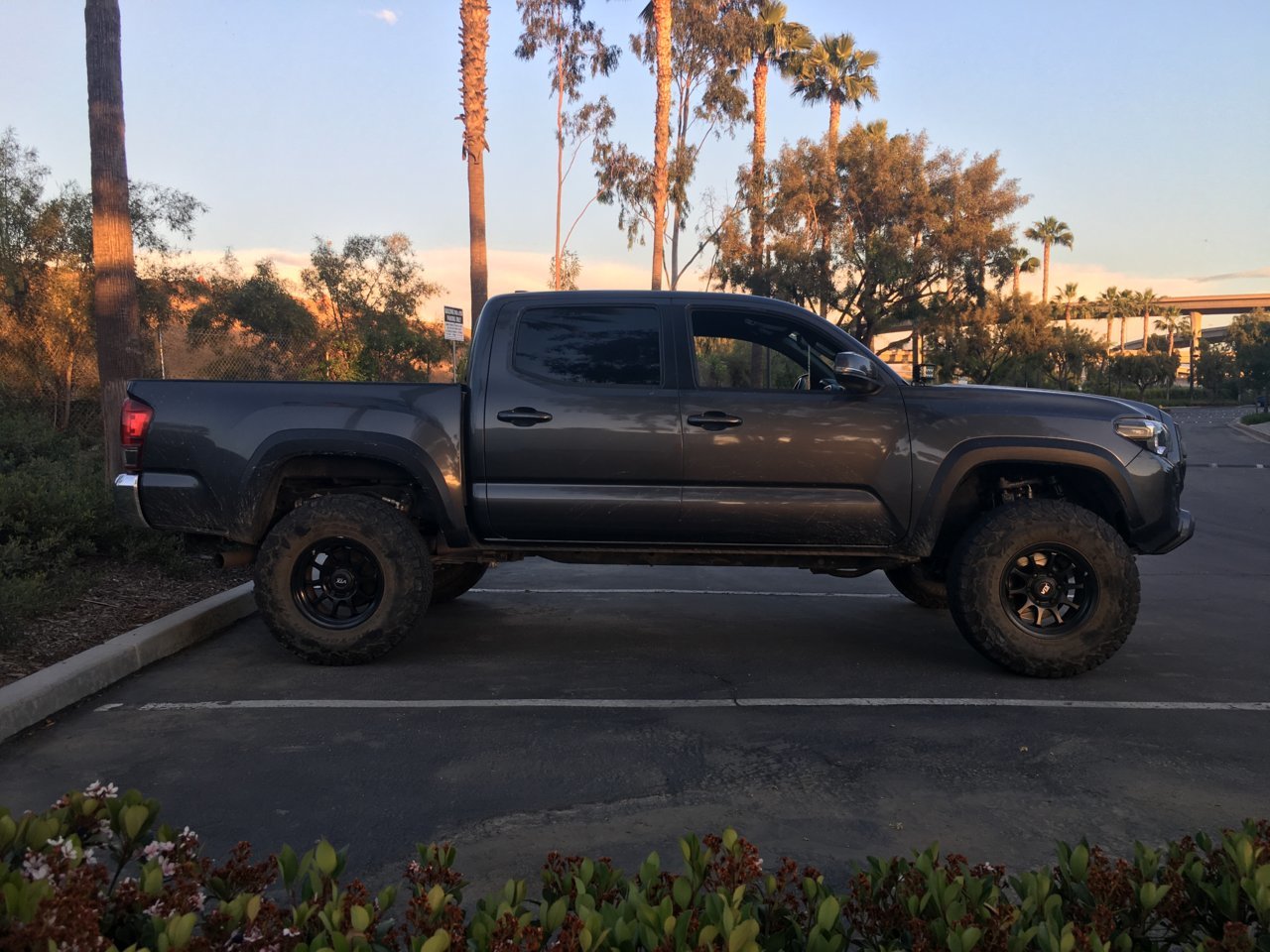

    Some work i did on my buddies rig, Enjoy!
    IG: @Yotaceez_: So my good buddy decided to finally upgrade his spindles so that he wouldnt have to deal with the old ones giving out since we all know without gussets they have a chance of bending if wheeling hard enough. Was close to slapping on some OME Dakars but since we settled for no preload in the front since he already achieved 4" just from the spindles so we opted to keep his AAL. Parts were all provided by @HeadStrong Off-Road as always, best pit stop shop to get components.

    Do you paint all the surfaces? any surface you don't want to paint?
    ChadsPride[QUOTED] and Biscuits like this.
  11. May 18, 2019 at 10:04 PM
    dumontrider
    dumontrider Well-Known Member
    Jan 26, 2012
    #71464
    3,047
    Jason
    La Habra, CA
    14 GX460
    Don't paint the bearing recess, otherwise have at it!

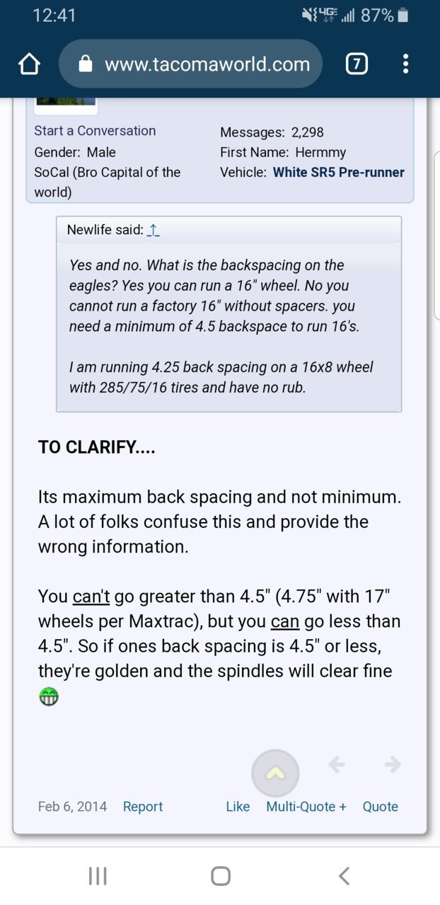

    I'm interested in Maxtrac Spindle 4inch lift.
    I have bilstein 5100s set at 0 with OME 888 coils and Dirt King Uppers. I have SCS SR8s 16x8 with a -12 offset. BS is at 4. Will my wheels clear maxtrac spindles?
    ChadsPride likes this.
  16. May 21, 2019 at 12:11 PM
    Addicted2Pomade
    Addicted2Pomade Well-Known Member
    Jun 1, 2016
    #188493
    178
    Eddie
    Socal
    2010 Super White Tacoma Long travel
    I believe those have a backspacing of 4.00 . For 16s anything 4.5 and under should clear. So you're good .
