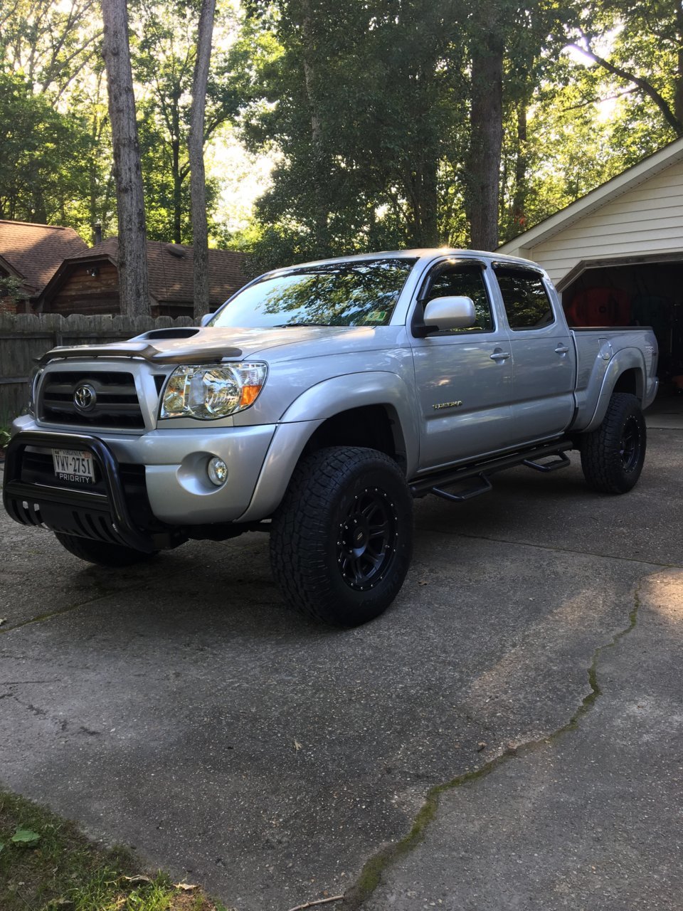

  18. May 27, 2019 at 3:44 PM
    K-DubTaco
    K-DubTaco Well-Known Member
    Nov 18, 2018
    #273060
    569
    Ken
    VB
    ‘25 TRD Off Road
    Finally got the new tires this weekend. Now the stance looks right.
  19. May 27, 2019 at 3:59 PM
    ChadsPride
    Nov 26, 2014
    #143119
    127,312
    Sponsored by TacomaWorld.com
    I dig it! What size
  20. May 27, 2019 at 4:10 PM
    K-DubTaco
    Nov 18, 2018
    #273060
    569
    Ken
    VB
    ‘25 TRD Off Road
    285/70r17 with 4” spindles and 2” block
