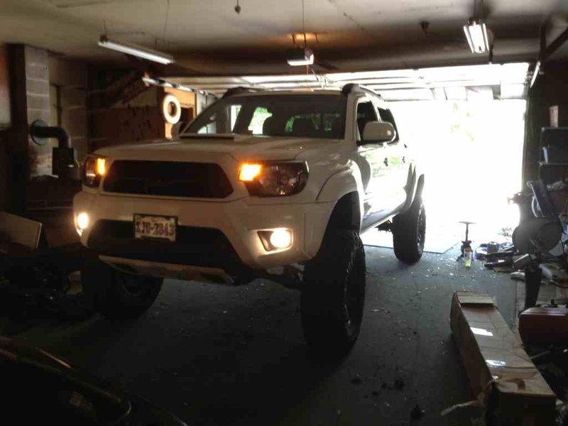

    Spidertraxx 1.25" spacers in front and rear, 4" Maxtrac Spindles,Billy 5100s at 0", OME 885 Springs, 1/4" top spacer on both sides, 1.5" AAL, 3" Block, 1.5" 4crawler driveshaft spacer, 17x9 XD Spys with 35x12.50 Nitto Mud Grapplers, Magnaflow offroad Stainless Exhaust, Volant Intake with scoop,Camo emblems, BHLM, Tinted tailights, Anytime fog mod,Alpine Type R 12, Kicker 1000 watt amp,600 watt 4 channel memphis and all memphis components, 35%tint front all the rest at 5%, Hella 500s with sylvania zxe bulbs, sylvania zxe headlights, sylvania zxe fogs, Weathertech digi fits, flyzeye blue/white, LED map dome license plate lights, Redline hood struts, Tailgate EZ Down, Custom TRD Camo Browning Edition Bedsides, Camo wet okoles, Ridgid Dually bed lights, SOS Concepts Tire Carrier
    Still fits in garage!!

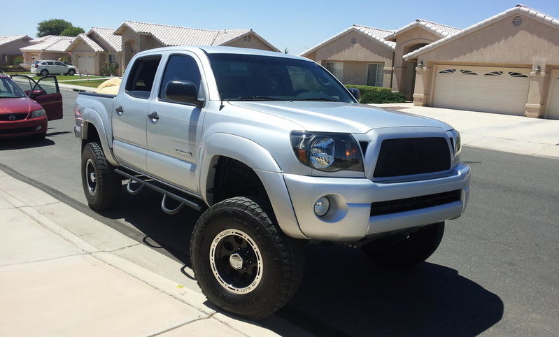

    What rims are you running?
  14. Jul 27, 2012 at 1:37 PM
    #1294
    markmatters
    markmatters [OP] Viejon
    Nov 4, 2011
    #66436
    1,311
    Mark
    Yuma, AZ
    2007 PreRunner
    These:

    Ion alloy...theyre 108mm hub bore...so youll need hub rings...108 to 106mm....bs os 3.75...and for some reason will not clear the caliper...thats when i changed the spidertrax from rear to front...they finally work...i love these wheels...
