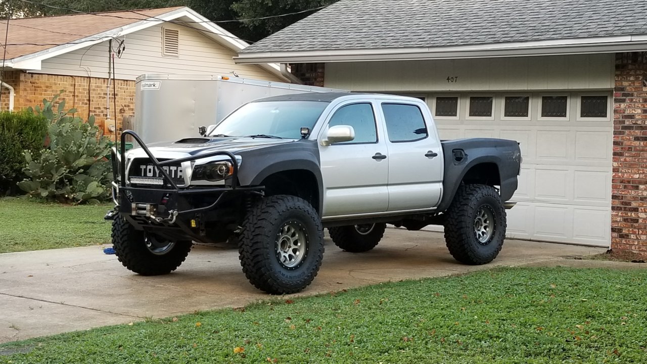

    it's been awhile since I last posted in here lol, recently tried on some 15x8s with 35x12.50s and they fit pretty good. Sadly have to remove them here soon since these are the wheels/tires for my project truck haha. But I was surprised I was able to clear 15s with the spindles and 2" spacers

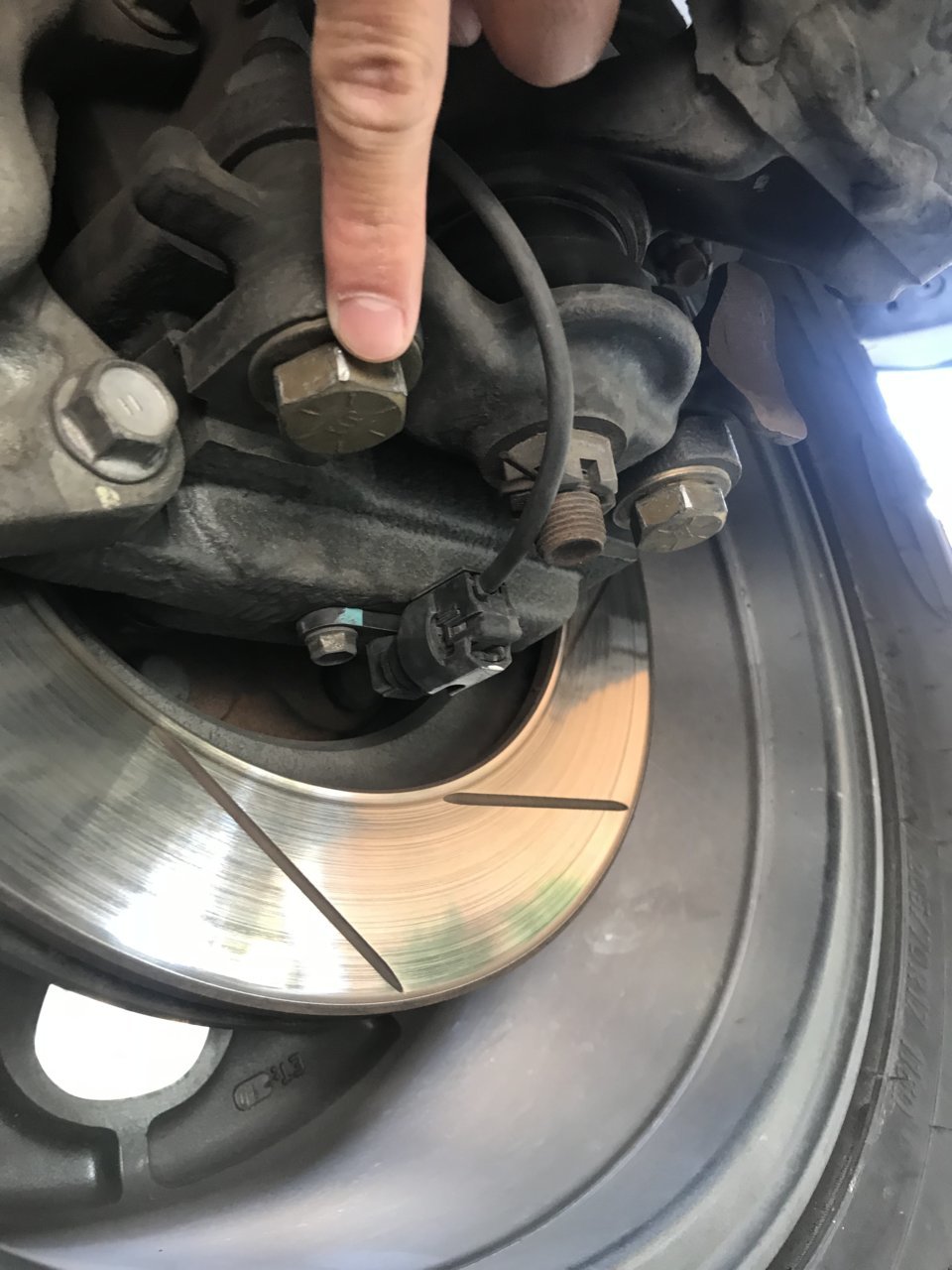

    2015 Blue Ribbon Metallic TRD Off Road double cab short bed
    are the two bolts pictured causing the clunking sound some people are hearing cause I’m getting a clunking sound A443615B-D940-40E9-B06D-465E9E29CBBF.jpg

    Yes. Did you torque them to 112-119ft lbs? That’s what they call for. Mine was clunking and shaking and it all quit after I torqued them.

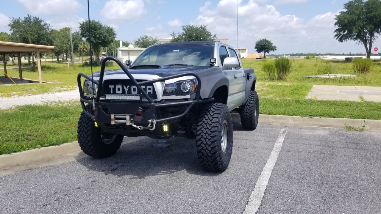

    minus the whole scrubbing at 3/4 lock and the lugs trying to rip my fender off in reverse...these things are awesome! I just need to get my caster pushed forwards lmao

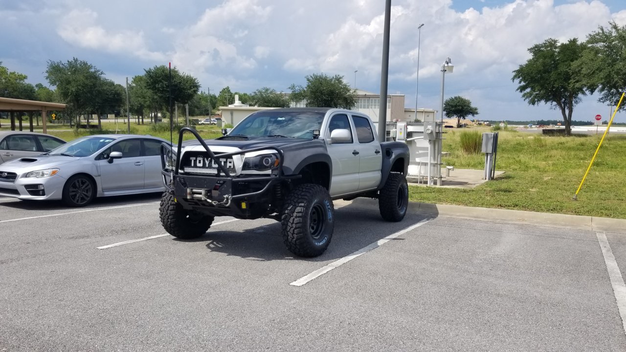

  20. Sep 4, 2019 at 5:16 PM
    Alfuh
    Alfuh It's pronounced alpha
    Aug 21, 2013
    #110878
    6,786
    Bismarck, North Dakota
    2006 Prerunner
    I have a few mods

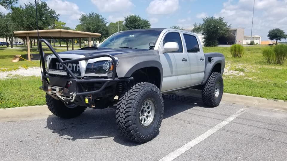

    haha, yeah I forgot to add those lmao, also a. better sideish shot of the poke. I think these poke out a tad more than my last wheels. But they are a set of 17x8.5 SCS Ray10s in Matte Grey with a set of 37x12.50r17 Toyo MTs
