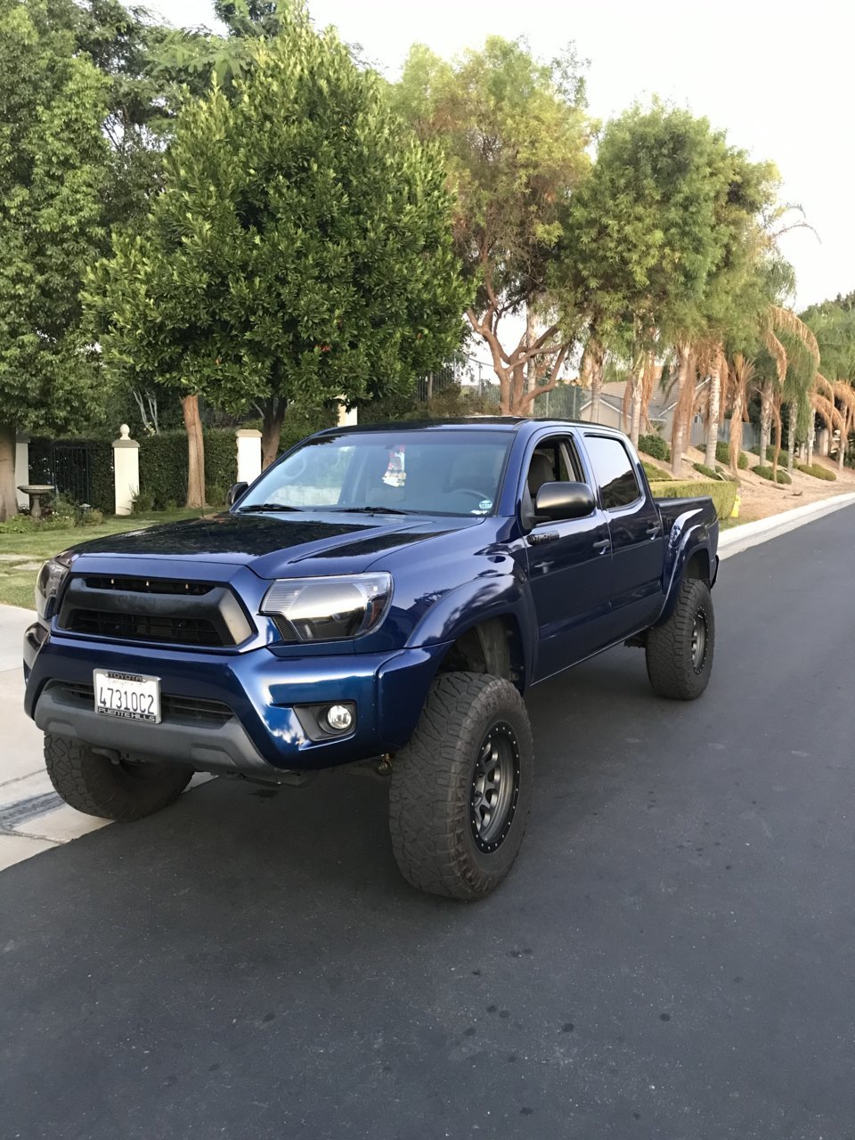

    Seks
  11. Oct 14, 2019 at 12:46 PM
    K-DubTaco
    K-DubTaco Well-Known Member
    Nov 18, 2018
    #273060
    569
    Ken
    VB
    ‘25 TRD Off Road
    That’s a sweet looking truck!

    Thanks man.
  13. Oct 15, 2019 at 3:52 PM
    TheBlueBeast15
    TheBlueBeast15 Well-Known Member
    Apr 28, 2017
    #217612
    819
    Kevin
    H-Town
    2015 Blue Ribbon Metallic TRD Off Road double cab short bed
    Thanks chad. You and a lot of other members in this thread helped me out.
