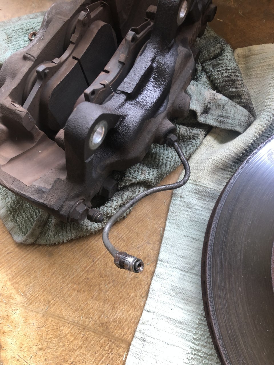

    Having a hard time removing the bottom brake line from the hard line on drivers side. The bolt seems to be all the way out but keeps spinning. Tried prying it but it’s still in there pretty tight
    edit: after hammering with a vice grip we got it out but the bottom of the bolt was flared out so now we can’t get the new brake line over it

    So this metal line that connects the brake line to the caliper is what we’re having trouble with. The end of the threading is flared so the brake line won’t even go over into the threading.

    I know it's too late now but I'm fairly sure you can probably get a replacement at a local auto parts store like auto zone or O'Reilly or pep boys tomorrow. Plug up the line so you don't empty out your brake fluid.

    Yeah, we had grabbed one but we have to cut it ourselves.

    Update: Finished front end, took about 8ish hours for two of us to do with breaks in-between. Main problem we had was the stripping/flare of the hard line bolt that connects to the calipers. Had to buy a new one from oreillys and cut and bend it to shape. Going to finish rear tomorrow, bleed brakes, and get an alignment. Will update with pics tomorrow when finished.

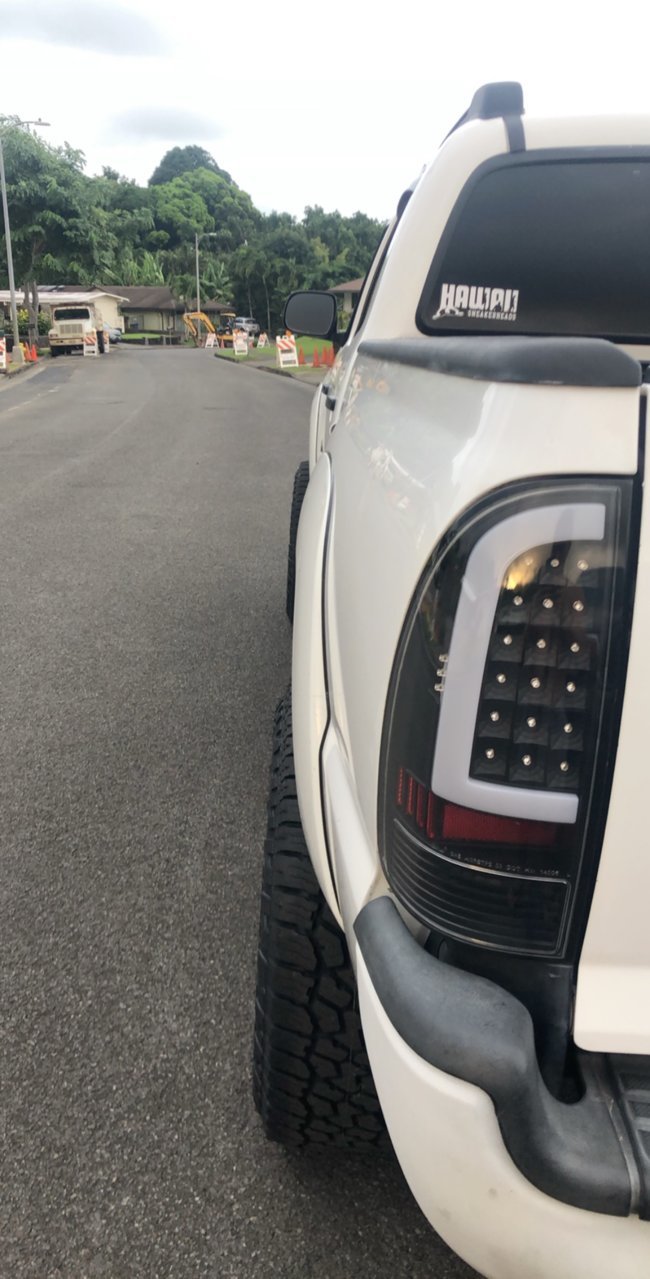

    0EA082EB-AD75-4AE3-BF48-F479372D1247.jpg 6C43E6CC-93B1-4001-A0C0-AADE81D5A83F.jpg A98F49D3-BD7C-4F43-9F93-12A4225AC02F.jpg F97CB028-ADDF-4D90-8674-C3957BFA1CEB.jpg

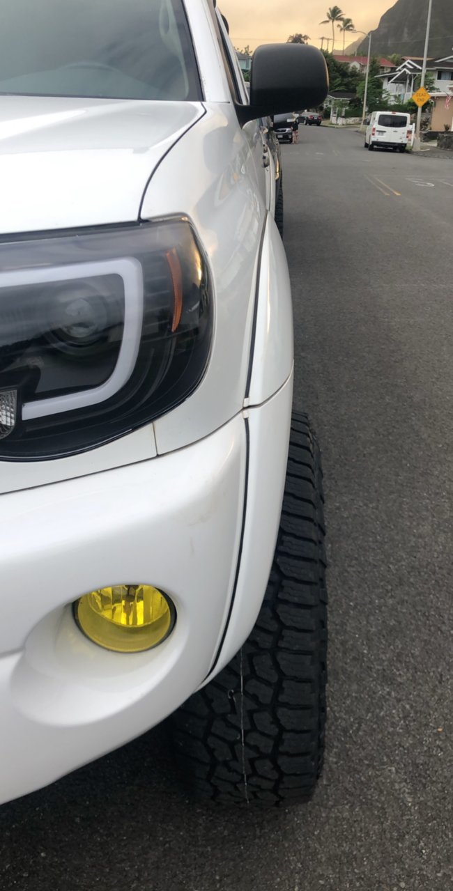

    Ended up not running spacers in the rear so i’m less likely to get pulled over for tires sticking past the fender from a cop behind me. Still pokes at 285/70/17 on a 4.5 backspacing wheel.
    Tire is rubbing at full lock, any suggestions on how to cut/heat gun the fender out of the way?

    Looks nice man. And probably just a box cutter blade to the corners of the fender flare.

    Wait till alignment is completed and then you may have to trim the bottom of the fender a little.

    We ended up cutting the bottom of the fender and the entire cone shaped rain guard.
