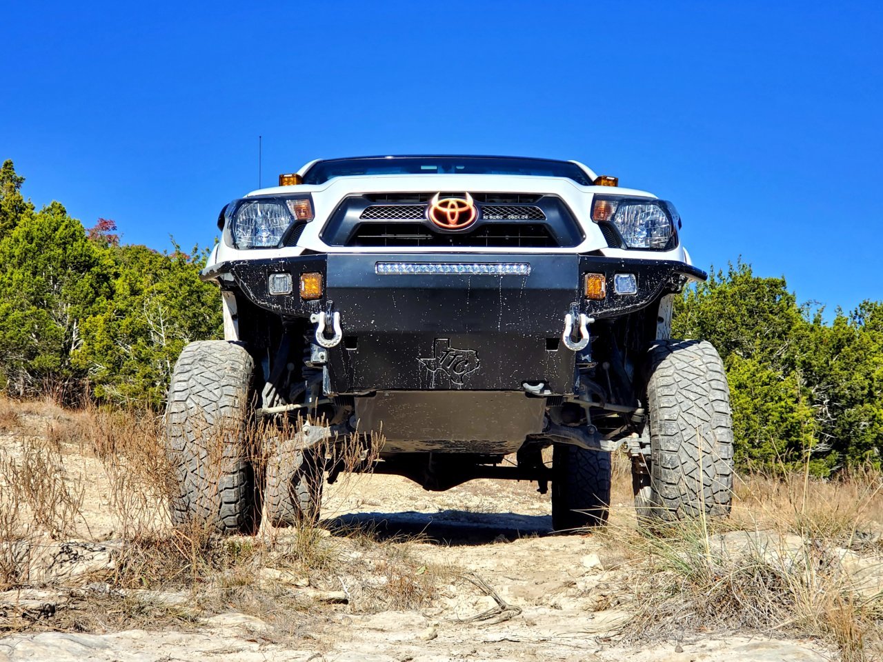

  20. Dec 9, 2019 at 1:09 PM
    sblspawn
    sblspawn Well-Known Member
    Apr 24, 2018
    #251505
    1,067
    Look great, man! Do you have any photo from the side view?
