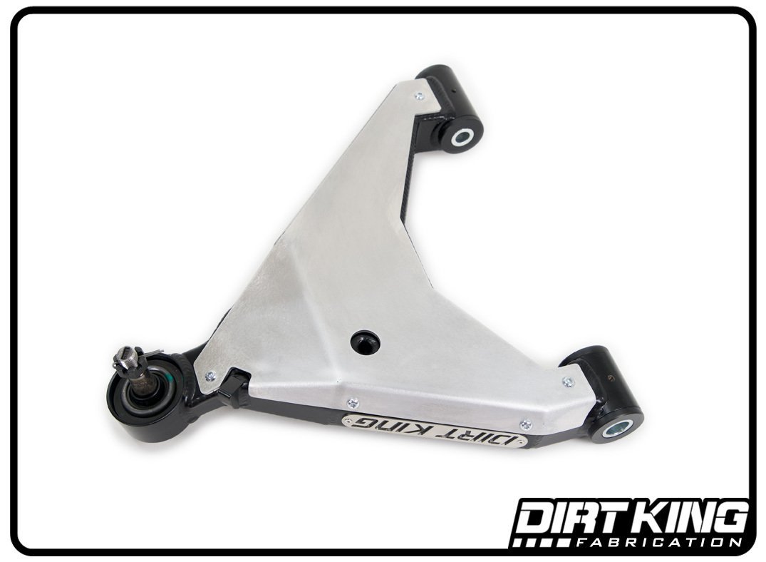

    Hey did you ever find out if you can make the LSK stock LCA work with the Maxtrac spindles?

    Diggin deep back in the archive but was their a reason you went with TC LCAs and not the LSK LCAs? Was LSK not able to fab something up to make their LCA work with the maxtrac spindles?

    LSK didnt make stock length LCA's at the time.....plus LCA's were just a dream at this time in my build but these TC LCA's popped up for 600 bucks and who can turn down a smokin deal like that. I made spacers to make the TC arms work with the maxtrac spindles.

    Haha yeah Iv read through every page and post of this thread as I saved up for my lift and remembered reading that you were able to fab up some spacers to make TC LCAs work. And yeah for $600 bucks that’s a steal. And I’m much in the same boat as you were LCAs are pretty much a dream right now. LSK now does make a stock length LCA but it has some sort of uniball spindle adapter that I think the TC LCAs don’t have. https://www.lsksuspension.com/product-page/05-tacoma-lower-control-arms-lsk1140 but the Dirt King LCA looks similar to the TC LCAs maybe you spacers will work with these.upload_2019-12-22_20-0-57.jpg

    @TheBlueBeast15 @Airdog yes. I was able to get in contact with Ryan @ LSK. It appears we need to take about .2145 inches off the top of the lower uniball bracket. I have the LCA's in hand. I told Ryan I would have some SLA'd brackets made for a fit check and then shipped to him. I mentioned the possibility of some folks on here being interested. He said he'd consider offering them as an option. If your impatient, you could always take a belt sander to the top of the bracket. You don't want to remove material from the bottom side of the bracket. He also didn't have concerns about the lower coilovers eyelet being ~.2145 inches higher as a result of the modification
    ...please ask me for ETA's...to keep me in check and get this done...haha

    Oh dang that sounds great. Thanks for trying to dial those in to work with the Maxtrac spindles. But as of right now I probably won’t get new LCAs until the next BFS they have. But keep us posted on here I’m sure other people are interested as well.
