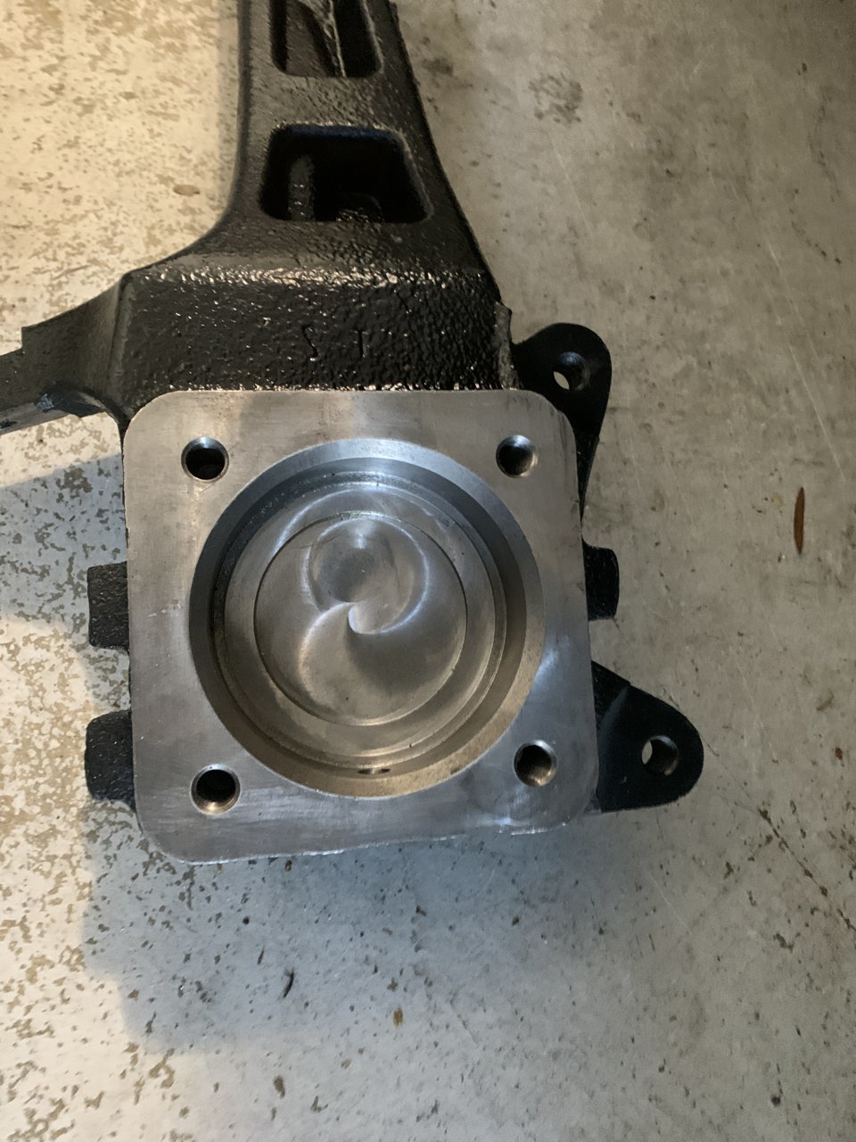

    Do anyone know what kind of grease go in there and also is there a gasket for it also? The stock spindle have a gasket connecting between the hub . Thank in advance

    i dont think anything goes in there honestly, i dont remember putting anything in mine

    I didnt put anything in mine:bananadead::notsure::notsure::pray: bolt it on and SEND IT:mudding:

    No nothing needs to go in there and there is no gasket. Make sure you torque every bolt on the front end to spec.

    No gasket, but the dust shield for rotor goes in between there with the stock spindle. But maxtrac says you can discard it since it won't fit with their spindle. Can probably cut it down to size if you really need something in between there.

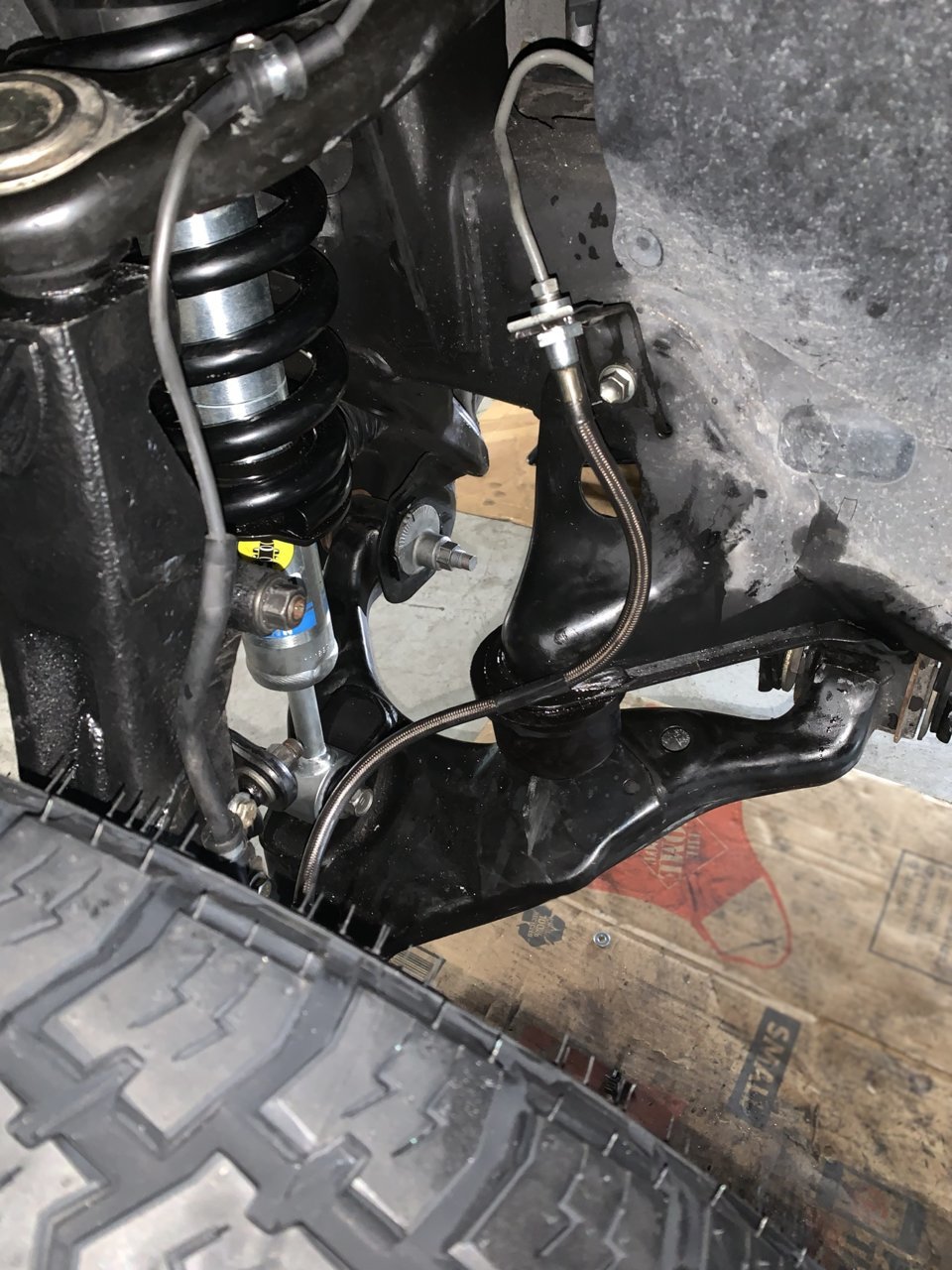

    Anyone brake mine looking like this ? Or is it going along the spindle ?
    08BajaBoy and ChadsPride like this.

    That's how mine looks

    yep, same here.
