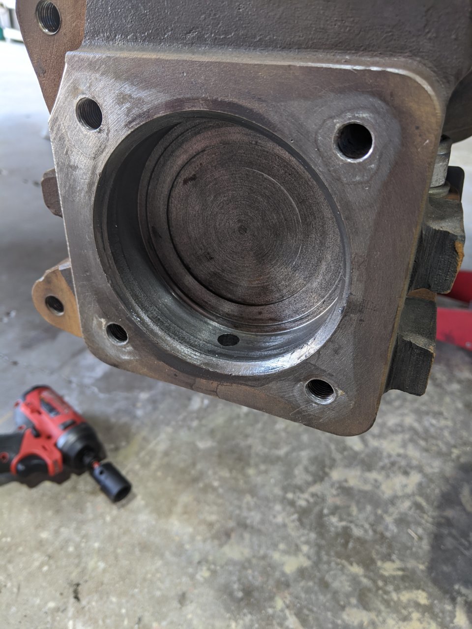

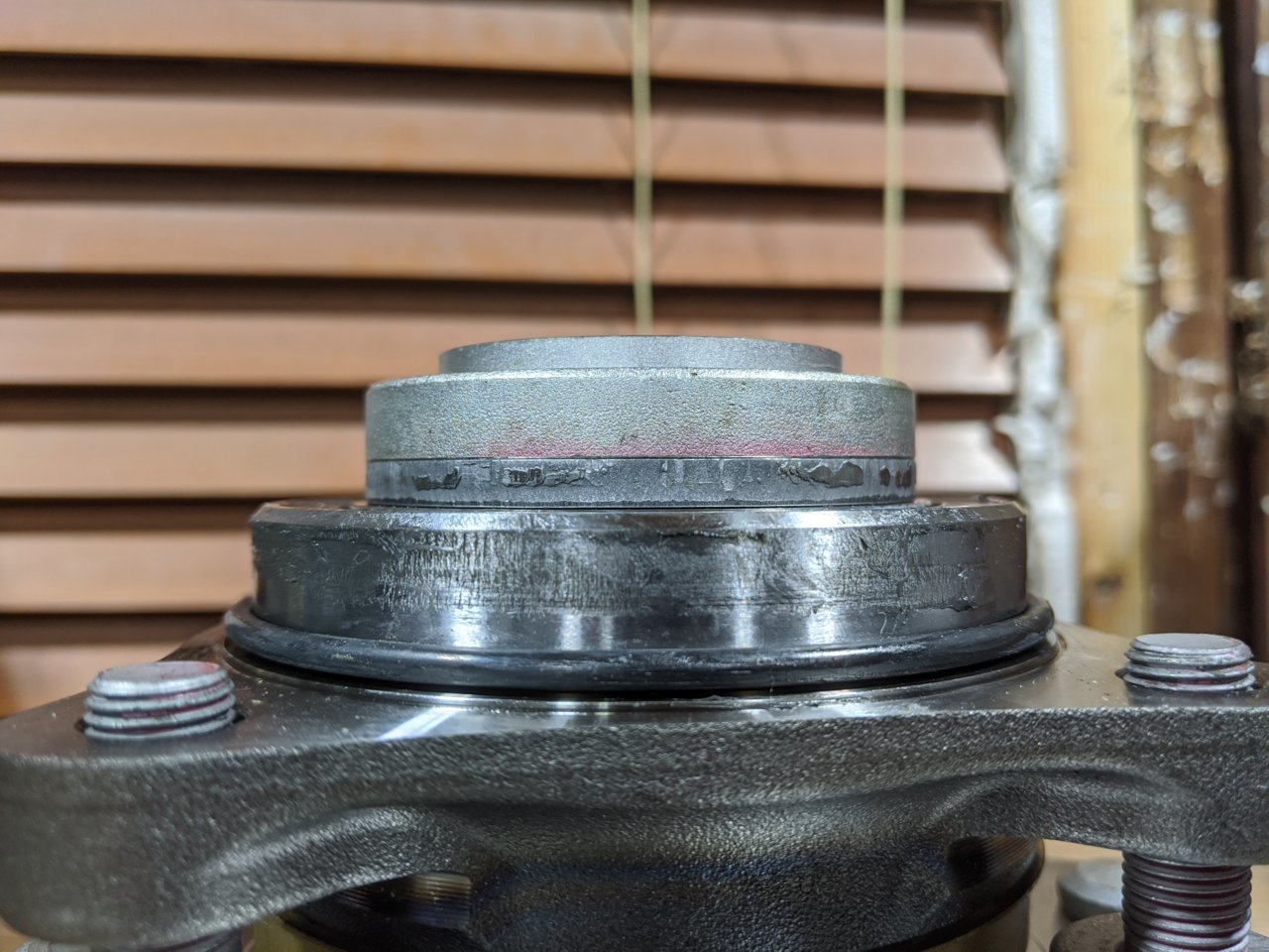

    Anyone on here with the Maxtrac's installed also replaced their hubs? If yes, where did you procure them?
    Reason I ask if that I am finally getting around to replacing my hubs after 190k miles. I purchased hubs from 05Taco4x4 (and I have already started a convo with him). I put the first one on and had stop based on how much of the bolts were still protruding when the resistance to thread them in was more than hand tighten. I immediately pulled it out and inspected the hub and the spindle. The spindle had a circular score line I think that came from the end cap of the hub. I measured my old hub and it's nearly .200 inches shorter (measured from the back of the flange that butts up to the spindle to the end of the end cap).
    My old hub does not have that area just below the red discoloration.
    Looking to see if anyone has had the same problem or any insight.

    I replaced mine back in the fall. I got them from Detroit Axle. They went right on with no issues. Hope you can figure yours out quickly.

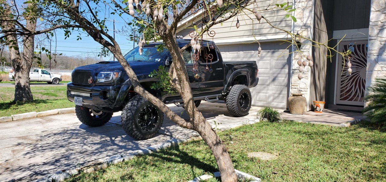

    So after all is said and done I'm satisfied with the lift and look it gave my truck. The UCA's I went with helped out a lot and didn't have to do CMC, unless I plan on Offroading like crazy. Now that I'm done with mechanical repairs and upgrades I can concentrate on painting and dents. I'm pretty sure I'll upgrade shocks and coils for something better eventually but for right now I'm good. Probably add a hidden wench too.
    I still have the spydertrex spacer in back because I like my wheels in the back wider than the front
    Maxtrac spindles
    Bilstein 5100 adjustables
    OME 885 coil
    JBA UCA's
    Custom leaf pack and Maxtrac extended shocks in the rear. 35x12.5 Atturo Trail blade M/T
    Moto Metal 18x12 -44 offset wheels.

    Now we got to get together for a photo op :D
