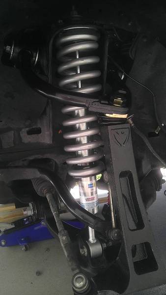

    Yeah billys set @ 0
    So the hole set up has to settle to give you guys an accurate measurement but all I can say is IT'S SITTING WAY TALL. So hopefully it will settle around the 25" +/- mark.
    Going to get an alignment in a few minutes and hopefully they understand how to align with the LR UCAs.
    Cross my fingers!

    In the front I have Maxtrac Spindles, 5100's, Eibachs, and LR UCA's. It's sitting tall, if it does not settle by two inches I'm removing the coils and installing the stock ones.
    Once it settles ill find out what size block ill need. But forsure i will beh ig Allpro Expo' when a group buy, sale, or black Friday sale aars.
    Ahhh I'm having phone issues sorry for the miss spellings. I'll re write this when I get home.

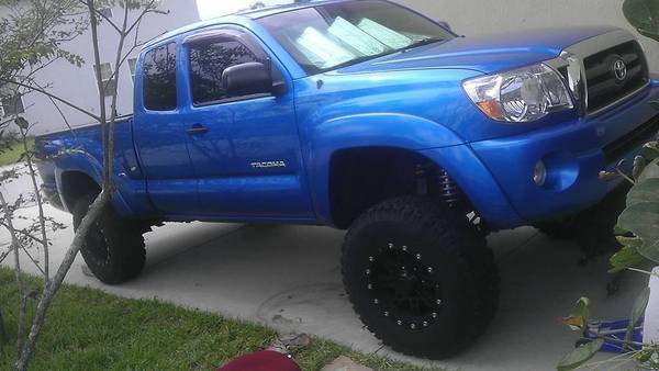

    this is it 25.5"

    I'm @ 25.5" also. It looks like a beast! I have to say spindle lift on tacomas are hands down the way to go.
