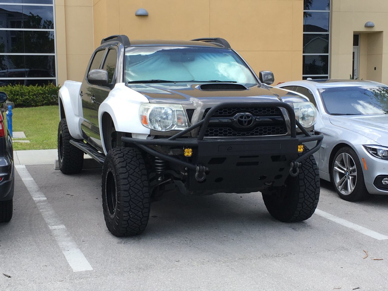

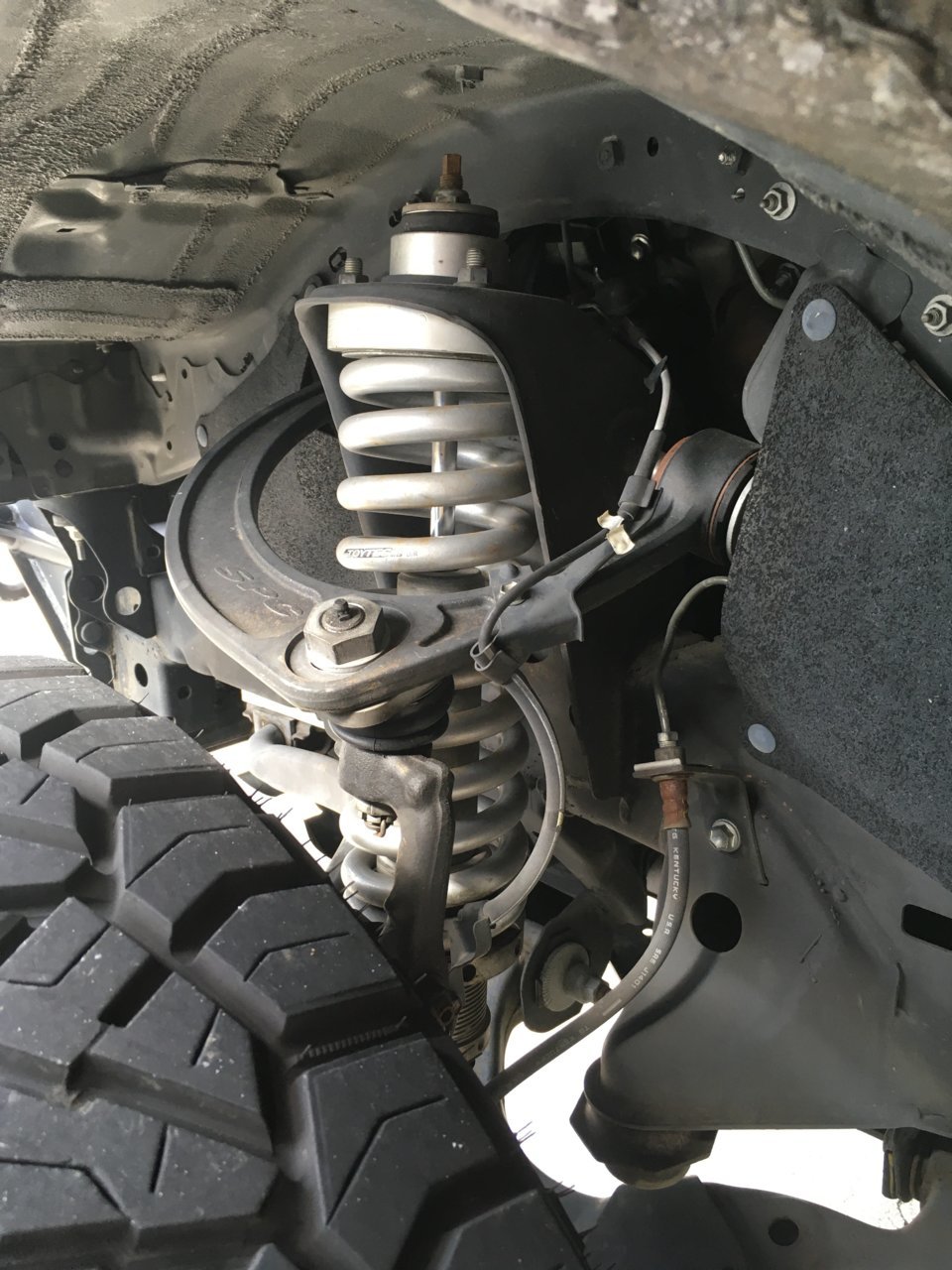

    Just added glass (a work in progress...). Looking to go with a spindle lift next, so questions will be coming! Not sure which route to go with my current set up? It's the Toytec ultimate with the heavier springs due to the weight of the front bumper. The ride is extremely stiff after I switched to heavier springs, with the small shop in town not sure exactly how to set it up. I really am looking for some height and more importantly, a better ride. Hoping to get some good info here. I have SPC UCAs as well...Thanks to all in advance!

    I'm betting those are #700 lb spring rate coils. I would go with 650s and see what you think. Your setup is good to go with the spindles. Just sounds like spring swap would be it.
