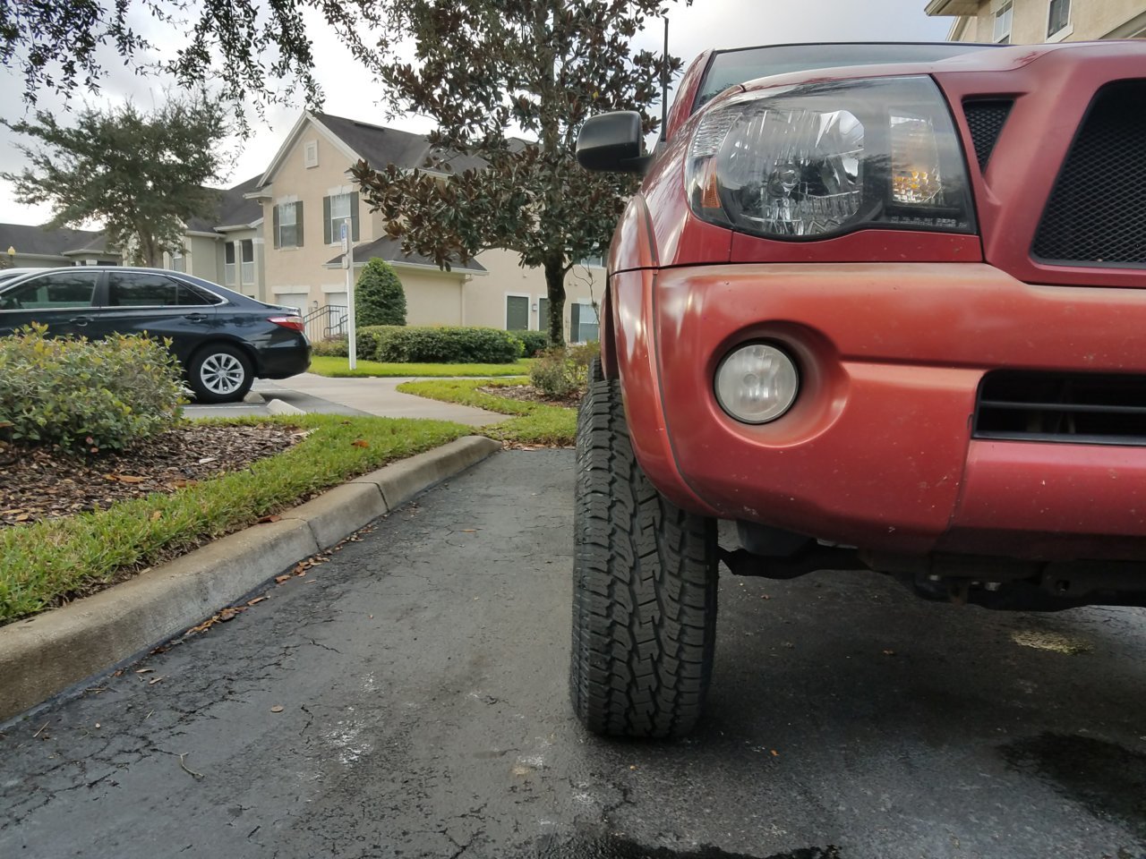

    Just so you can see fully. I frankly don't want another red vehicle if I can help it. Thankfully this is my second vehicle. I had a jeep cherokee basically the same color, "chili pepper red". I keep tossing around getting a new truck, which will sit for the most part with this work from home hoopla. But this no payments thing is great! Plus ol Red hasn't shown slowing down any and still thumping along at 180k. Could use a paint job to fix the top of the cab and the pits from road rock on the highway.

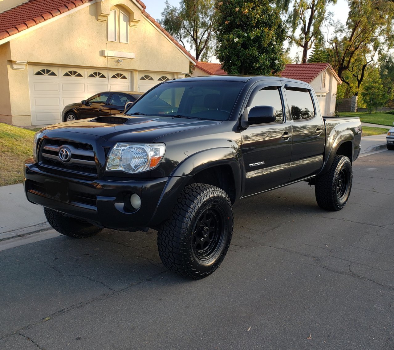

    (BEFORE) This is my truck on 3" spacer front /2" block rear on stock suspension

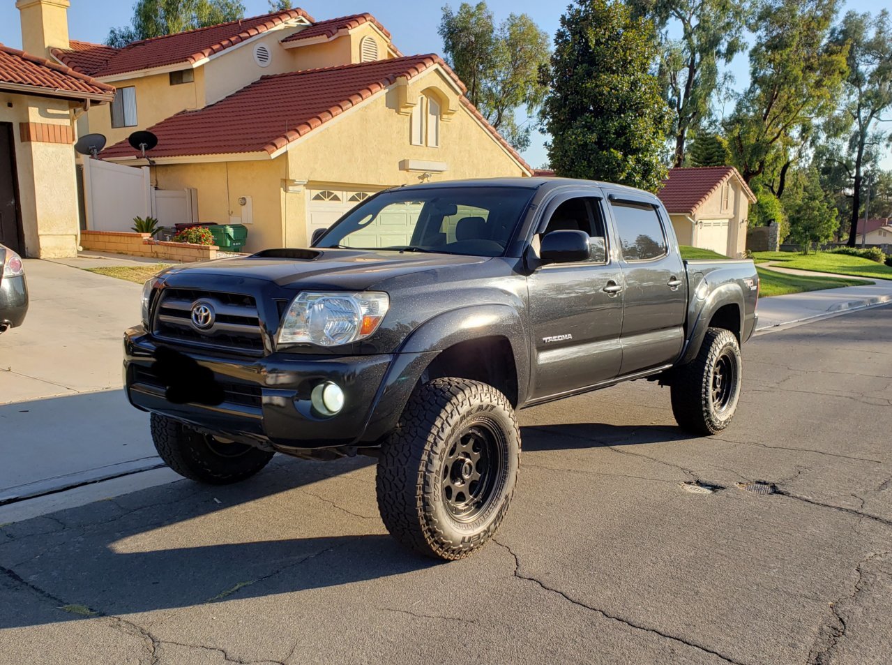

    (AFTER) This is my truck now. Maxtrac 4" spindle with 5100s all around on stock spring at 0 setting. The rear has icon aal 1.5" with overload leaf(equates to 2" of lift) . Love the way it drives now!! Riding on spacers/blocks sucked compared to now. Also with the proper caster

    From wheels do stick out a tad(3/4" cuz the spindle) but I think I'll keep it I like the look of it. Now I'm level. Before on blocks there was a slight rake. I'm totally happy with this setup and happy to have my u joints and carrier bearing replaced(old u joint was chirping like a bird). And with the spindle retaining stock from suspension geometry, I don't need upper control arms to get proper alignment(I also don't have that wander/loose feeling doing 80 on the highway like I did before). I do still plan on getting aftermarket uca's and lcas in the future. But I'm happy with it. I'll be doing mild off roading nothing too crazy I'm rwd sport so I know my limitations

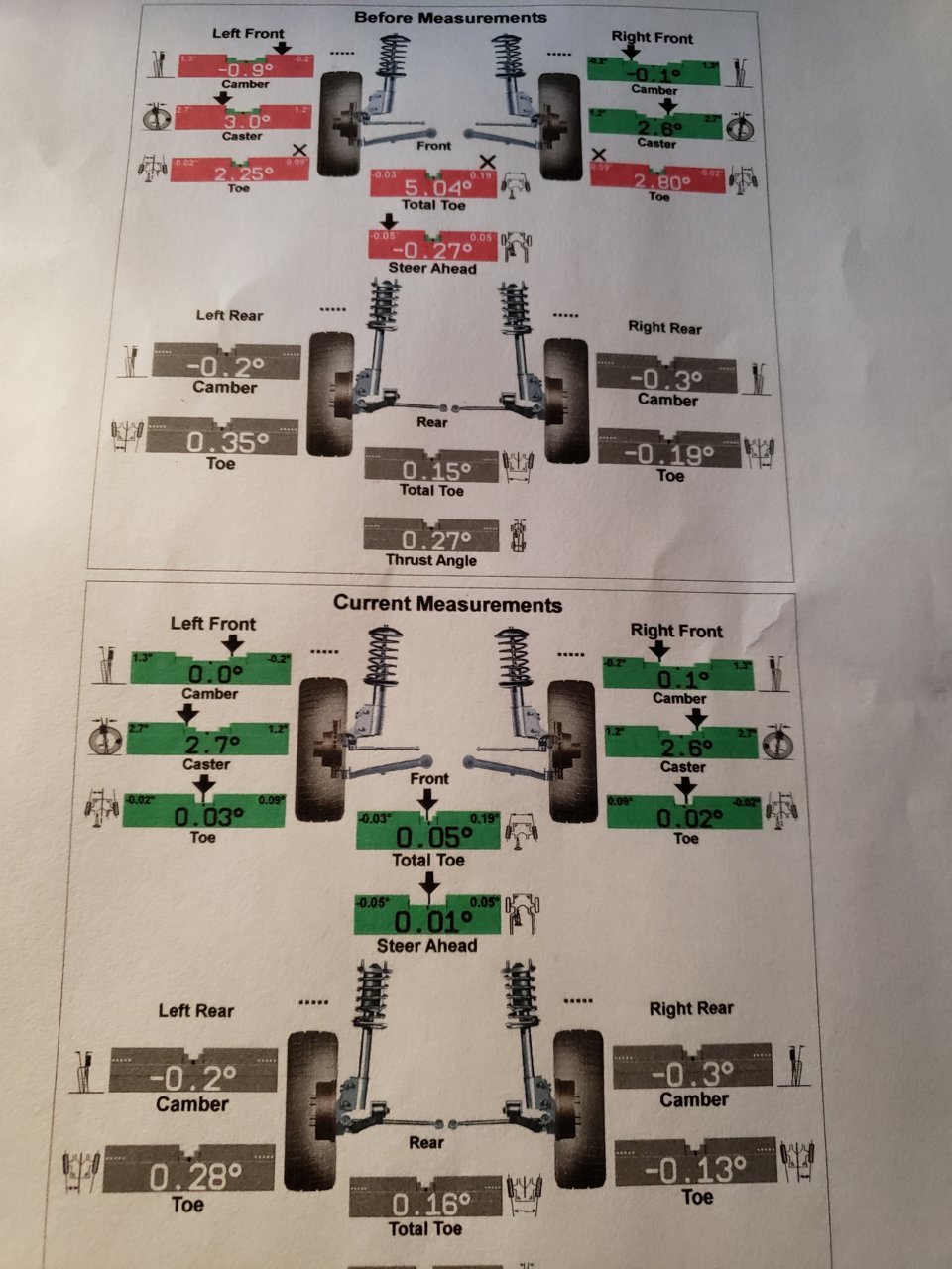

    Here is my alignment sheet. The gentleman who installed it told me he thinks the guys who put my spacer/block lift didn't even align it like they told me they did.
