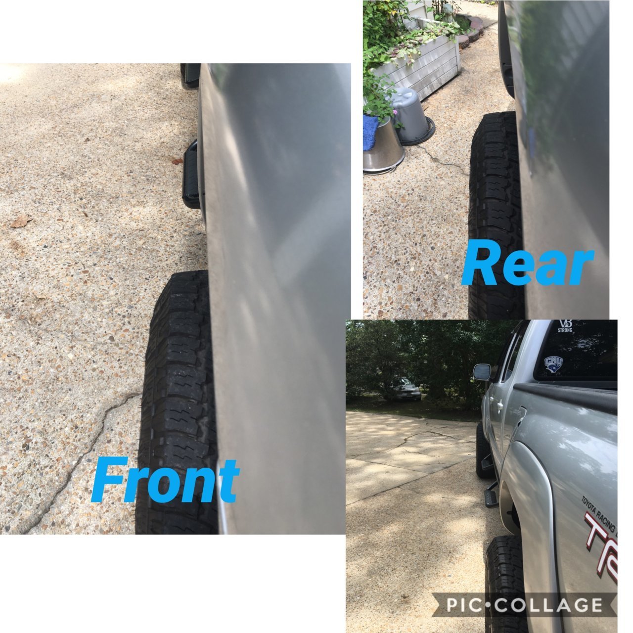

    D85D994A-334D-4385-807C-DBA5D8B1B311.jpg Here’s mine with the 1.25” Spidertrax on the rear.
