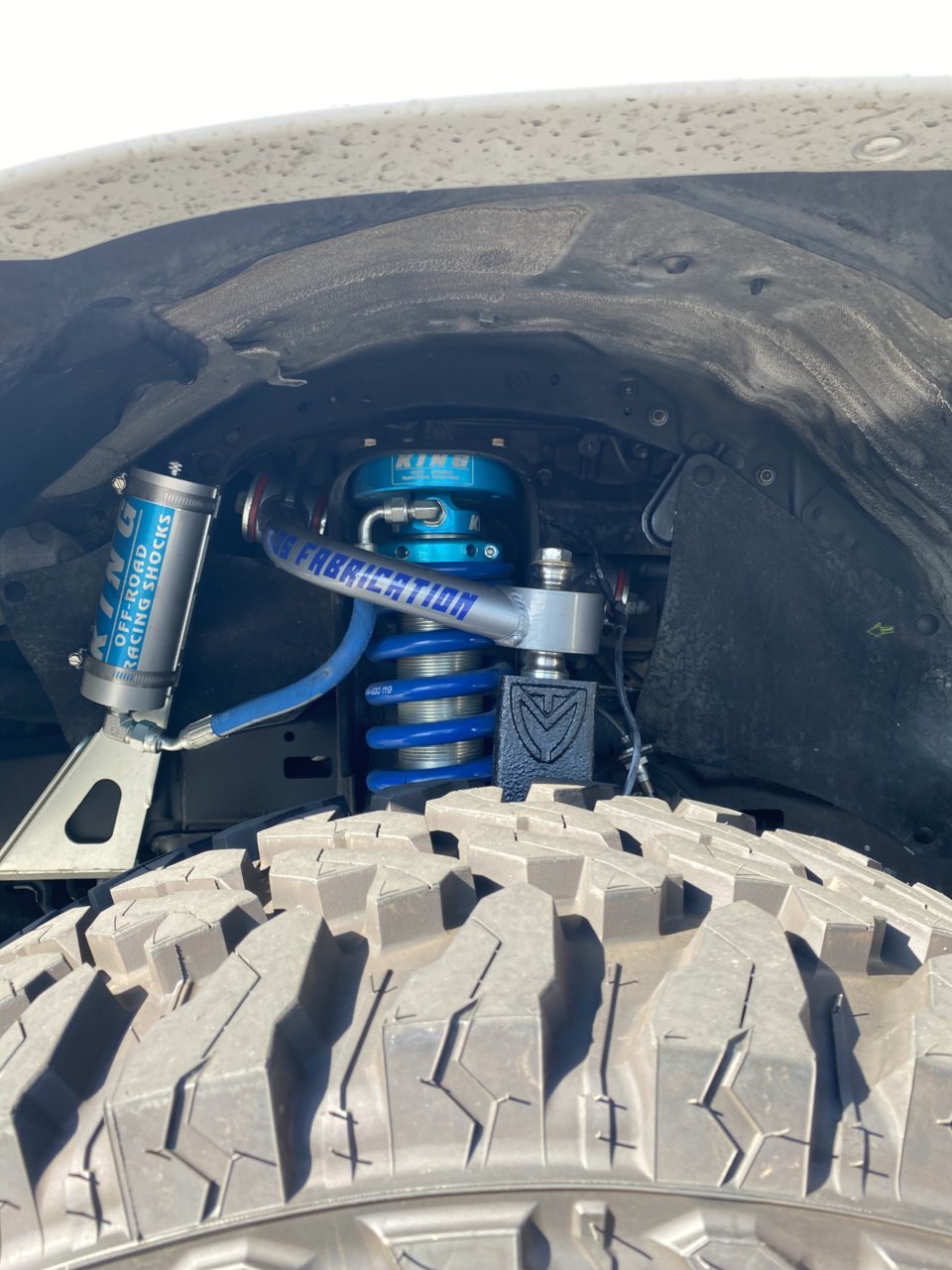

    I've got TC UCAs with Maxtrac spindles & King 2.5 remote resi shocks. I wish the TC arms had more caster in them, I can get about +3 before the other alignment specs start to suffer. I'd like to get around 5 to move the 34's away from the cab mounts. Minor complaint, otherwise they've been maintenance free & awesome! Quoted myself below so you can see pics, if you'd like.

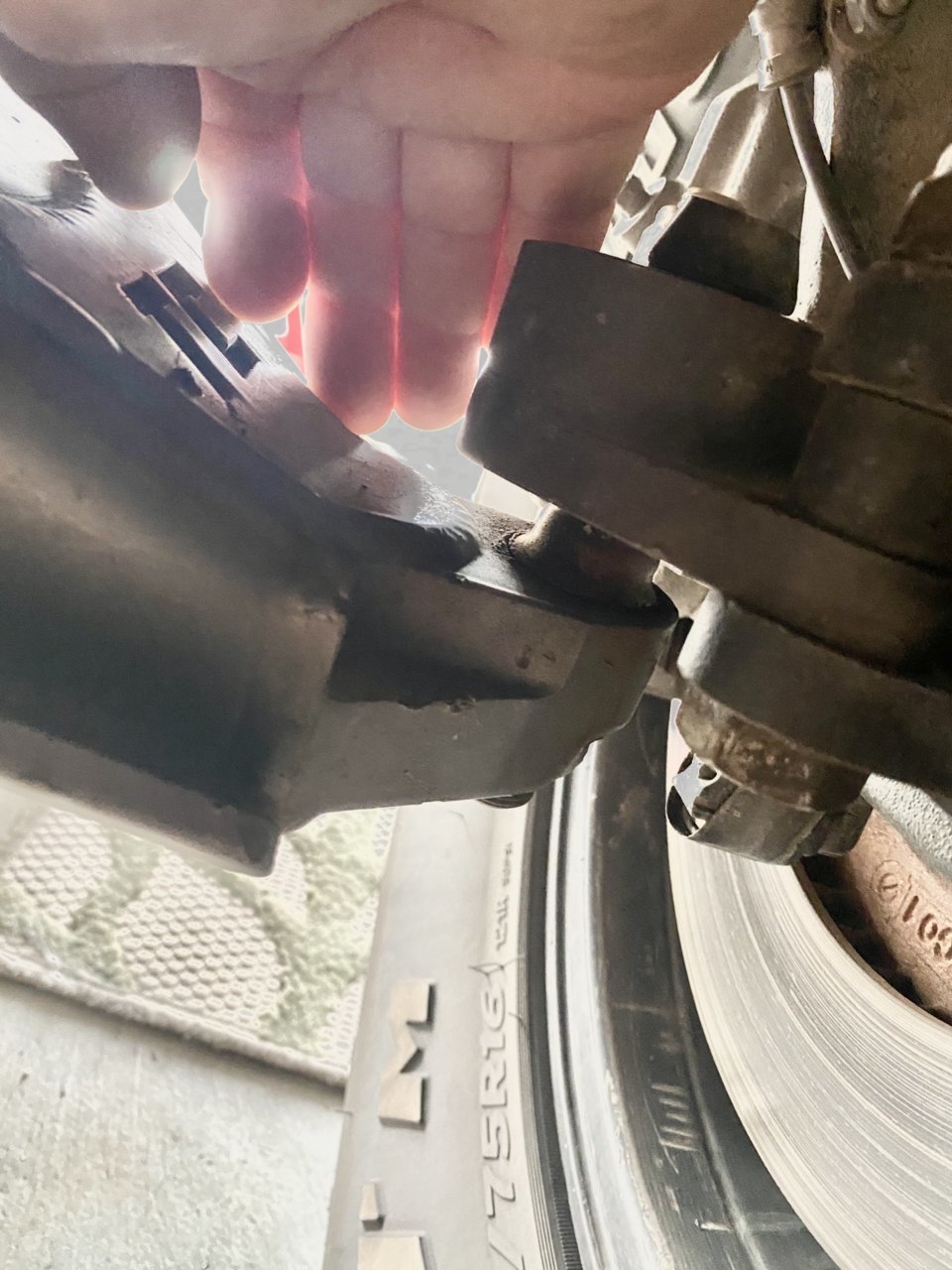

    @Airdog @TheBlueBeast15 so I finally had the LCA's with the modified brackets installed on Thursday. They fit perfectly. But after inspecting them last night, I realized that this combo of parts (spindles and LCA's) requires a mod to the spindles too. The front double shear projections extend in the horizontal plane beyond the LCA bracket. So when you are at full turn, they hit the LCA. If it was flush, it probably wouldn't be a problem. I need to talk to Ryan at LSK if it would make more sense to machine the spindle down to be flush or if he could offer a different modified bracket. The picture below is with only about 60miles on the install (all freeway or street driving). I think most of the damage was done while pulling in and out of parking spots. The rear projections appear to have plenty of room.

    Yup that’s another issue that you run into when you eliminate the stock steering stops. Luckily for me the TC Lca’s have a pocket the lower boltheads go into and act as the steering stop. But as you can see in the pic they do have some slight damage.

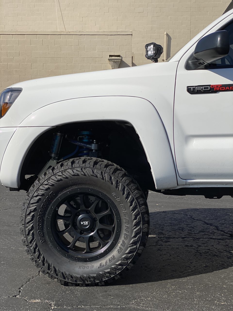

    Put my MaxTrac spindles on about a week ago and all I can say is that I am so happy with how it turned out. I currently have king 2.5 Resi w/o adjuster with total chaos uppers and lowers and just adding the MaxTrac spindle to the car was just a MAJOR upgrade, the ride feels so much smoother and was finally able to lower the shock height and give it more travel. The stance and height is perfect and I couldn't be happier. Now just need to hit some trails and some dirt to fully test it out the ride but just riding it on the road it is so nice and smooth. Pictures coming soon!

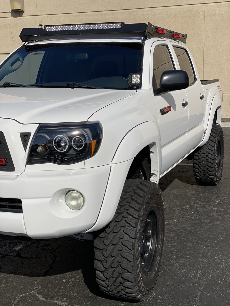

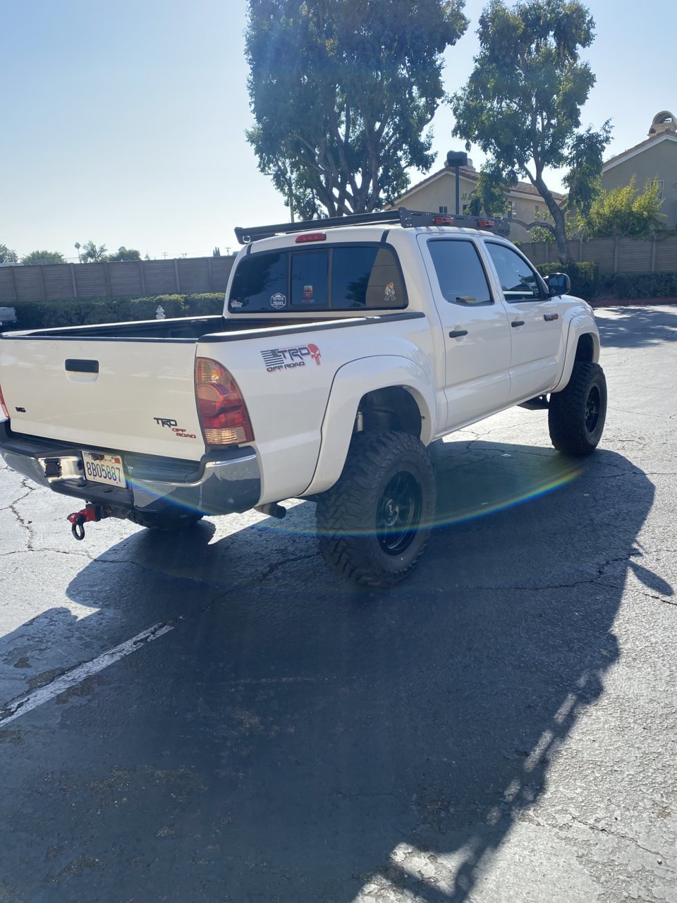

    Here’s the finished product, so in love with how it looks!

    This truck :drool:

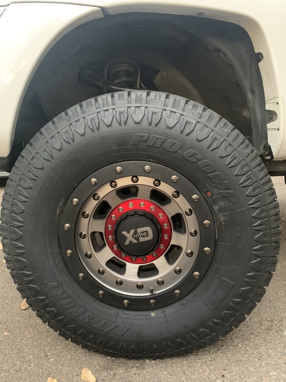

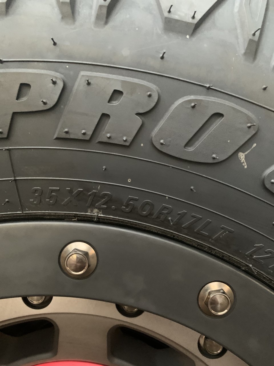

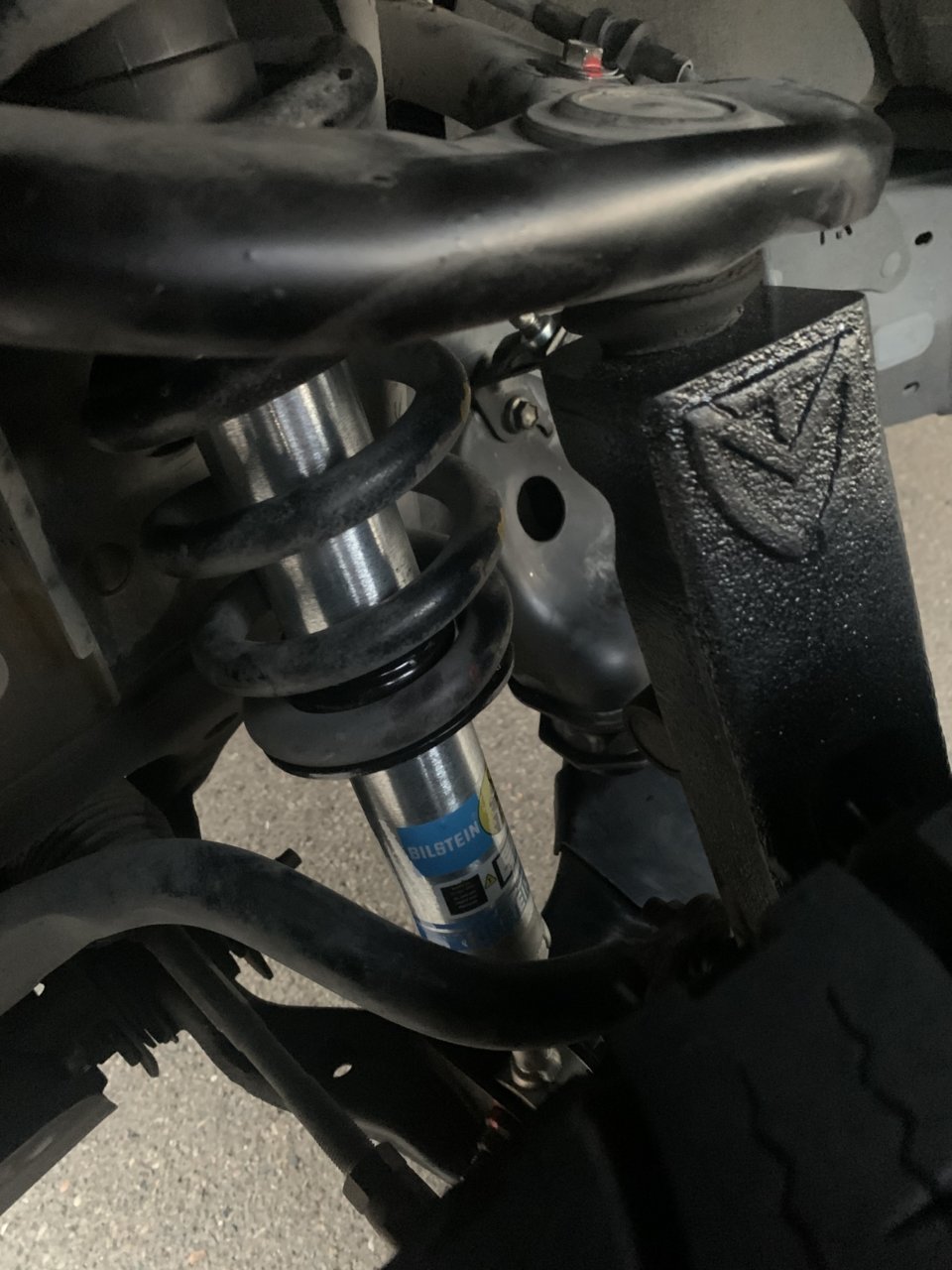

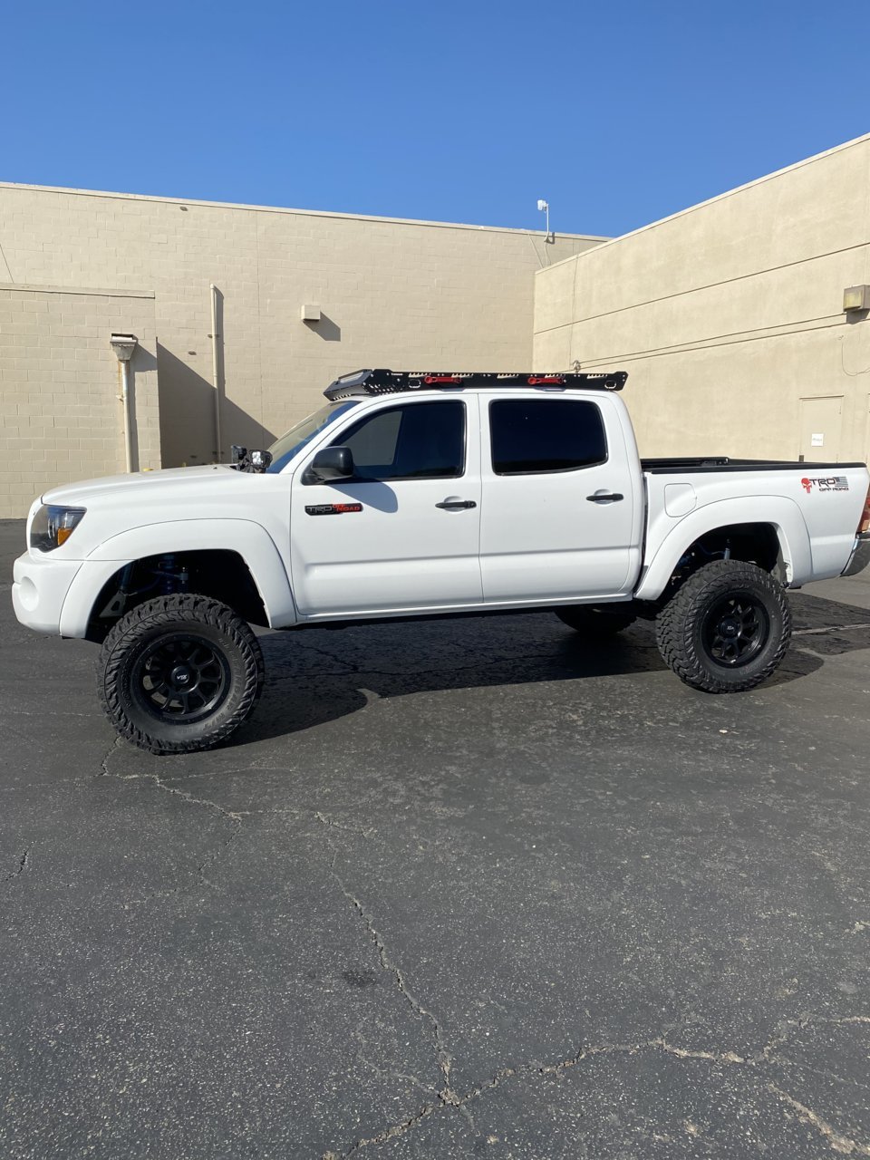

    The deed is done. Finally got myself Bilstein 5100s for the front, set at a 2 inches, along with the Maxtrac Lift so I could slap on some 35’s. Errr muh gerrrd I am one happy camper. Feels like I’m riding a completely new truck. There’s a slight bro lean because I only got 2 inch blocks for the back, but I might consider AAL or Dakar leaf springs if I feel like I need it. I got some Pro Comp tires thrown on my XD FMJ wheels because, well, the guy sold it on me lol. I was only going 285/70/17, but he insisted 35s would fit easy. And easy they did. So he found these so I didn’t break the bank (too late). Still have much work to be done, but I am sooo stoked upload_2020-10-1_18-58-51.jpg

    Looks bad ass bro!!!

    Thank you, Sir! It was supposed to be a slow and steady process, but I talked to the guy at the shop, and a pair of Billy’s turned into a pair Maxtracs turned into a set of 35’s and before you know it I’m calling the Mrs. for approval :spending:
