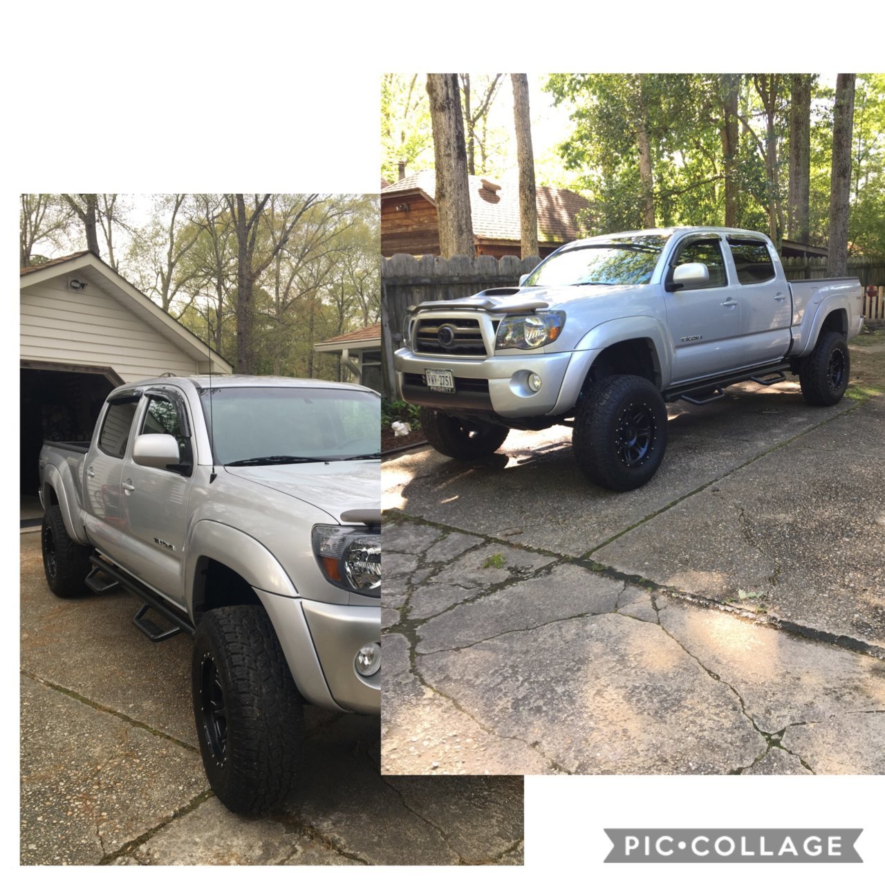

    I have the Bilsteins set at the 3rd notch so 1.75” with the spindles. The rear has 2” block and 2” AAL. The ride is still comfortable and my 285/70/17s have no rubbing issues. Before I put the Bilsteins on I had to trim some because it would rub a little on the edge of the fender and the front of the wheel well pan.

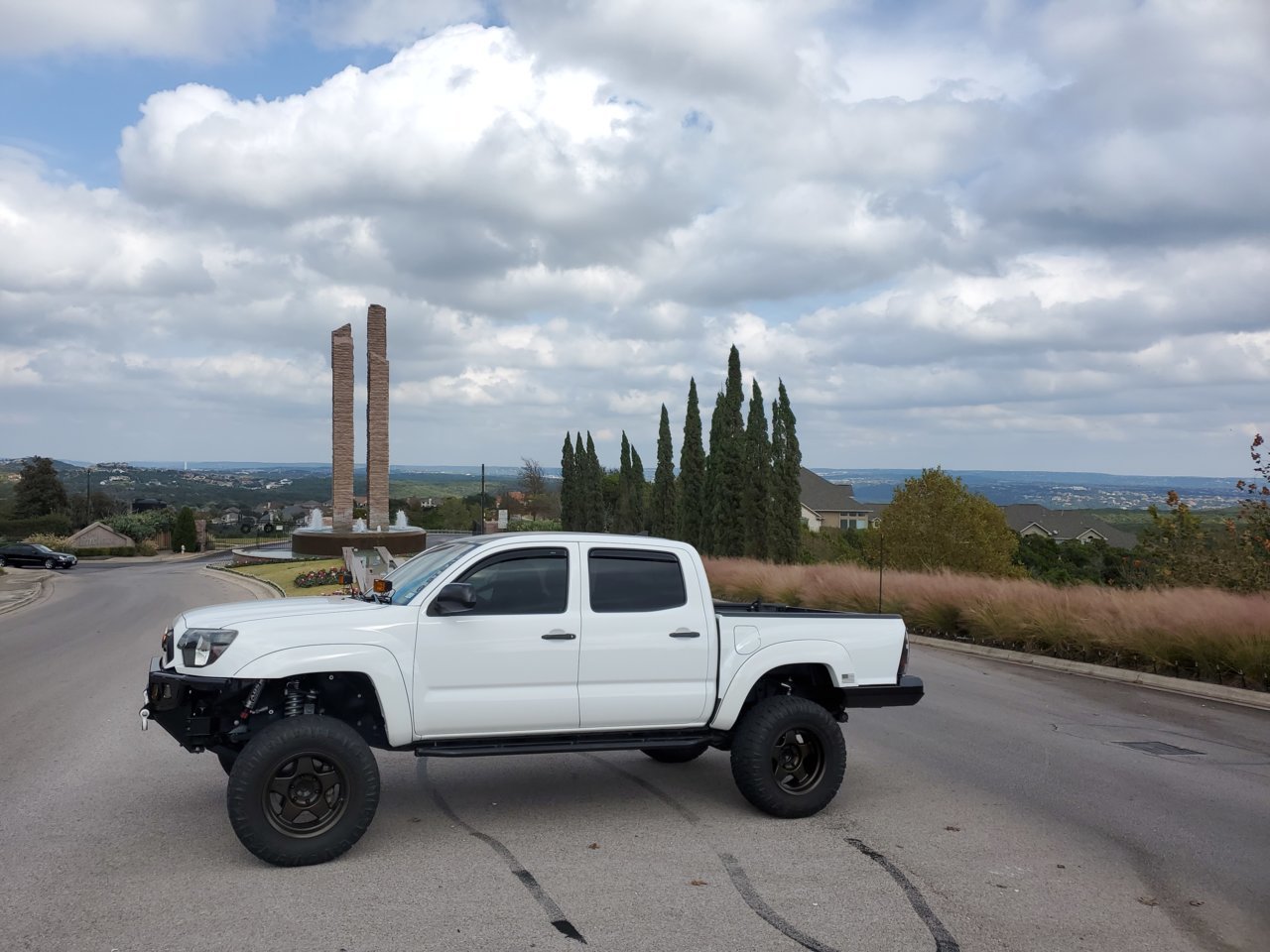

    I cleared fine with just the spindles. I added the bilsteins and AAL just for more lift. I’m running Pro Comp 9000s on the rear. It’s pretty much level. The pic on the right is after the Bilsteins and AAL.

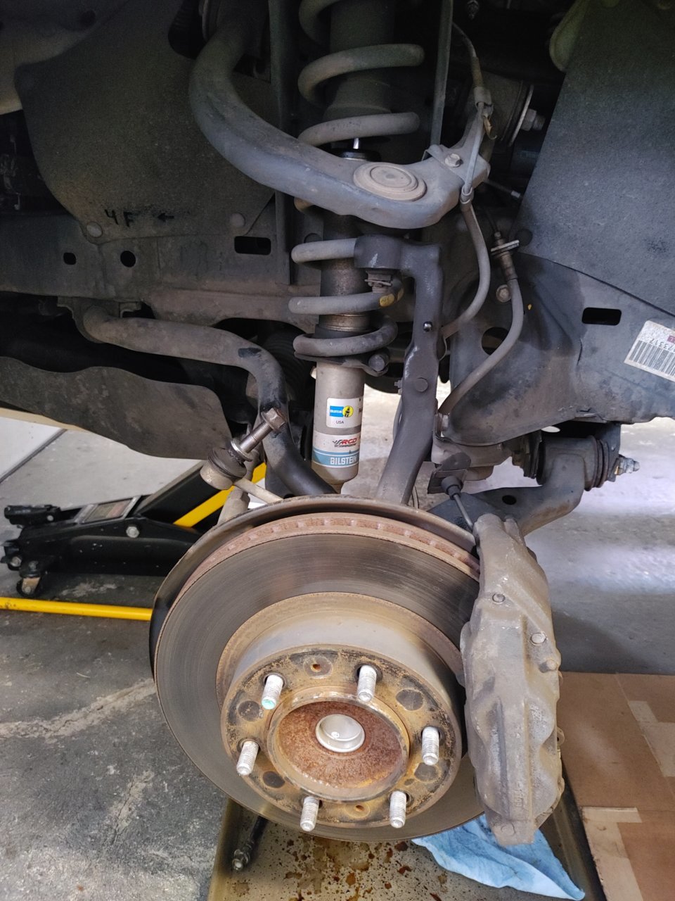

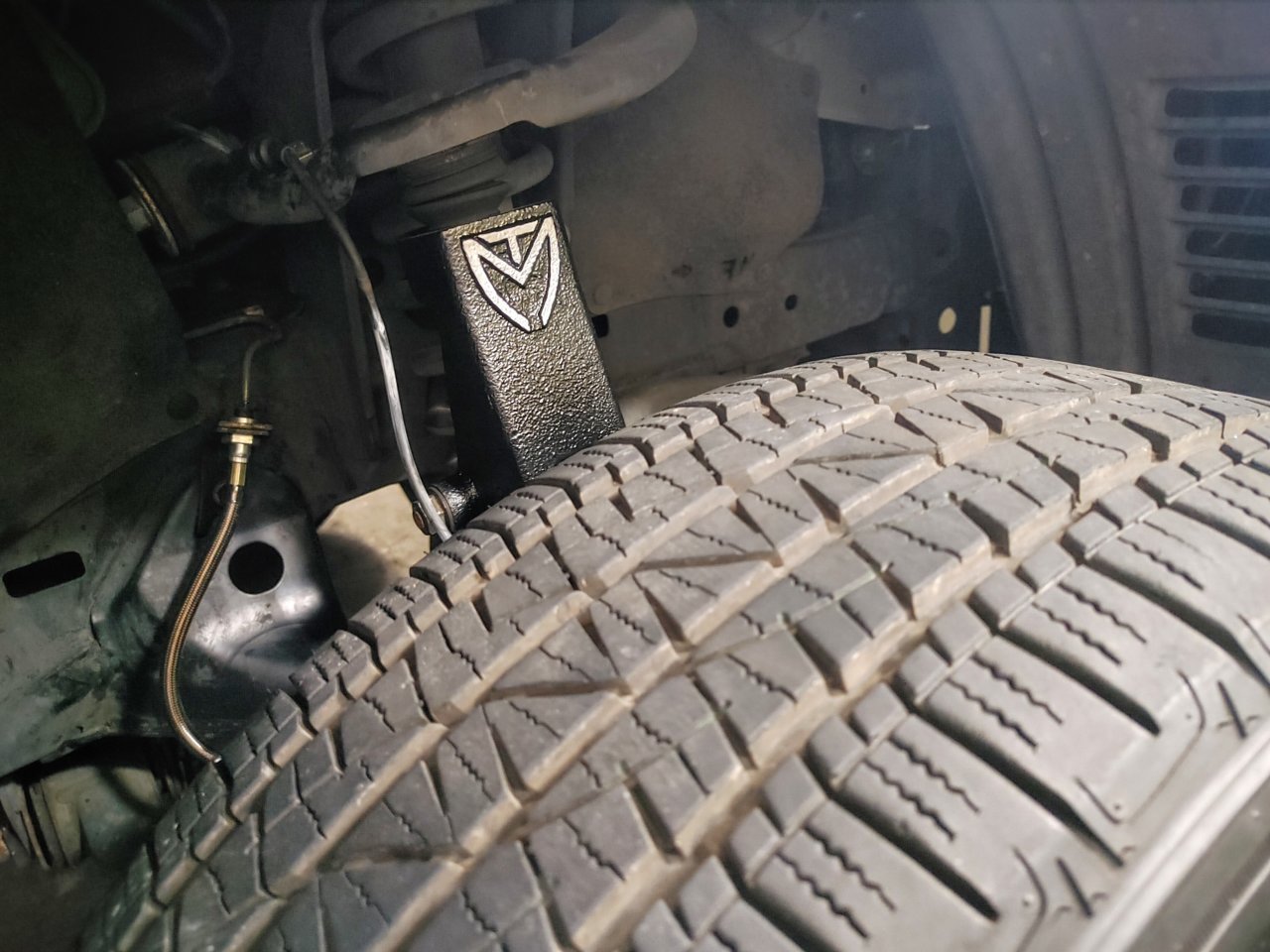

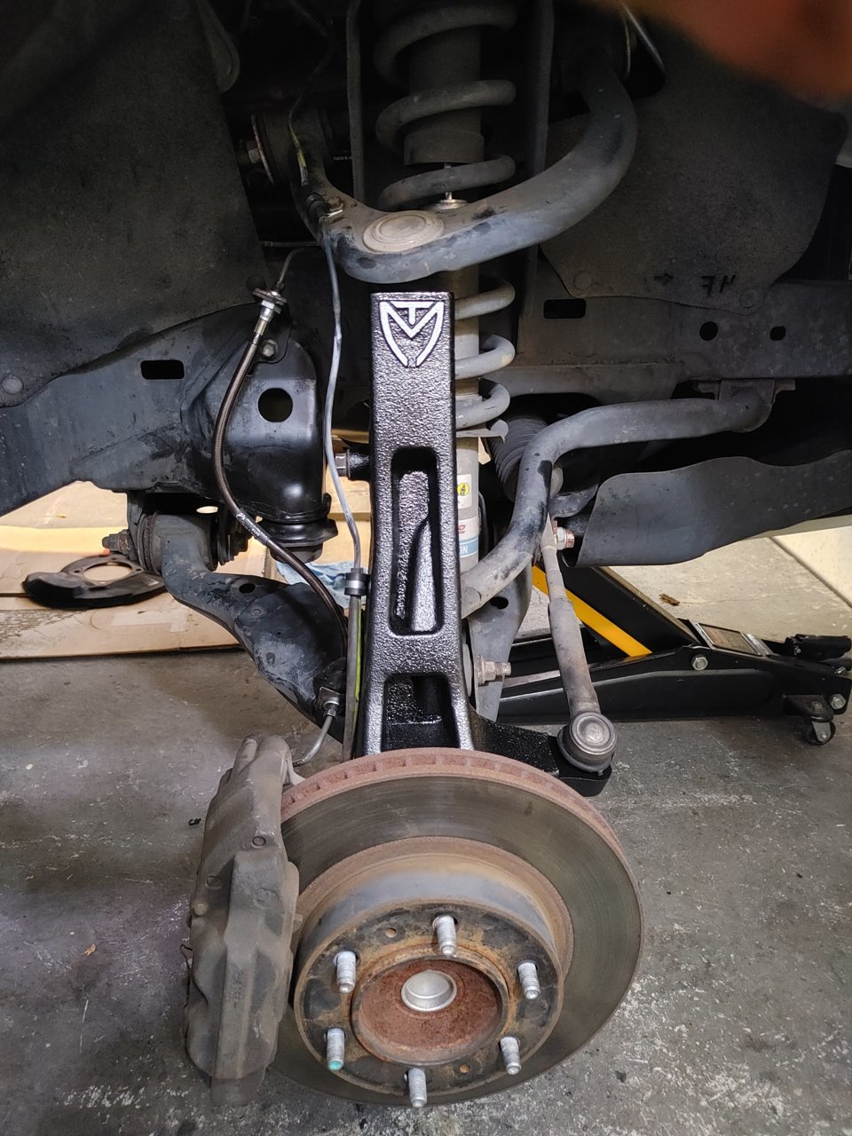

    Some shots of the install. Did the work by myself.
    Driver's side - before. The brakeline was such a headache! The factory over-tightened the fitting so it "belled" and was difficult to remove. Lost a lot of brake fluid and let in a lot of air.
    Passenger side - after. This side went really smoothly.
    Painted Maxtrac logo peeking out above the tire.

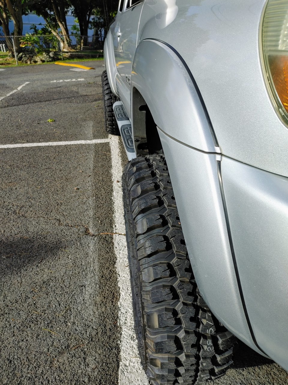

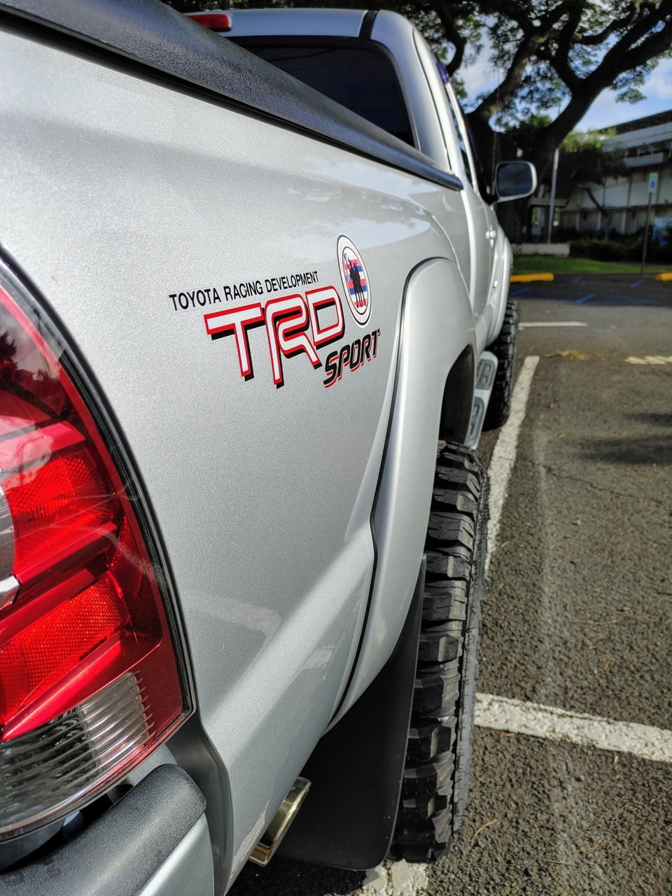

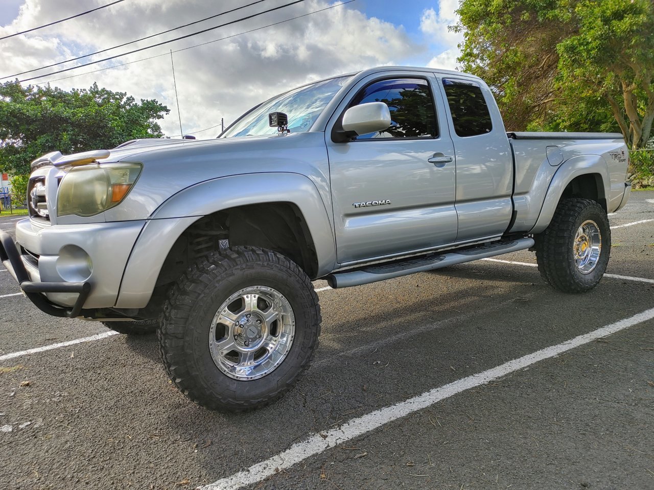

    Here she is with her new shoes!
    Billies set at .85" with Maxtrac spindles. 285/70/17 on 8" wide Procomp wheels. Really happy with the way it turned out!
    I thought the spindles would kick out the front more but its actually not too bad.
    I added spidertrax spacers in the rear to even it out.

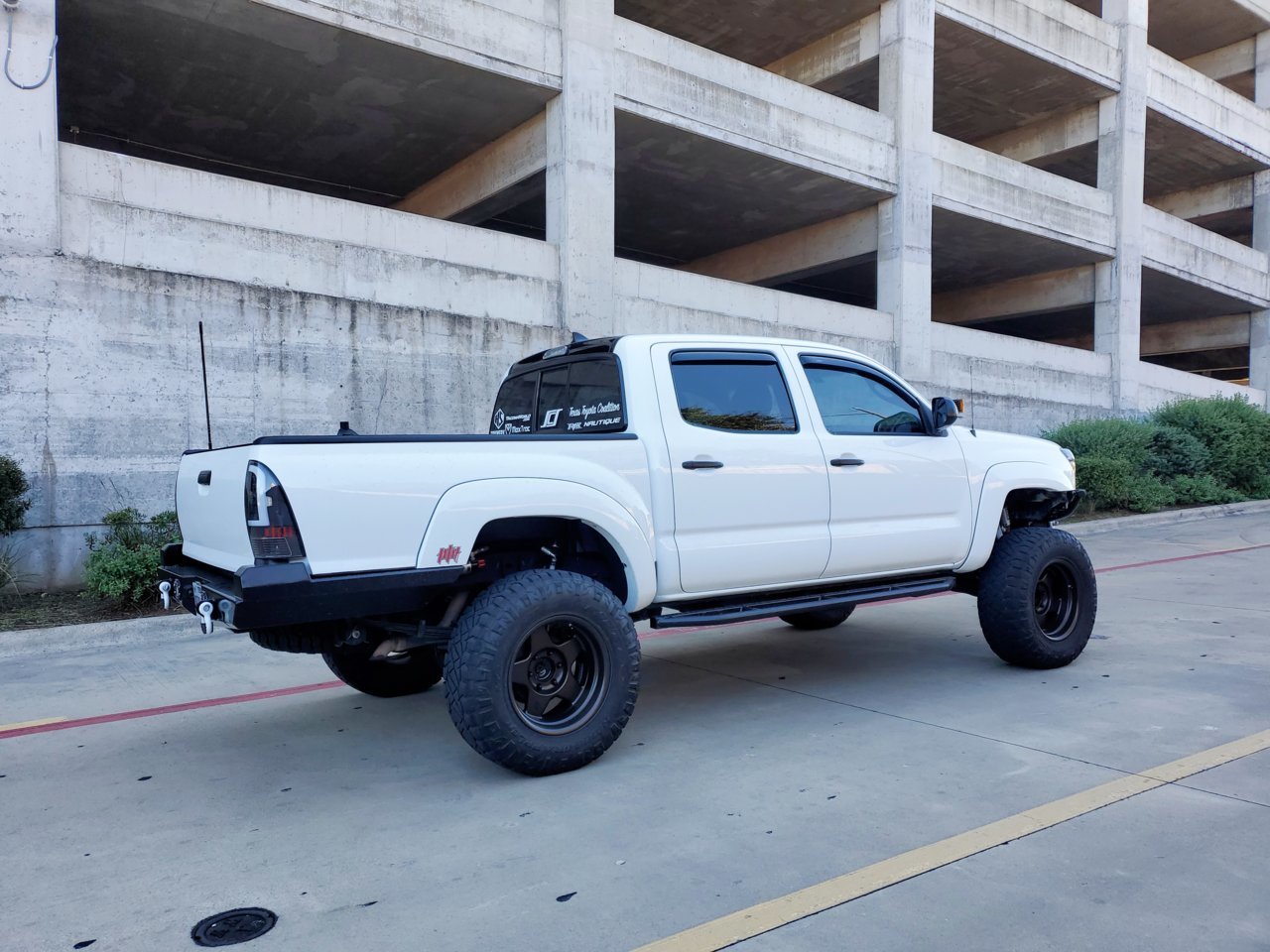

    if I go with maxtrac spindles, how much lift in the rear do i need?..... trying to figure out which AAL set i need.
  18. Nov 27, 2020 at 12:55 PM
    ChadsPride
    Nov 26, 2014
    #143119
    127,312
    Sponsored by TacomaWorld.com
    Just get a set of full replacement lead packs.

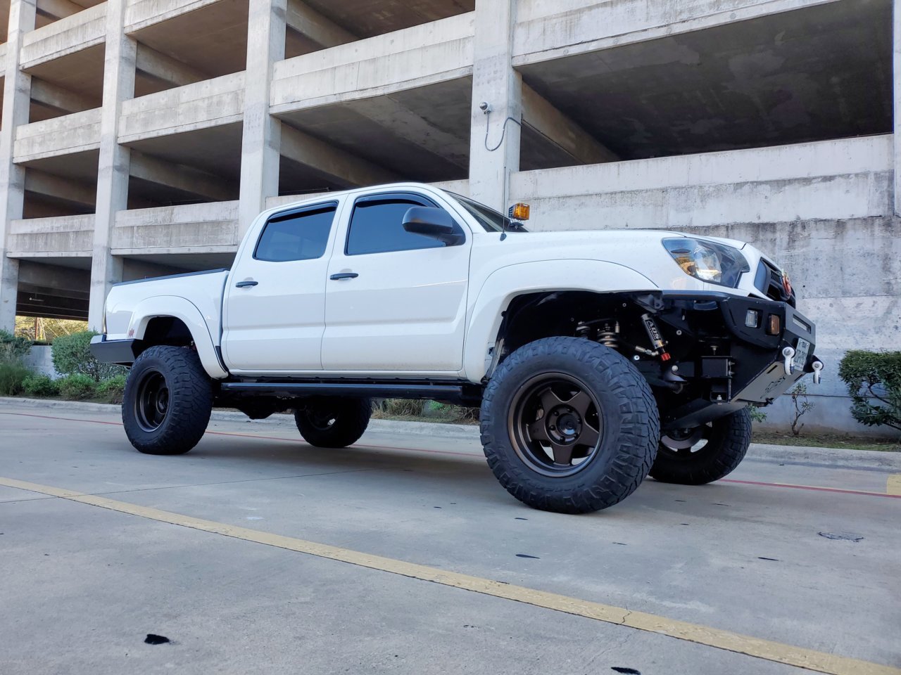

  20. Nov 27, 2020 at 8:07 PM
    Jimmy92870
    Jimmy92870 Well-Known Member
    Apr 2, 2018
    #249239
    803
    Texas (DFW)
    07 DCSB PreRunner
    If you're on a budget. You can go with a wheelers 2inch add a leaf and you can probably squeeze an extra inch if you get the half inch shims and the 3 degree axle shims from Toytec and pair them with the add a leaf. Should look pretty level with the spindles up front.
