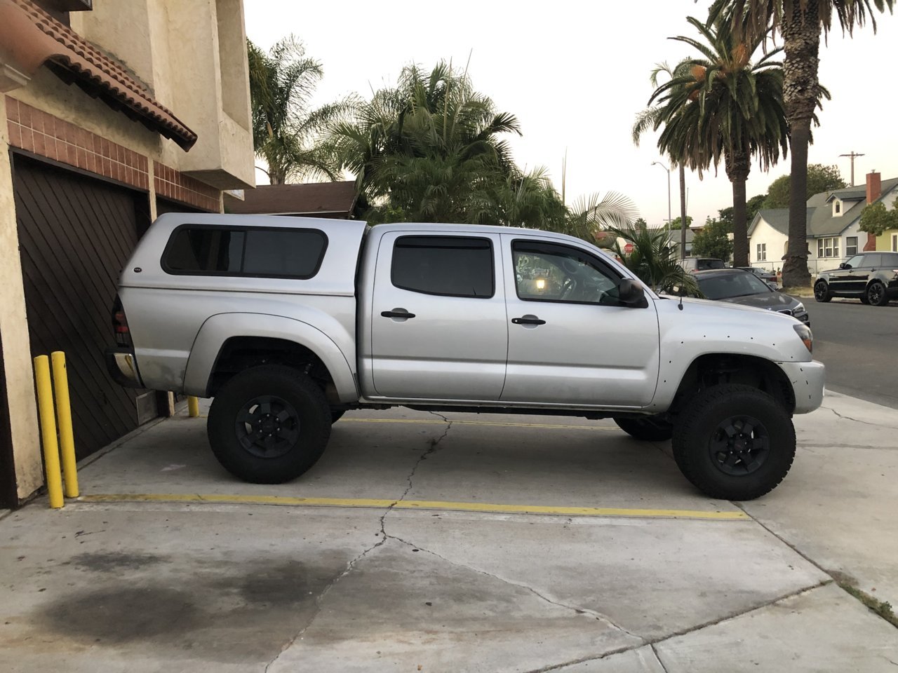

    That was my setup minus the shims when I had first installed the spindles.

    I think it's pretty good cause you can always use the shims when you upgrade to a full leaf pack.

    Yeah I’d definitely recommend a new leaf pack if you can swing it. Although I went the alternate route and made my own pack by cutting up an oem leaf pack and adding some leaves in.

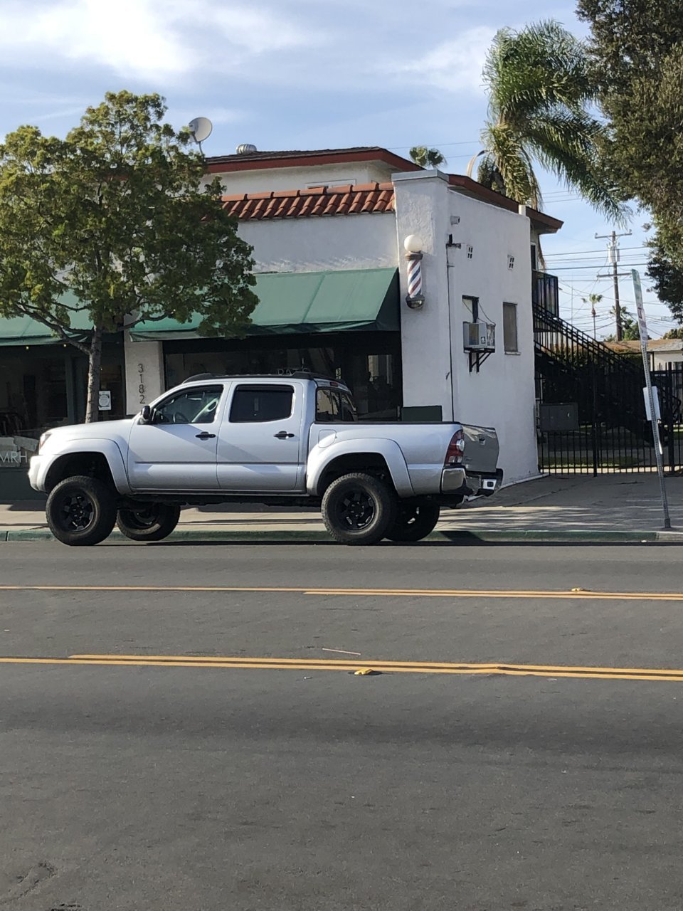

    Here’s how my truck sits with my Frankenstein pack with a shell on and a few tools in the bed.

    Sits perfect in my opinion
