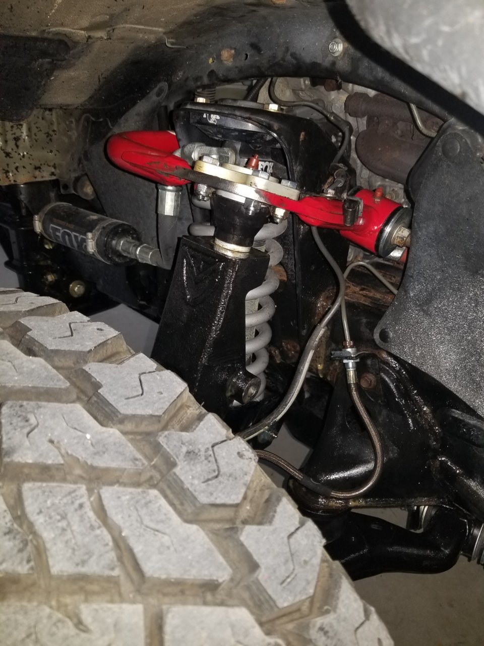

    Has anyone install these with JBA UCA? I'm having a hard time torquing down the 22mm BJ nut for the JBA's!

    I'm really dragging my feet on this install, however, I did break both anti-skid sensors and they just came in today. I found a 3/8 drive 7/8 socket that fit over the JBA BJ nut so I can now torque that bad boy. I'll knock this out this weekend!!!

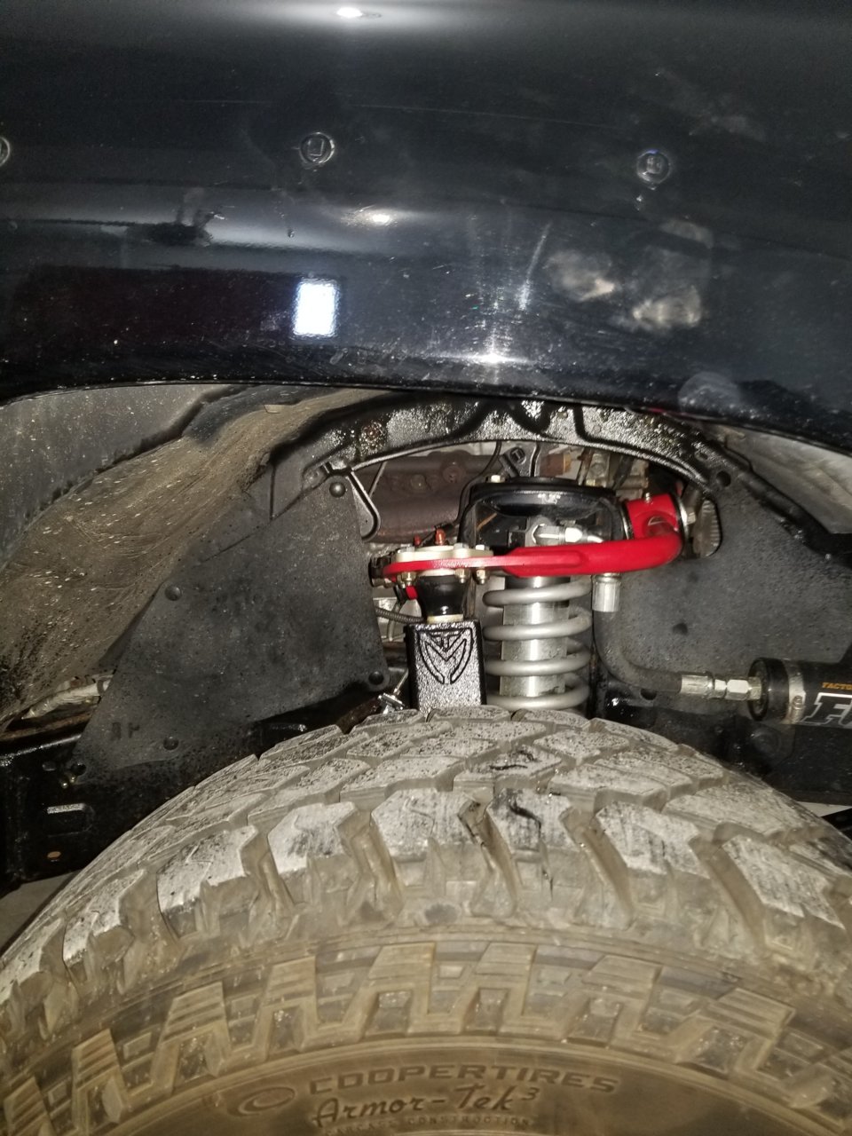

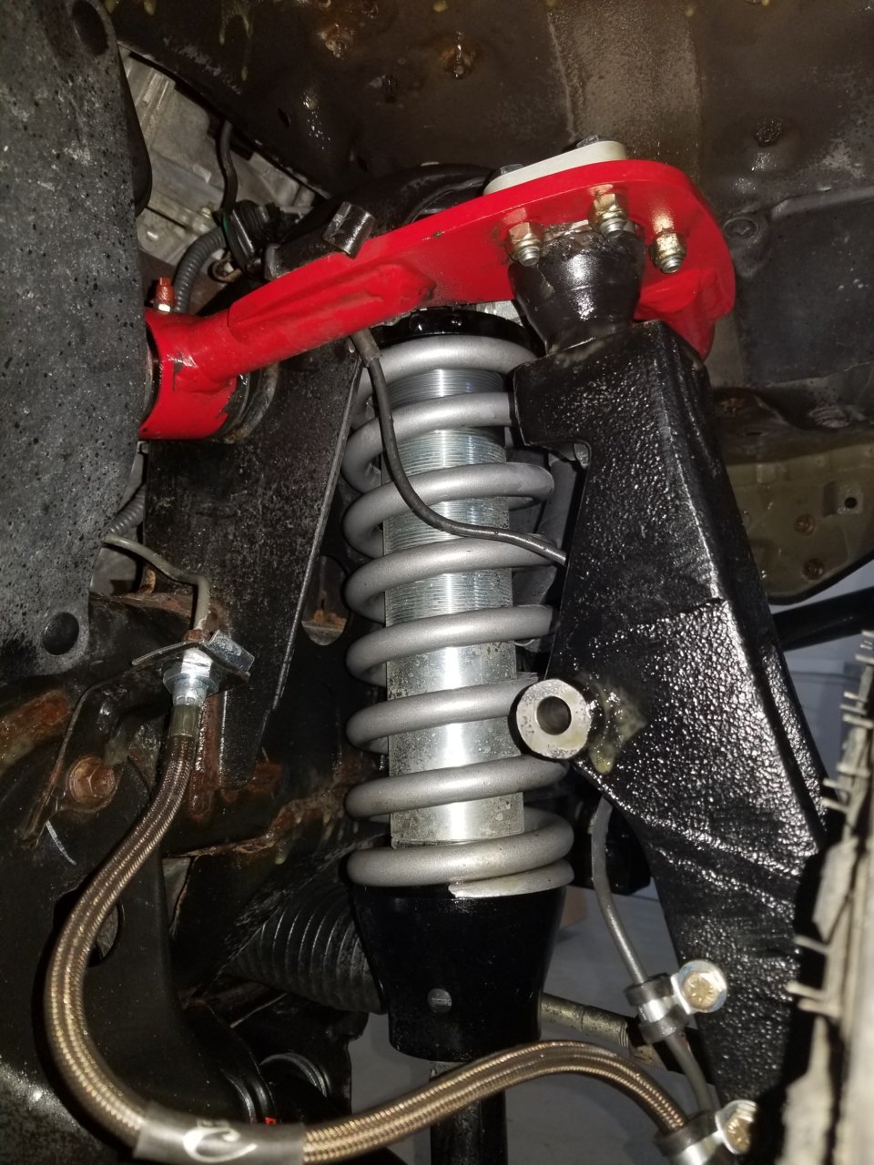

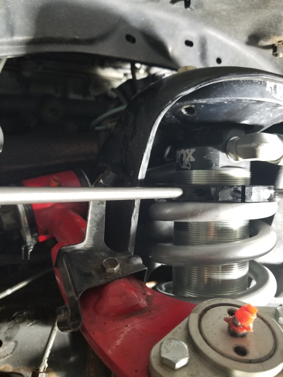

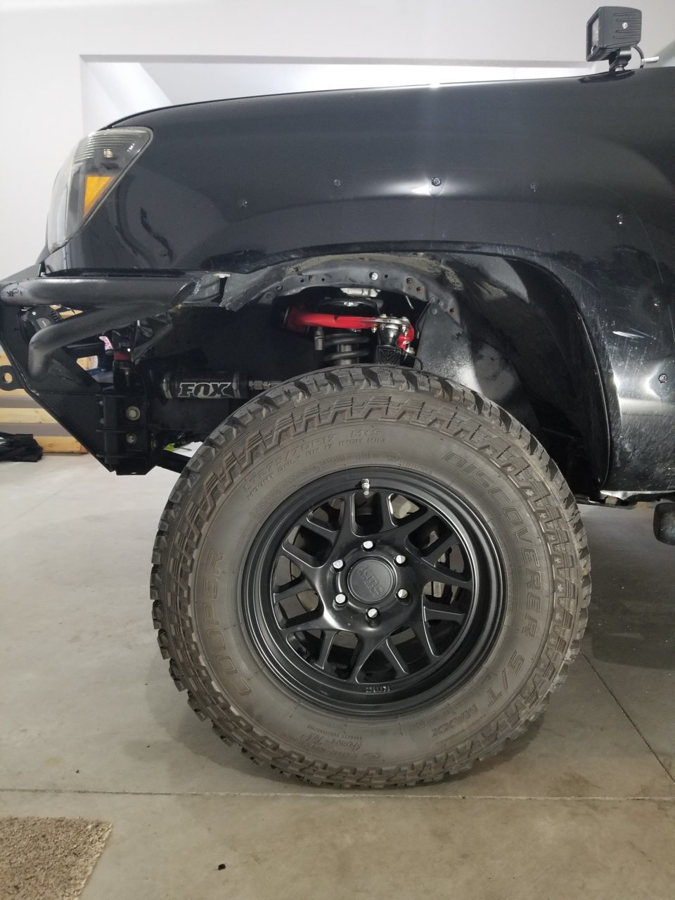

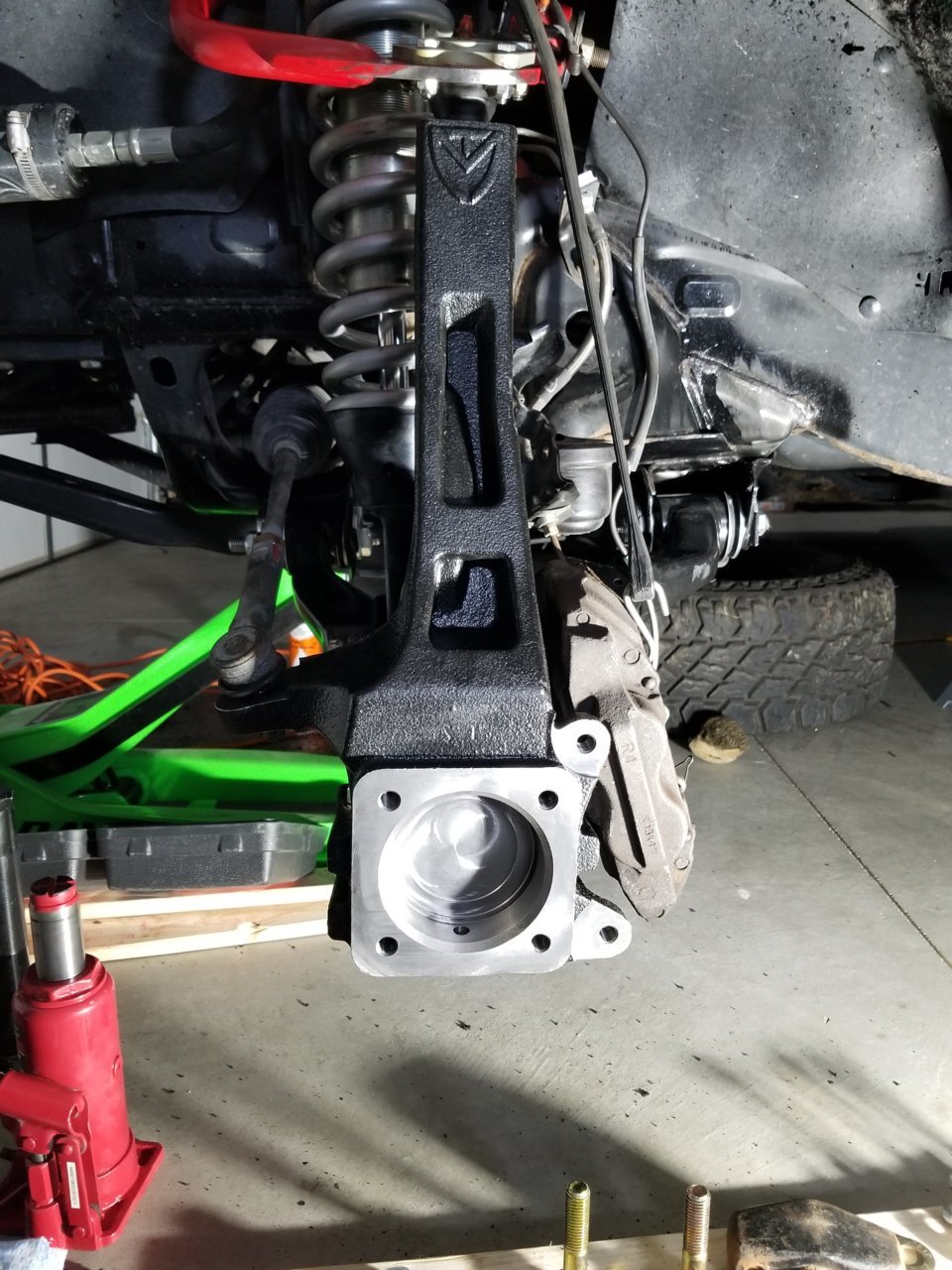

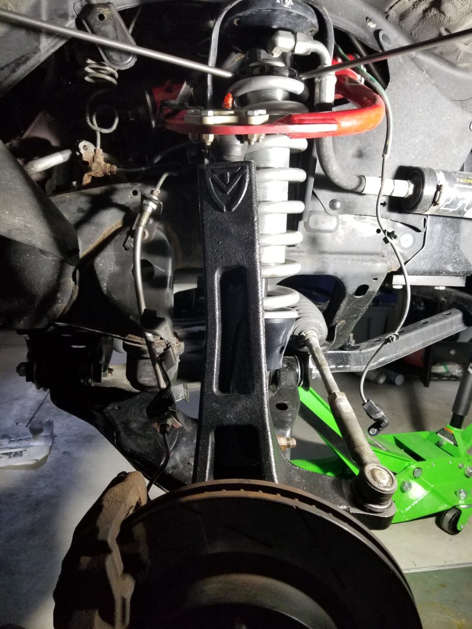

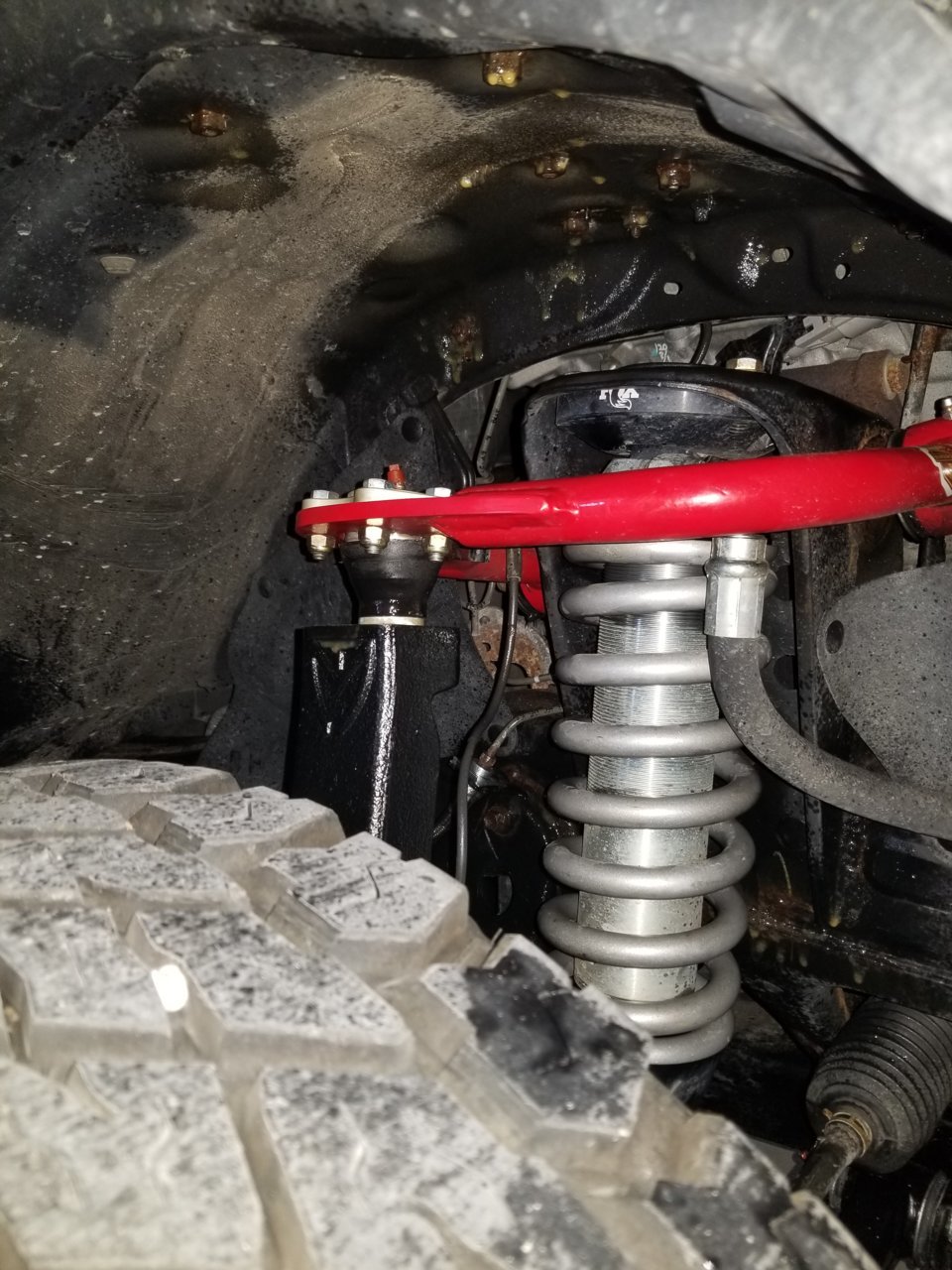

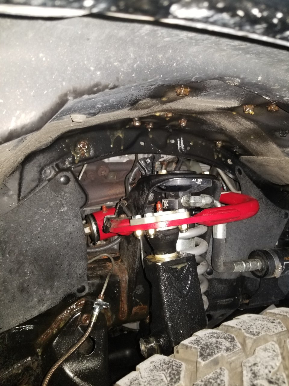

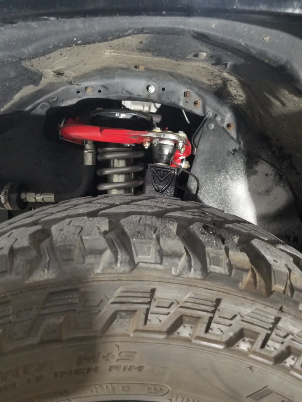

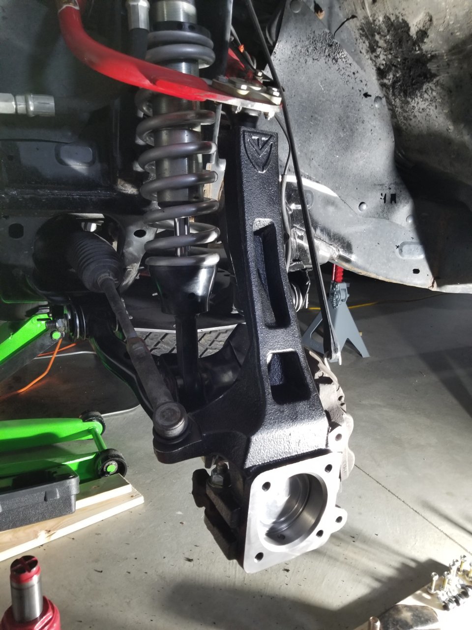

    Finally finished my install. Was very easy, only issue's I ran into were new bearing/hub assemblies didn't fit into the Maxtrac's, they were 1/4" deeper than stock, I also broke both anti-skid sensors lol.
    20210109_135353.jpg 20210109_135513.jpg 20210109_135533.jpg 20210109_112122.jpg 20210109_135916.jpg
    JEtaco03, Jimmy92870, Neemo and 3 others like this.

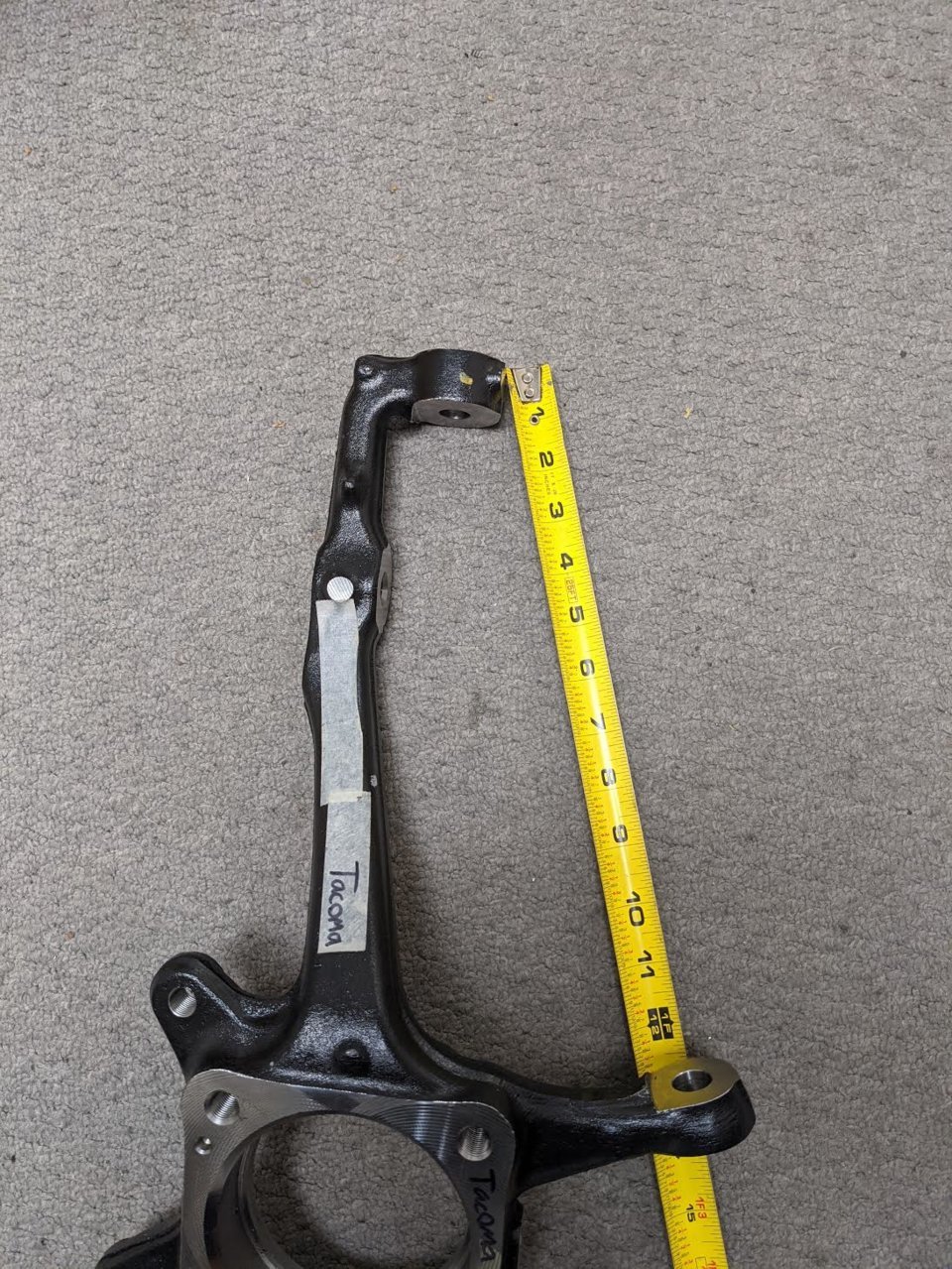

    Could some one do me a great favor and measure the maxtrac 4" lift spindle see picture attached for reference. It would help a lot.

    They should be about the same. The only thing you need to do is flip the tie rods upside down on the Maxtrac.
