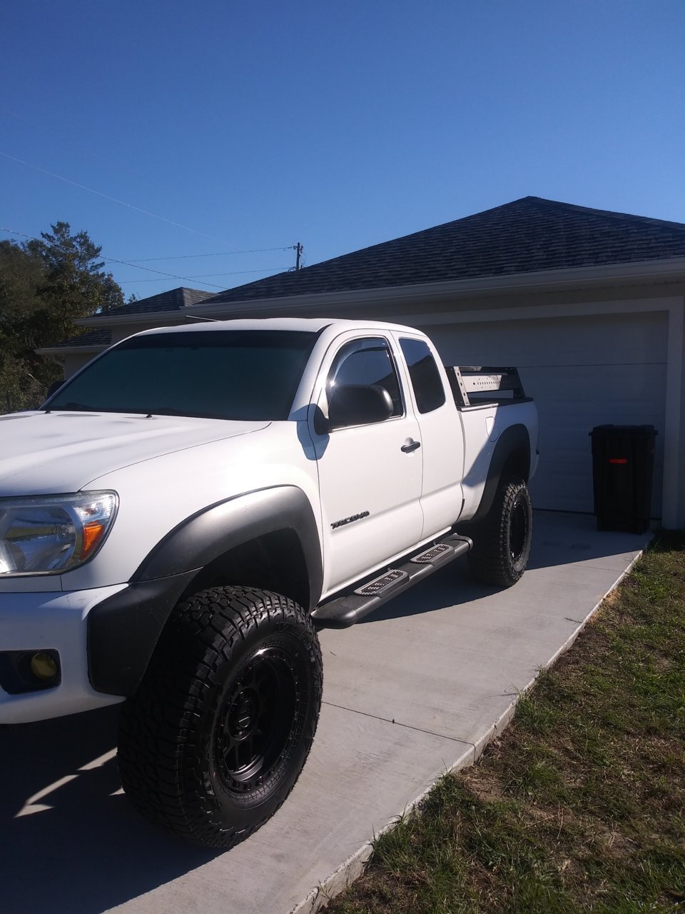

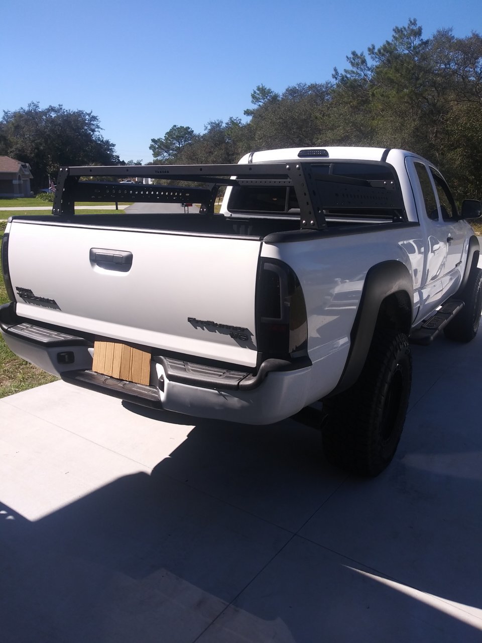

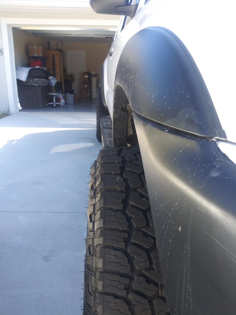

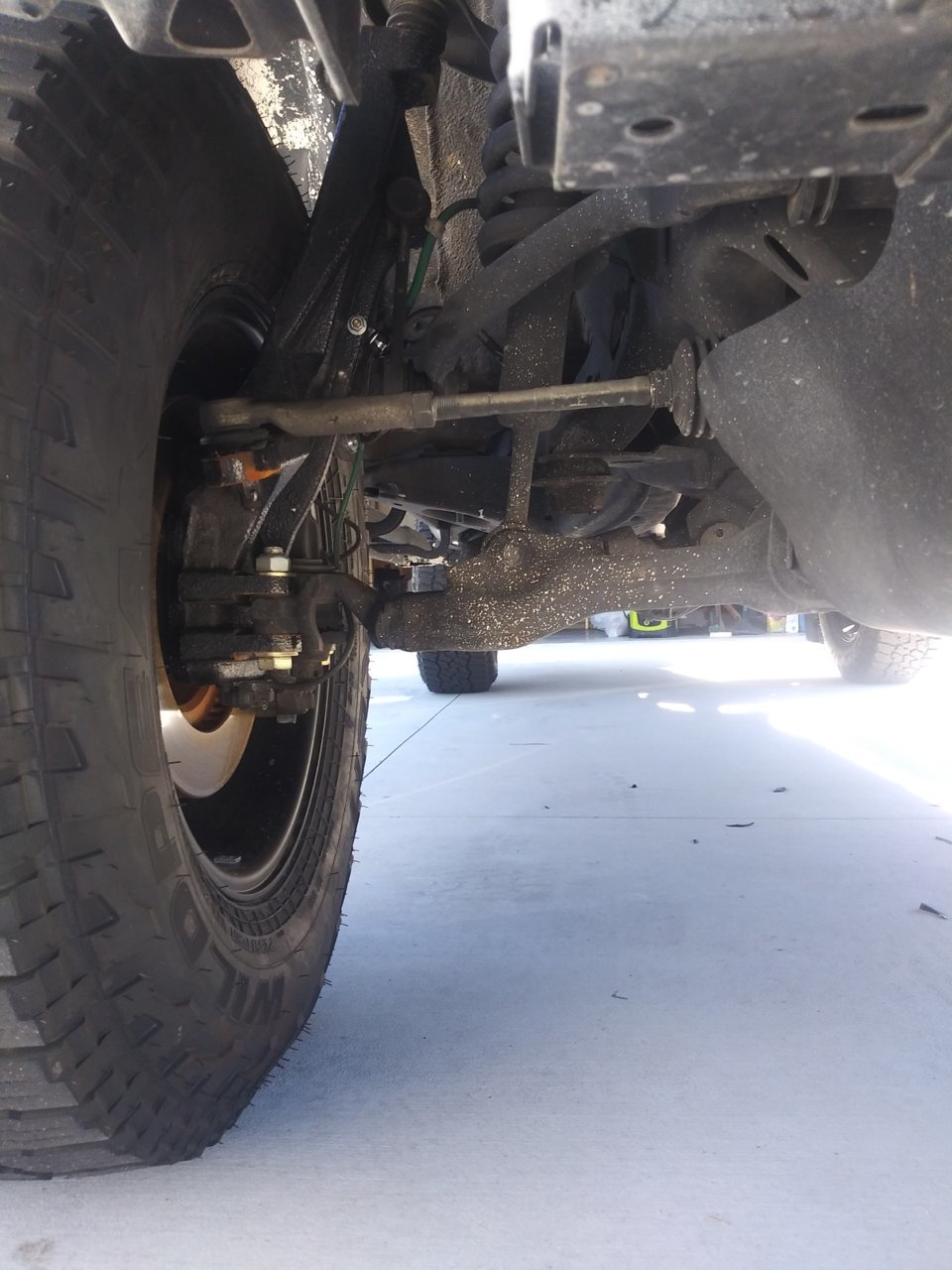

    Hello all,

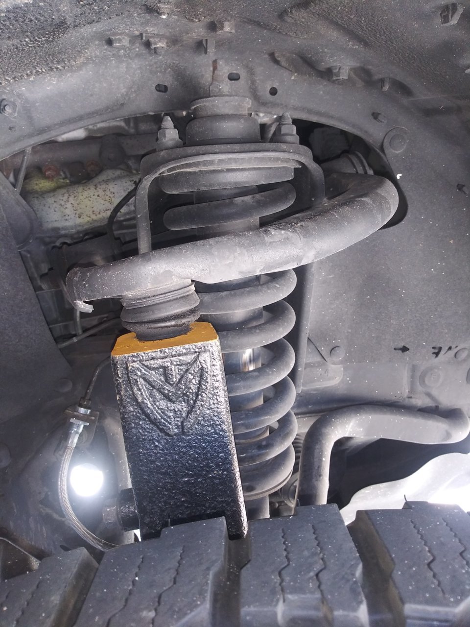

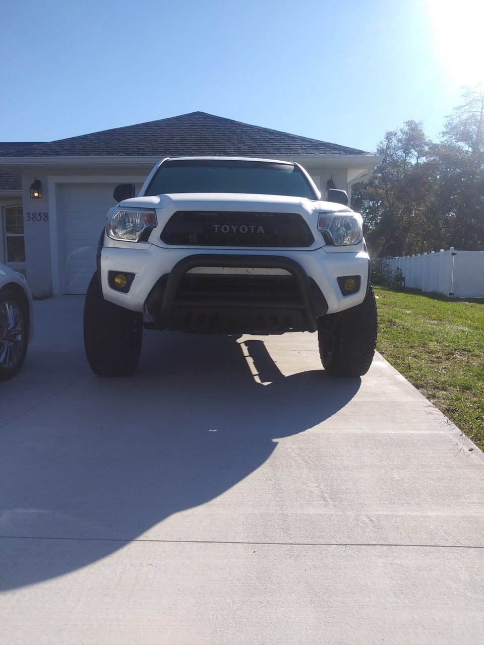

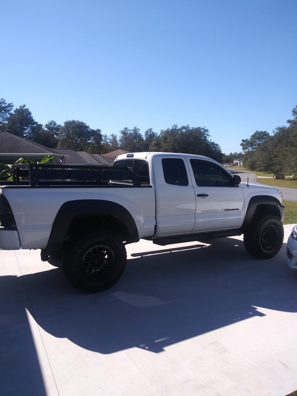

    I've been reading all these posts for the last 7 months trying to make sure I made the right decision on lifting my 2013 Tacoma Prerunner. So, I finally pulled the trigger and purchased a Maxtrac 4" spindle lift among some other goodies. This is what I bought: Maxtrac 4" spindle lift, extended brake lines on all 4 corners, OME nitro charger sport shocks, OME Dakar leaf pack with bushings, Ubolts, and CB drop kit - all from HeadStrong Off-road. I had this all installed from a lift shop in Ocala Florida for $650, which I thought was an excellent price.
    My tires are Falken Wildpeak AT3 285/70/17 and the wheels are 17x9 KMC KM544 Mesa 4.53 BS and -12 offset. I do have some rubbing on the inside finder, but I did some light trimming and it helped, it still rubs when I make a hard right. I do not have wheel spacers for the rear. The front tires stick out a little bit more than the rear, but it's not enough for me to install spacers on.
    I wanted to have a different look than other Tacoma's I see out here, so I bought a VooDoo bed rack. I plan on buying an RTT to go on top of it in the spring. I also bought some aftermarket taillights from Tacoma Beast and a TRD replica grille from the Truck Accessories guy.
    The problem I am having is when I drive, it's pretty rough. Maybe I should have bought KO2's, but it's too late now. Where I had the lift installed said if I have some aftermarket UCA's and front shocks installed it will drastically improve the ride. Is this true? If so which type of UCA's and shocks would you recommend? My funds are running low, but I don't want to skimp on the UCA's if I can help it. I was looking at JBA, OME, and Freedom Offroad UCA's. Freedom Offroad's reviews were somewhat indecisive, but the price is nice. I emailed JBA and they recommended the UCA's that keep the stock geometry the same, they cost $719. As far as the front shocks, I was thinking about either OME 90021 for a softer ride or Blistein 5100's. I would like to keep the front coils if I can.
    I sure would appreciate any help you guys can give. I love this forum, it has helped me so much already, I feel like I'm driving myself crazy looking for some UCA's. It was my understanding when I bought the Maxtrac spindles that my ride would be what I had when my truck was stock, which was great.
    *In a few of my pictures truck isn't straight, it kind of looks like my front tires are off. Also, I have some surface rust on top of my spindles I need to get rid of.20211116_092341.jpg 20211116_092341.jpg 20211116_092352 (1).jpg 20211116_113220.jpg 20211116_113247.jpg 20211116_113247.jpg 20211116_113234.jpg 20211116_113328.jpg 20211116_113309.jpg

    Truck looks good man. I would skip the upper control arms unless you put a taller coil than stock on when you lifted it. Doesn't appear to be higher than 4" up front but pics can deceive.
    Those nitrochargers can be a little pogo stick like I've heard. Save some pennies and get ADS with remote resi and clickers and never look back.

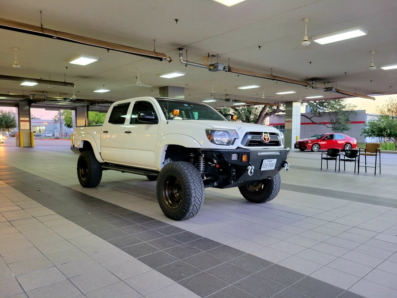

    Man your truck looks fine!! I've gone through 4 different setups on my truck.
    These trucks just shake. Mine has a the same thing you're describing ever since the first lift.
    Could see about a small drive shaft spacer (I was going to but never did)
    People spend years tracking down things that probably just gonna be the way they are on these trucks forever.

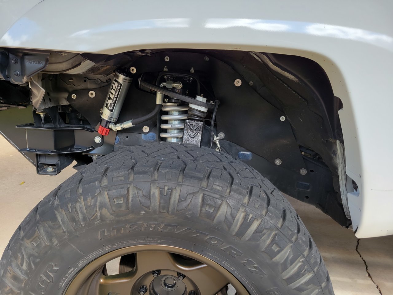

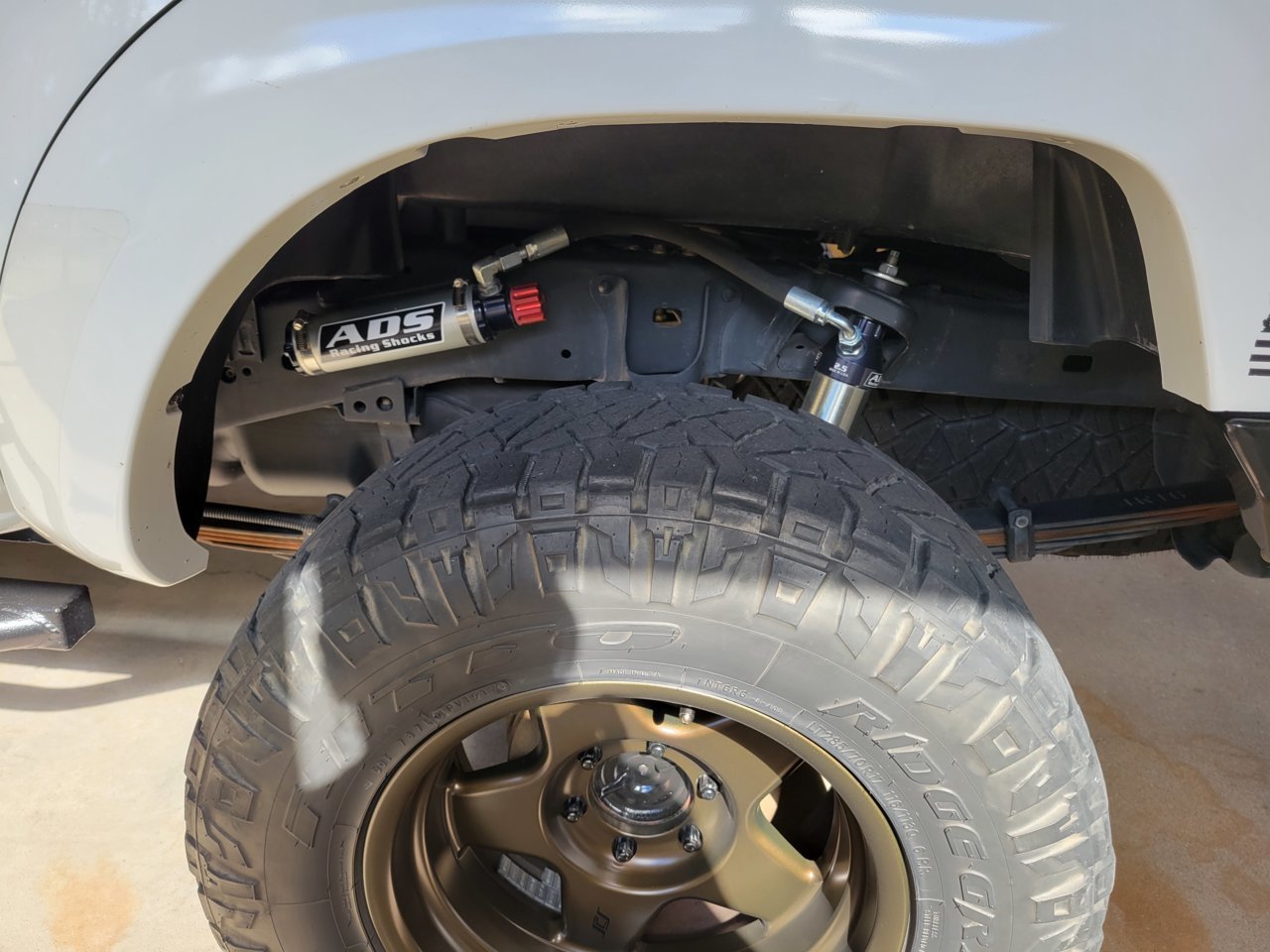

    That's where I got my ADS setup
