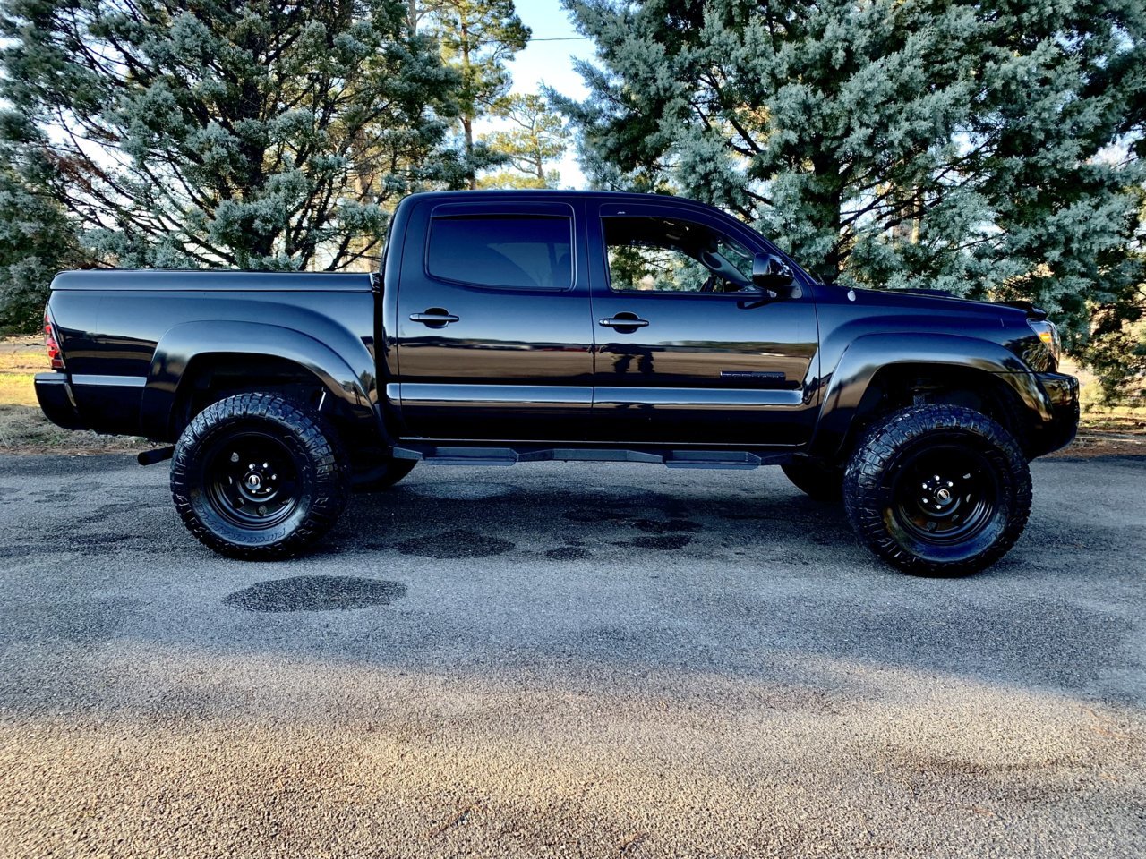

    ADEB8AE7-65B1-424E-AD17-D154E832AE64.jpg Finally installed my Maxtracs. No complaints at all, rides nearly the same as factory and looks great to me. Cheers!

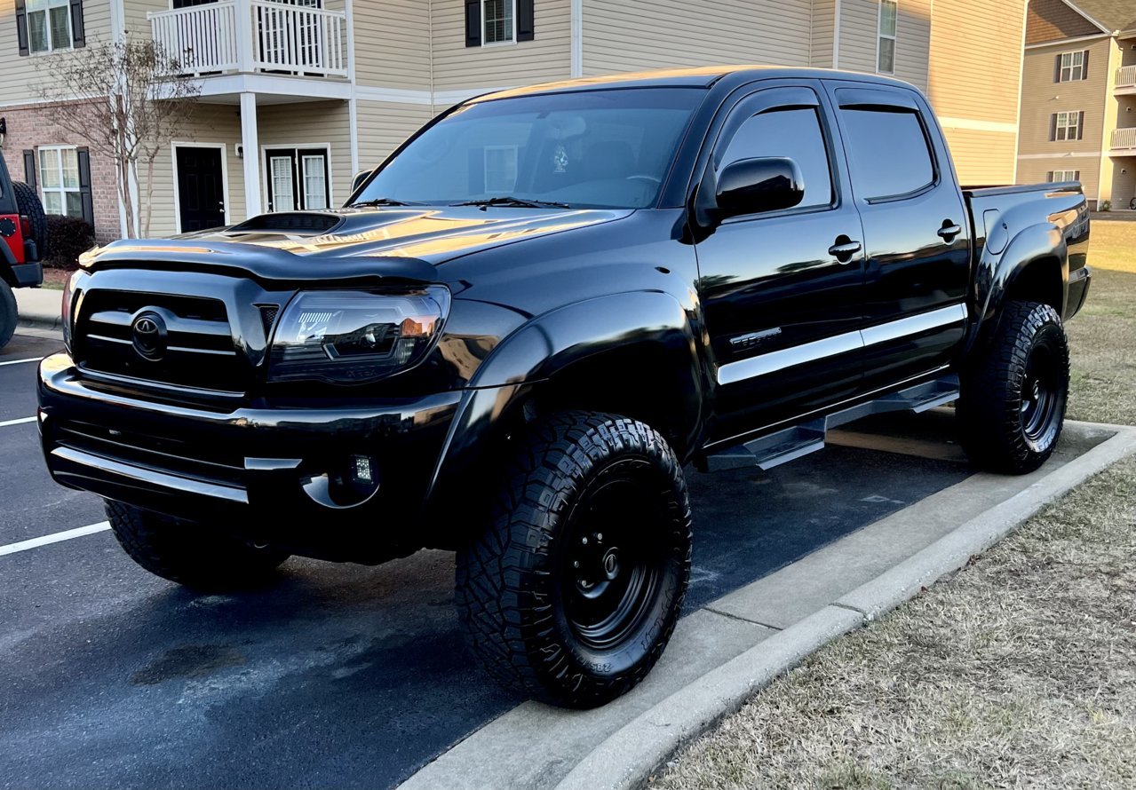

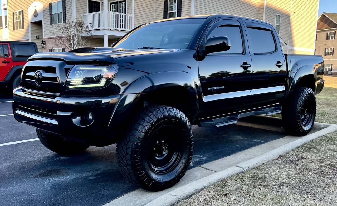

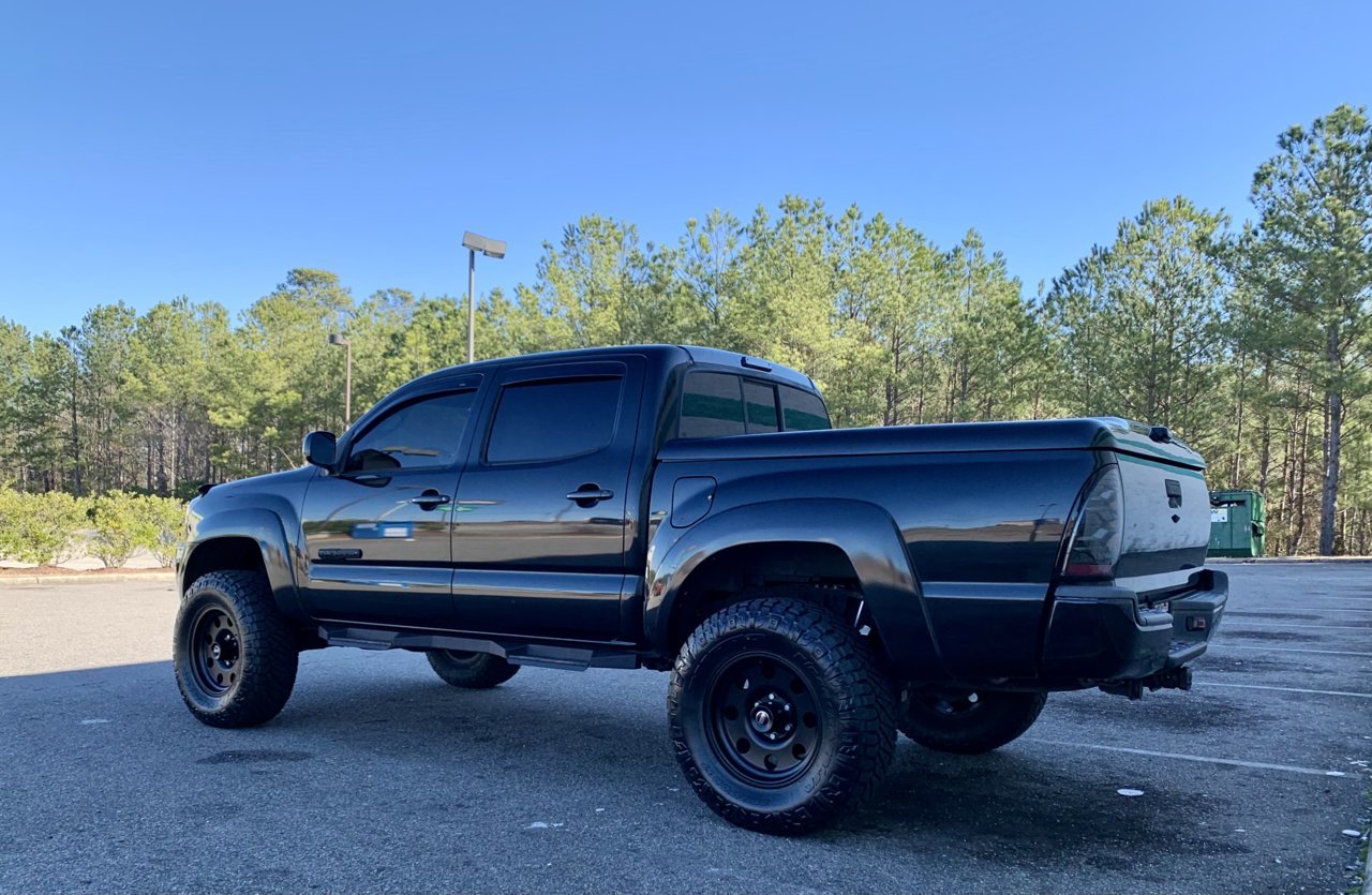

    0421680F-54BB-4C5B-8B42-5D69353592A0.jpg F06CBA69-BA36-4906-B878-CAA50B3DC922.jpg C306B405-7221-4505-885D-5F83FBFD9C67.jpg
    A few more for anybody who is on the fence.

    Unless you changed the shocks it'll ride exactly the same as factory. Looks good.

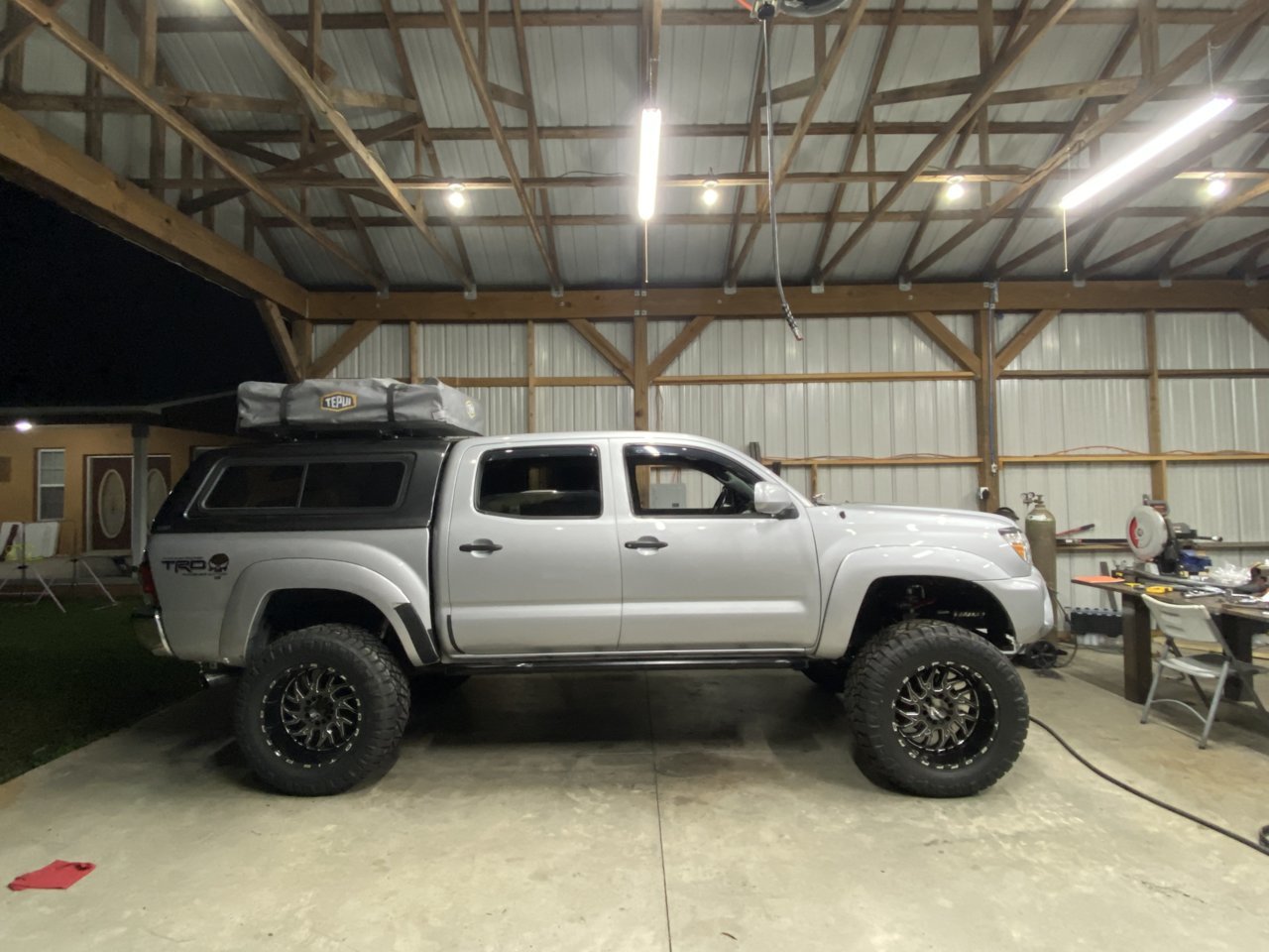

    1997 t4r has super duty axles, 5.13s locked front and rear. 3 link front with 14" kings. Rear 63s.
    Maxtrac, jba, and fox coilovers. Running 35s and he ended up putting bags in the back with his expo springs.

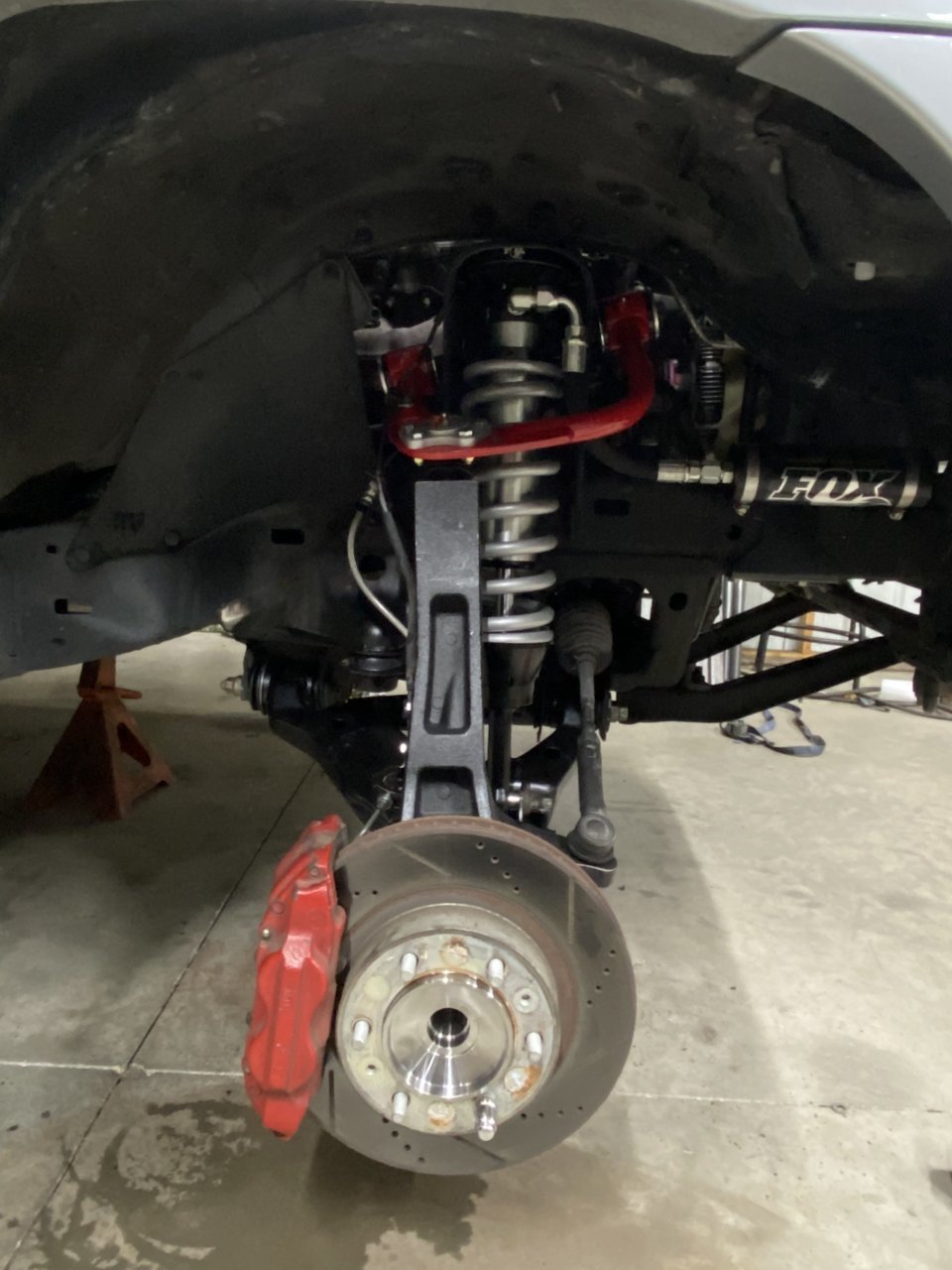

    -Maxtrac 4in lift spindles -5100's all the way around -Drilled and slotted rotors with ceramic break pads -Pro comp 1in AAL -17in wheels with a -6 offset (4.5 backspace) -1 - 10inch kicker comp (ported box)
    Glad to see the JBAs work with the maxtrac spindles, I've been eyeballing a set of coilovers but need upper control arms as well to clear the coils or they'll bind at full droop.
    @Timbo's Customs have you taken that combo out yet? (Wheeled it off road to test the sudden down travel increase from trail use) Any issues with binding, clunking, popping, ect... from the UCAs contacting the coil itself or from ball joints maxing out?

    No I haven’t. I do know when people ask about 3” lifts for their 4x4 models I always recommend jba or spc. I do know these will not hit the springs at all from al the others I’ve installed
