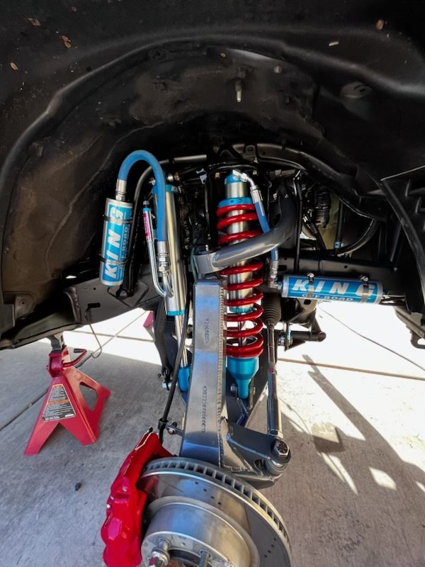

    Creeping in here with a Camburg lift spindle. Will bump to 37’s after the 35’s wear out

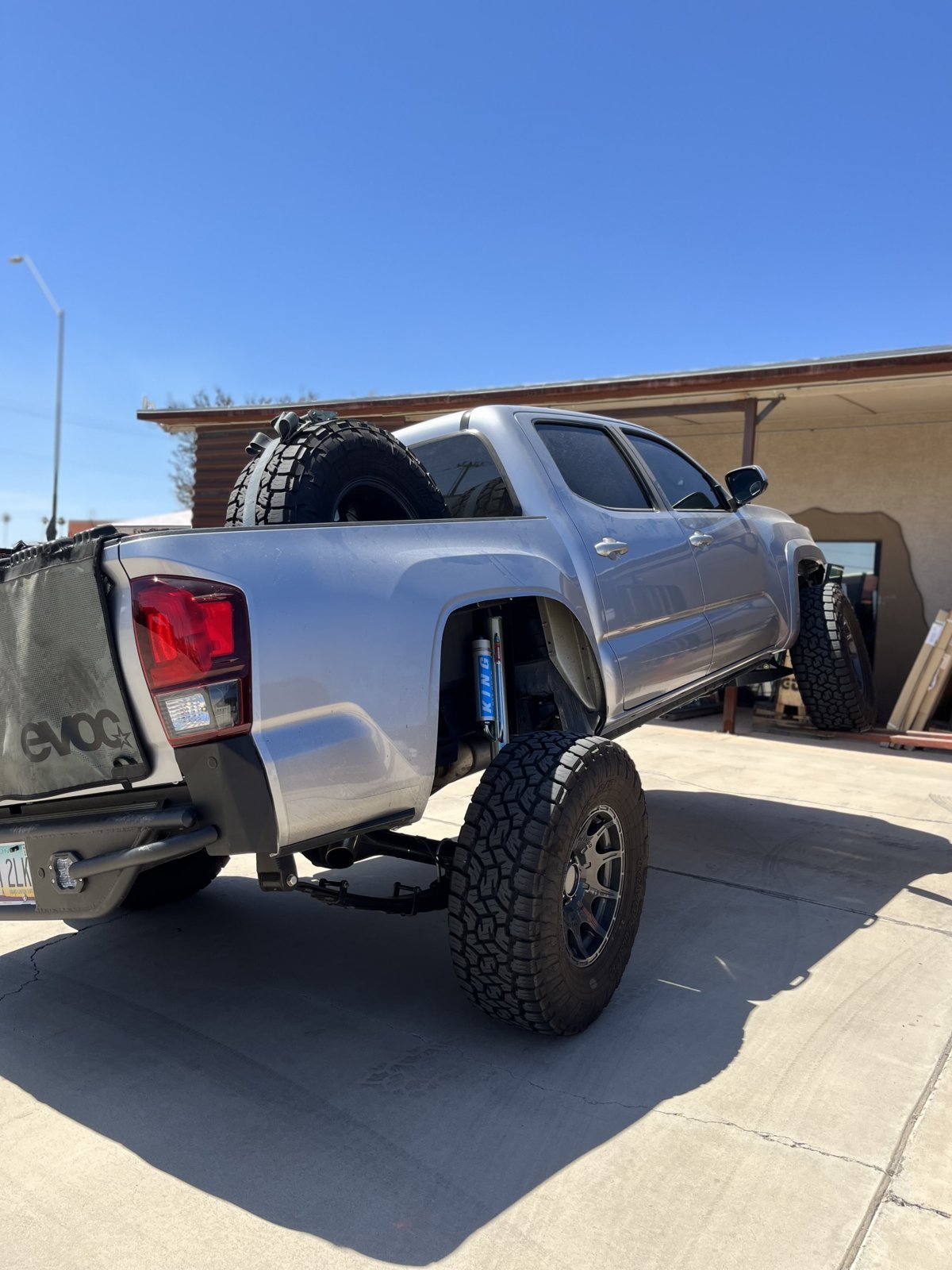

    3 2 leveling kit. 285/70/17 ko2s on 17x10 fuel beast
    4inch spindle with 2.5 coils, 3.5inch leaf pack with 2 inch blocks and airbags. Running 17x10 -18offset 33x12.5 km3s

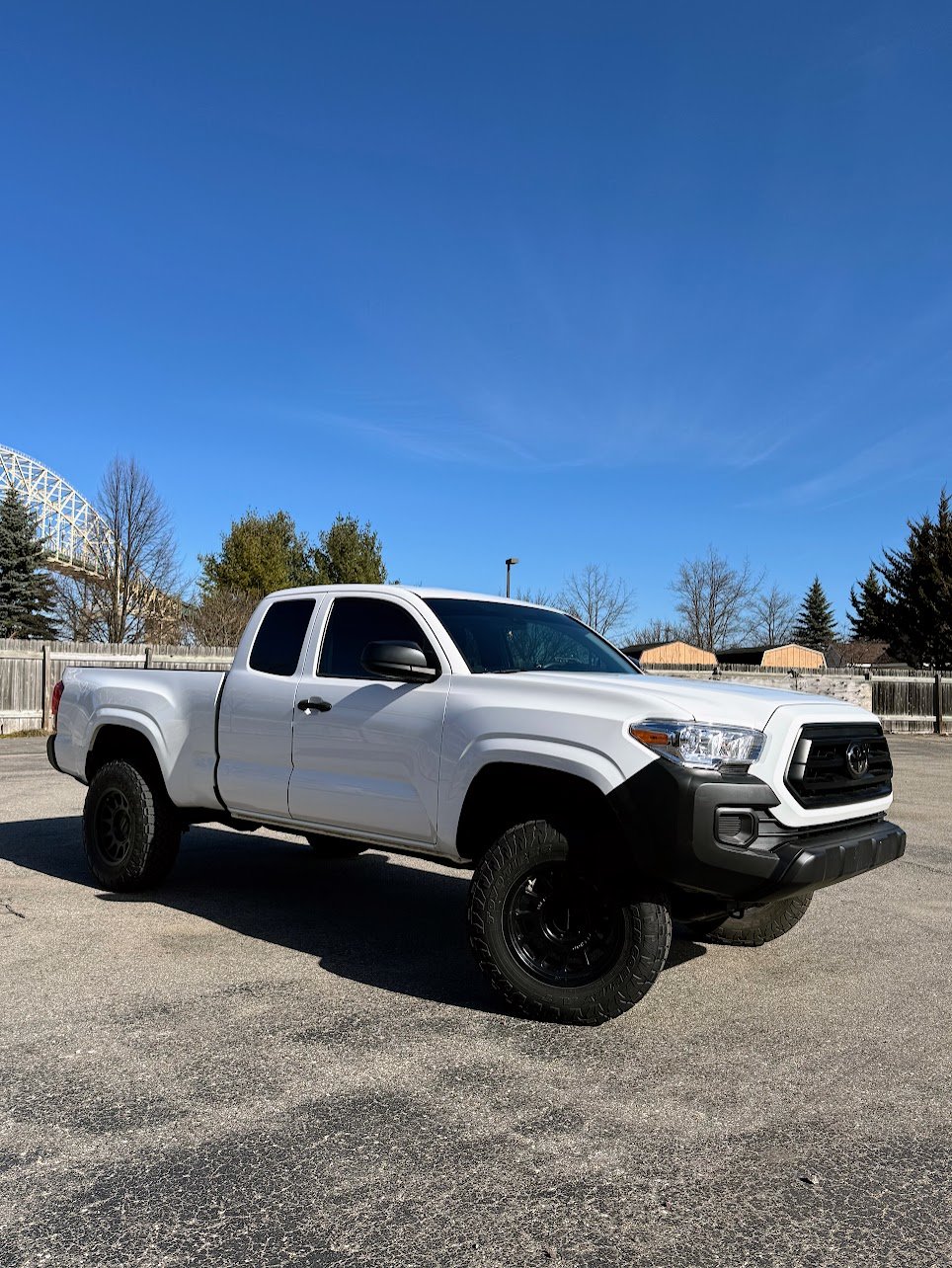

    Sorry to bump this thread. I own a RWD 3rd gen Taco. I currently have a 2/1 lift, its simple and tame for my 265/70 tires. Does anyone know if I ever upgraded to the MaxTrax spindles, would I need a new UCA or anything else besides a drivetrain spacer? What are yall doing to get a 3" rear lift? Leaf kit and new shocks? What size tires would work without any cab mount cuts, or is that pretty much mandatory with a 4" lift to fit bigger tires? I know these 265/70's would look goofy.

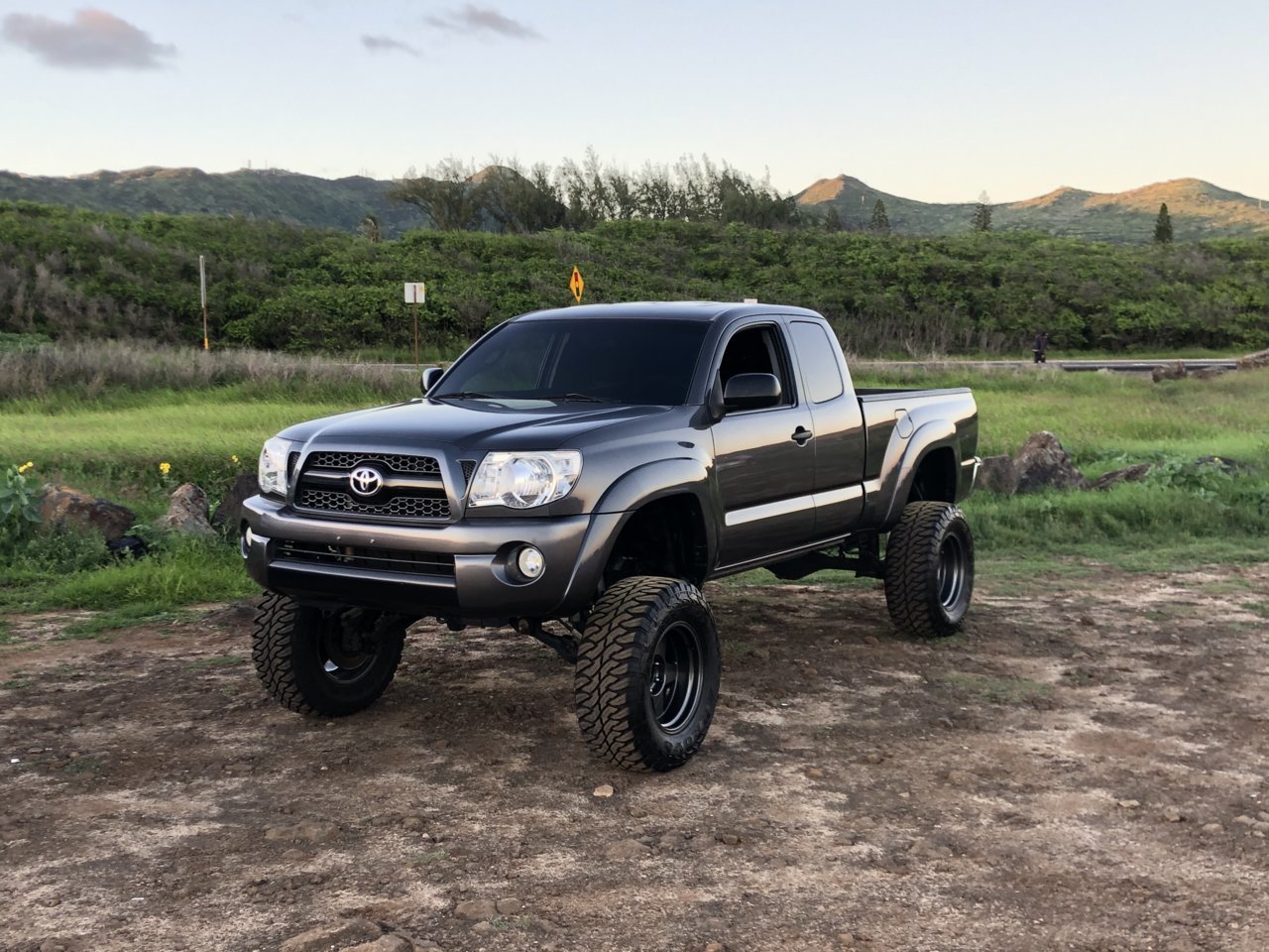

    IMG_1964.jpgJust got 35s put on today. The truck is super aggressive looking now!
  14. Apr 24, 2024 at 9:20 AM
    joms
    joms Well-Known Member
    Feb 8, 2024
    #443406
    54
    2021 Super White Tacoma SR5 2wd
    Bone stock baby
    did you put wheel spacers in the rear wheels? I might go this route with my 3rd gen sr5. Cleanest maxtrac lift I’ve ever seen so far.

    Wheel spacers: 1.25” front 2” rear. Since spindle kicks out front 3/4”.
