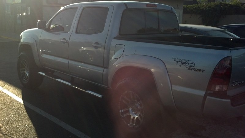

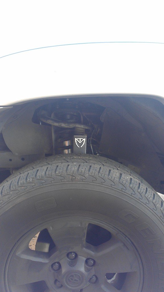

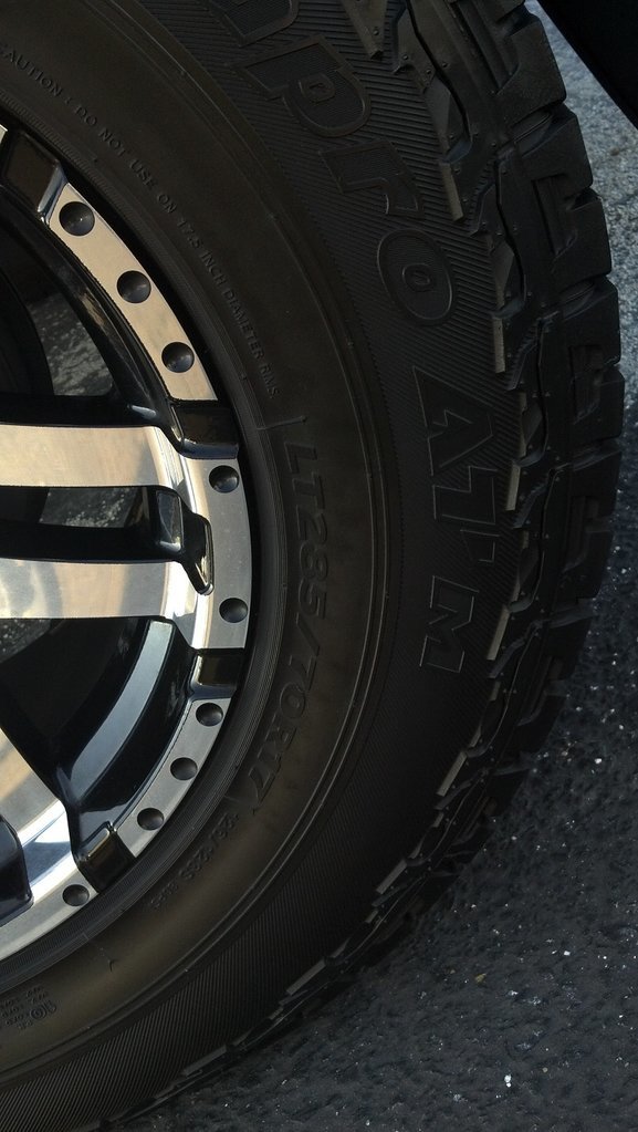

    This is the basic look that I like (apologies for the crappy image quality). It seems like a much smaller gap then most of the spindle images that I'm seeing. The tire size is also 285/70R17 (closeup better quality).

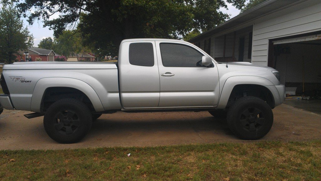

    Well these spindles aren't exactly 4". They are 3.75". But you could get some of the 883's or even with the bullies put them at .85".
    Here's my gap with 265's
