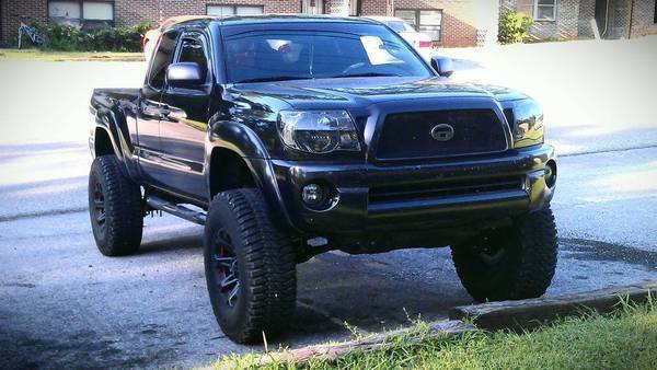

    Maxtrac Spindles, Bilstein 5100s set 0 in front with Eibach Springs, 2.5" block in rear with OME Dakar Leaf Springs
    Before
    After
    Sorry for bad picture quality

    sfcadams Retired Senior NCO
    Aug 13, 2011
    #61645
    1,439
    Dan
    Elizabeth, Indiana
    2011 TRD Off Road DCSB Prerunner Skeewped
    Nice. What's your setup & wheel/tire combo?
    Maxtrac spindles, Bilstein 5100s set at zero. 33" toyo tires, 20" XD series rims. 2/1/4" blocks in the rear with AAl soon to come.

    Maybe I should have asked this way...
    What was your before and after setup?
    2/1/2" spacers in the front with 2/1/4" blocks in the back
