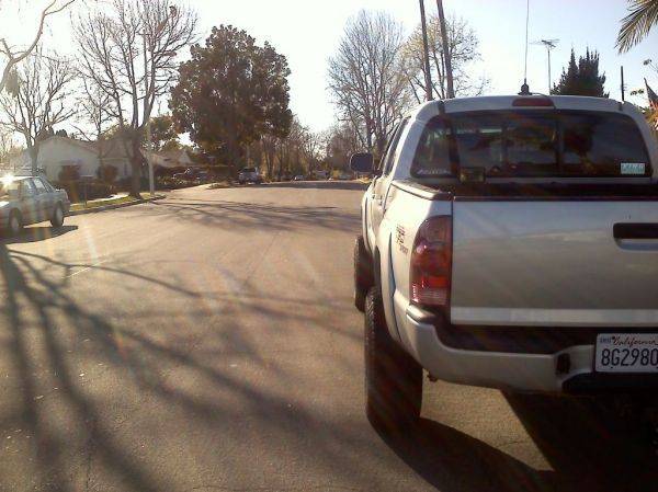

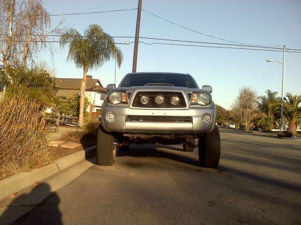

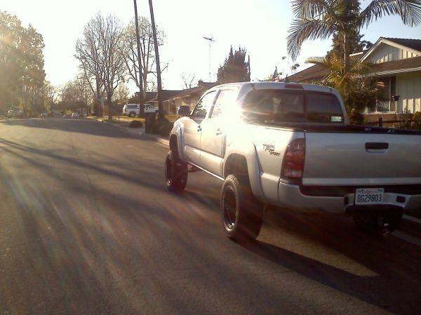

    wheels and tires
  8. Feb 14, 2012 at 9:48 PM
    #148
    markmatters
    markmatters [OP] Viejon
    Nov 4, 2011
    #66436
    1,311
    Mark
    Yuma, AZ
    2007 PreRunner
    nicee..and best color ever
    props.
