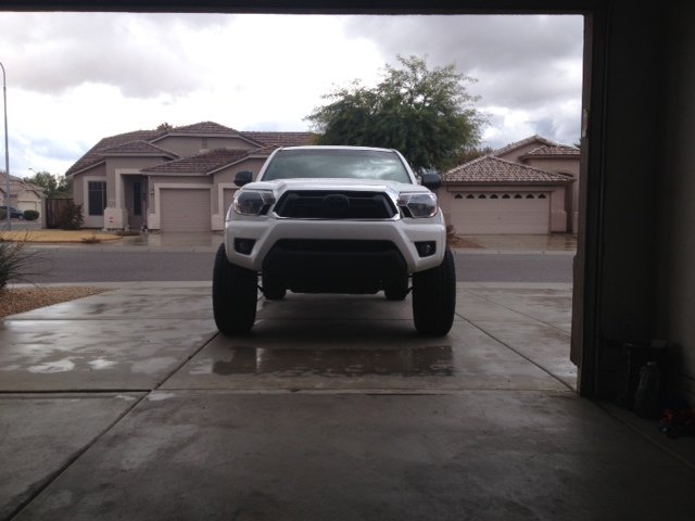

    Infamous Coating
    Infamous Coating Well-Known Member
    Jun 22, 2012
    #81129
    233
    Avondale, AZ
    2012 Tacoma prerunner
    4" Maxtrac spindles and a 2" block on the rear
    Here is my 2012 with Maxtrac spindles and 2" block
    A shot of the Fuel Revolver wheels 17x9 -12 offset
    285-70-17 Toyo AT2's
    Xrs-fsho likes this.

    What is the backspace on those wheels?
    Any front, head on shots to see how far they stick out?

    Infamous Coating
    Jun 22, 2012
    #81129
    233
    Avondale, AZ
    17x9
    -12 offset

    Thanks for the front pic. Remember what the backspacing was listed at?
  15. Jan 27, 2013 at 5:16 PM

    Usually 17x9 -12 offset 4.5 backspace

    No problem Chris. Kinda of figured that was what it was going to be. My 16x8 Mickey Thompsons are 4.5 BS with -12 offset.
    Trying to find out what backspace/offset wheels are out there that would kind of tuck the front wheels back in a little since the spindles push them out.
    Know what I mean?

    I hear ya. Not sure what would do it. Then you might have troubles with it hitting the spindle. I really like the look of the wider front stance. Just slings a lot up the sides.

    This...I love the stance..which is why I just added wheel spacers to rear to make it match
