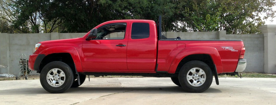

    that was just mt spindles in the front. raised it up about 3.5"
