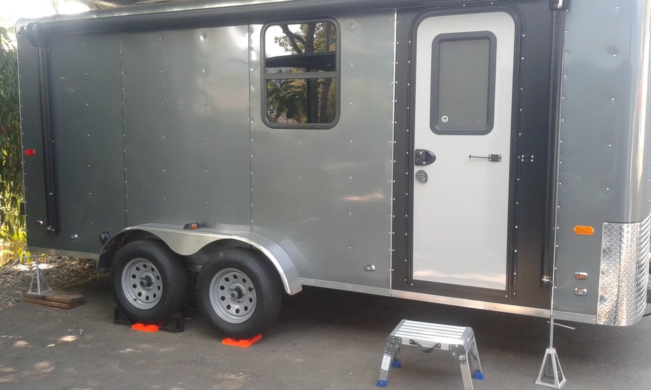

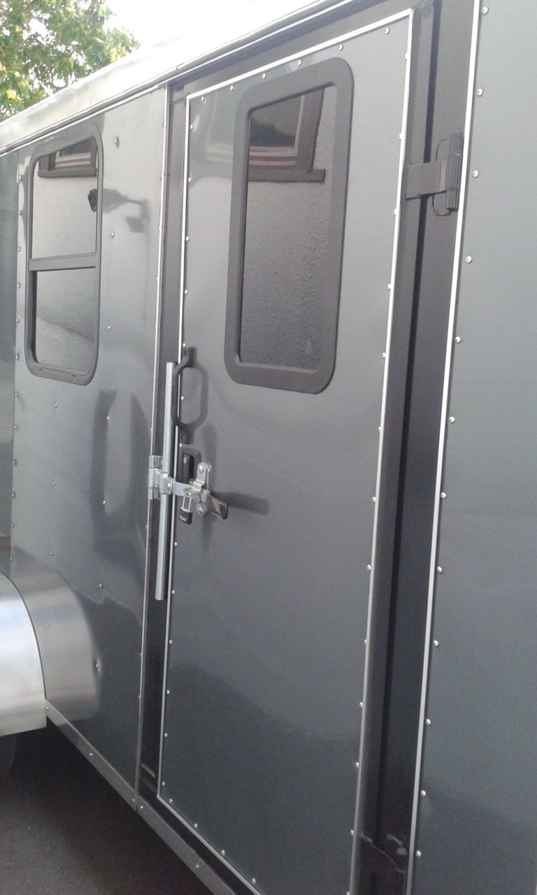

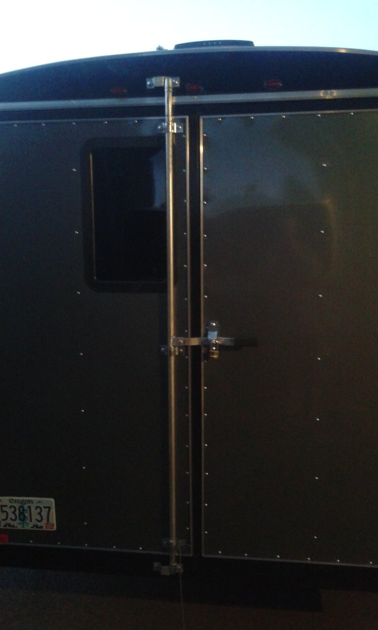

    I changed out the door assembly. The original door didnt seal as well as I wanted and would interfere with the awning due to having square edges. With the RV door beibg narrower with radius corners, it will have enough clearance to mount the awning rail right above the roof trim. I ended up cutting 2" off the door height to get it to fit in the original opening.
    I had put a tinted window in the original door, but it is a little smaller than the window in the new door, so I will put it in the rear curb side door to match the one that is in the rear street side door.
    I like these windows because they fit between the ribs in the doors, and they have built in black out blinds.

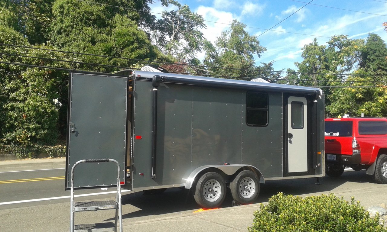

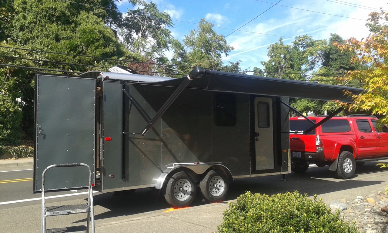

    Awning on.

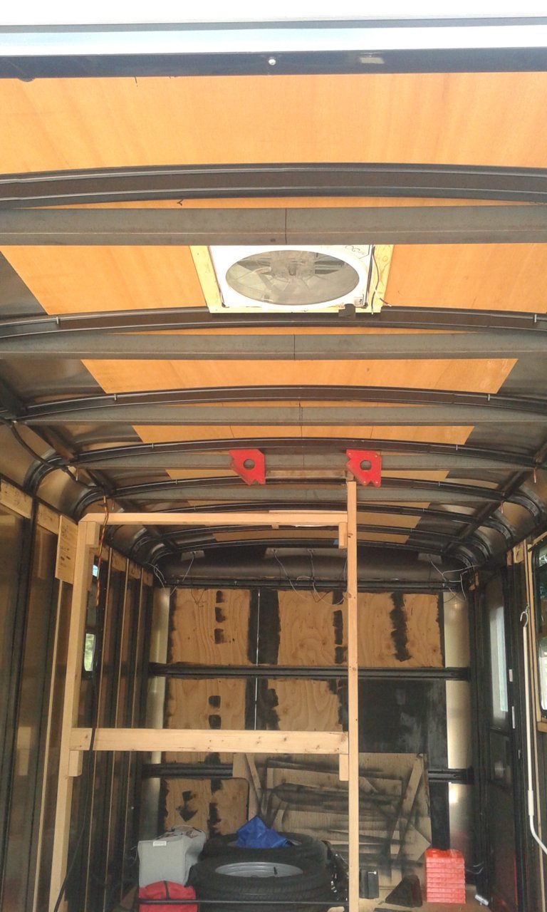

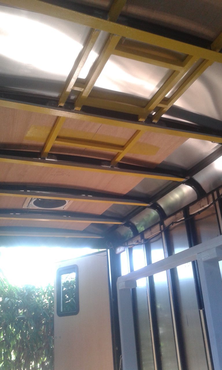

    I got 5/8 of the drop ceiling raftors cut to size and held up with cleco pins. I give the neighbors sundays with no tool noise, so I will cut down the other three and make the attachment parts on monday.
    Also, I made the roof reinforcement for the AC today. Just need to weld the mounting pads (currently held on with cleco pins) to the raftors.

    I am doing a drop ceiling from front to back. This will give me the ability to strengthen the roof while also allowing me to insulate the roof and give me a place to run wiring. I am going to use a large skylight above the shower for headroom. It will be in the drop ceiling, but not go through the roof.

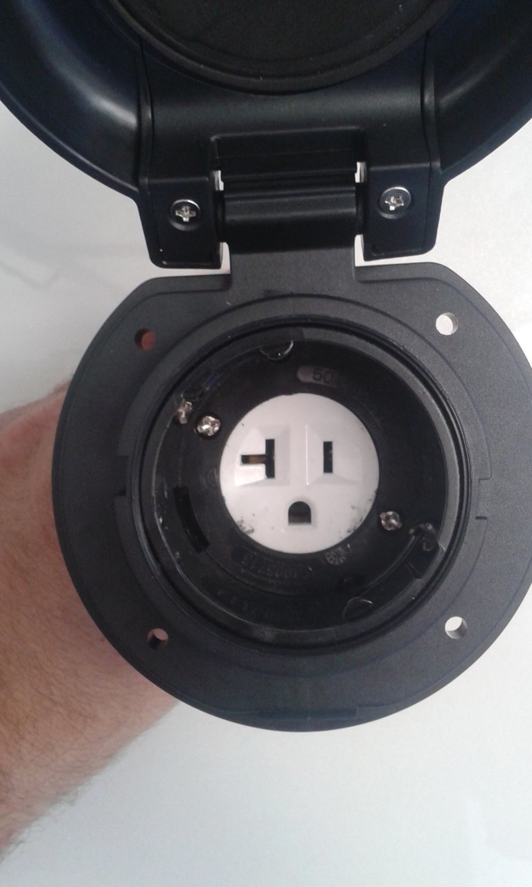

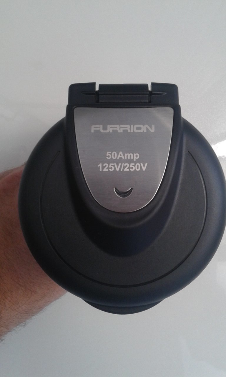

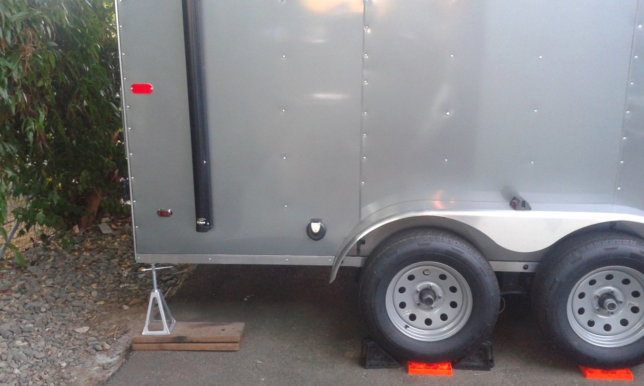

    Had an extra inlet. So, I turned it into an outlet.

    Mounted here because it will allow use of the fender as a table and it is low enough to be inside the battery box cabinet/bench box that is going to be on that side.20180903_192118.jpg

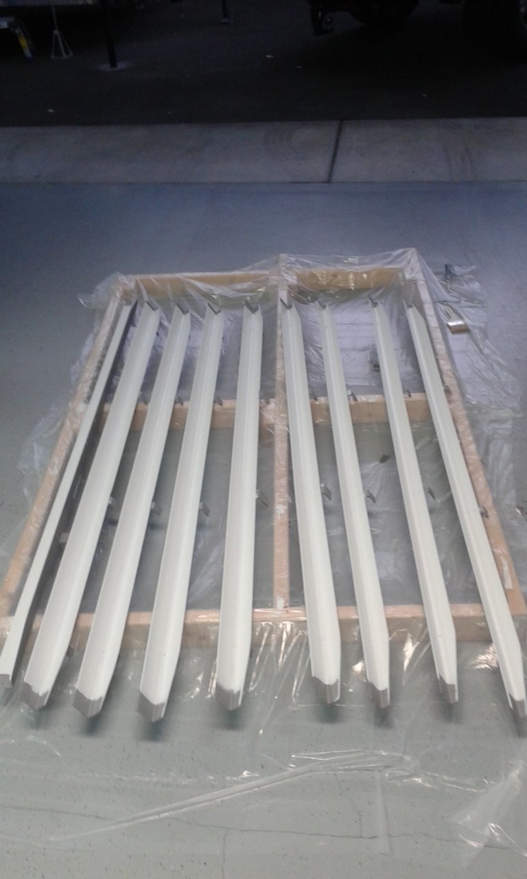

    Taking the roof bow supports to the sandblaster tomorrow. When they get back, I will paint all but the weld points. Hopefully I will get them welded in this weekend or next week, then I will start the spray foam insulation process.
    Yesterday, I trimmed and glued the floor plywood down and finished cutting the hole for the second back window. Couldnt install it because the screws are MIA.

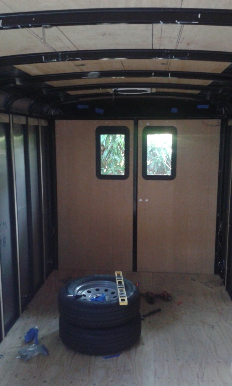

    Matching rear windows...

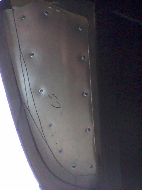

    Made filler panels for the crap the factory did up front. This will give a place for insulation and sealant to seal the gaps.
    The black lines are the edges of the floor and the steel rib.
    Also added area (white) lights. 3 on either side. I may add more.
