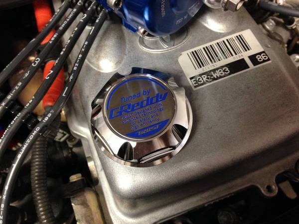

    Well, I added a couple things to the 4Runner recently. First was a GReddy oil cap a few weeks ago - looks pretty sweet under the hood, and it's made in Japan, so you know it's awesome (plus it adds at least 15hp...lol). I got one of the last ones on closeout for $30, which is an awesome deal IMO.

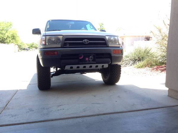

    I also installed the sport skid plate from the 2001-2004 Tacoma on my truck yesterday. It is a straight bolt-on for 1996-1998 4Runners, but for 1999-2002, you need to make some bracket extensions to accommodate the fat-lip bumper. I got it from toyotapartszone.com for about $100 - not too bad IMO.
    Next mod will be a URD O2 Calibrator to allow for proper fuel mapping with my turbo setup. Then I might increase the boost to 6 or 7psi (if I can keep the AFRs down) and see how she runs.
