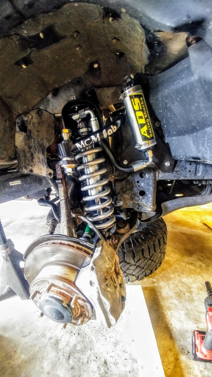

    Now its time to start tearing stuff off! Of course you have to get the truck up on jackstands and the wheels off. Make sure you get the truck up HIGH> you're about to gain like 4'' of down travel so getting the wheels back on is going to be tricky. This task is becoming a bit of an issue with me with the 35s and long travel now...ha
    [​IMG]LongTravel Install-12.jpg by Monte Nickles Photos, on Flickr
    [​IMG]LongTravel Install-13.jpg by Monte Nickles Photos, on Flickr
    Next remove your skid, this can be different for everyone be it different models ect., but I figure if you can't take off the skid you shouldn't be doing this anyways. When I did this, I discovered a broken lower mount. Bummer. Ill fab up some new stronger mounts later. The skid had some lovely scars on it though!
    [​IMG]LongTravel Install-14.jpg by Monte Nickles Photos, on Flickr
    [​IMG]LongTravel Install-15.jpg by Monte Nickles Photos, on Flickr
    Now its time to remove the spindle. I did this the same as removing a CV but I just added in removing the UCA too. So, start by taking the outer CV nut off, this is where the 36mm socket comes in and breaker bar. Or Air gun..ha
    remove the cap

    Now for coilovers!
    [​IMG]LongTravel Install-74.jpg by Monte Nickles Photos, on Flickr
    pretty self explanatory..
    [​IMG]LongTravel Install-75.jpg by Monte Nickles Photos, on Flickr
    To attach the resi's I went and got 4 4-6 inch hose clamps and I found these super cheesy rubber pads. They have sticky tape on the back of them and are supposed to be for steps or something. But turns out if you cut them in half they wrap perfectly around the resi's! Now I didn't really do this to protect them from the elements so much, but mostly from the hose clamps themselves and the frame. The very nice coating that ADS does on their shocks will be more then enough to cope with the elements.
    But my resi's will always look nice. Was cheap and easy, and kinda makes em look cool....
    [​IMG]LongTravel Install-76.jpg by Monte Nickles Photos, on Flickr
    [​IMG]LongTravel Install-77.jpg by Monte Nickles Photos, on Flickr
