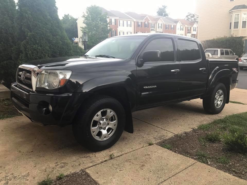

    as some of you know that followed my 3rd gen build, I ended up selling it to save a little money and I bought a house...
    that being said, awhile ago I bought a 100% bone stock 2009 Tacoma Double Cab Short Bed TRD Off Road... the mods / build commenced.
    I found a fellow member that wanted to return to stock, ordered some new parts, and kind of pieced this thing together. I hope you all enjoy it!
    the day I bought it:
    19959202_1334520936669178_21041656416969_6d74d8f4ebbcdb0aa3975787c41b8c378d6ccb30.jpg

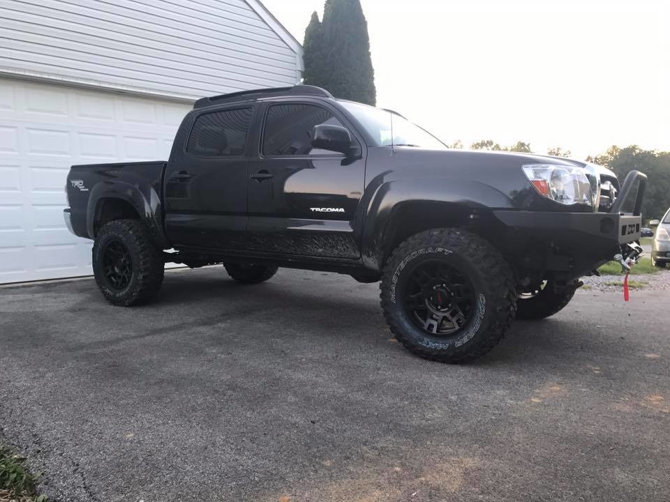

    As it currently sits:
    23561688_1459884517466152_77901473163570_161634f9bc0d989e0b266076f1043032c3ea79e1.jpg
    "old" Tacoma and my new one:
    19961289_1336477549806850_49682273413541_1b8986e95d0dcd2718911200d9f909047e4ea06e.jpg

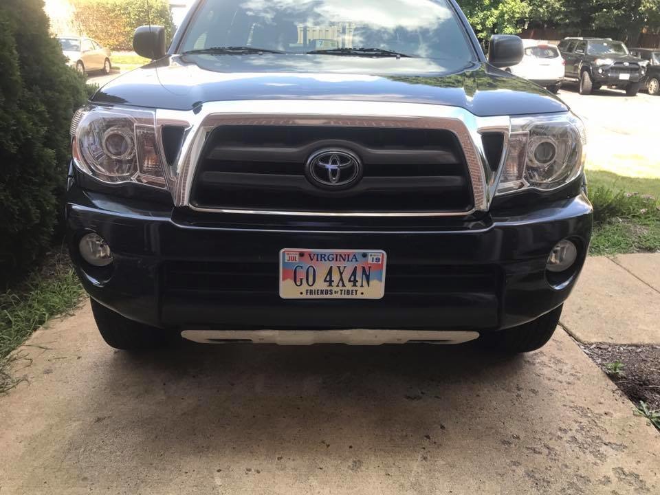

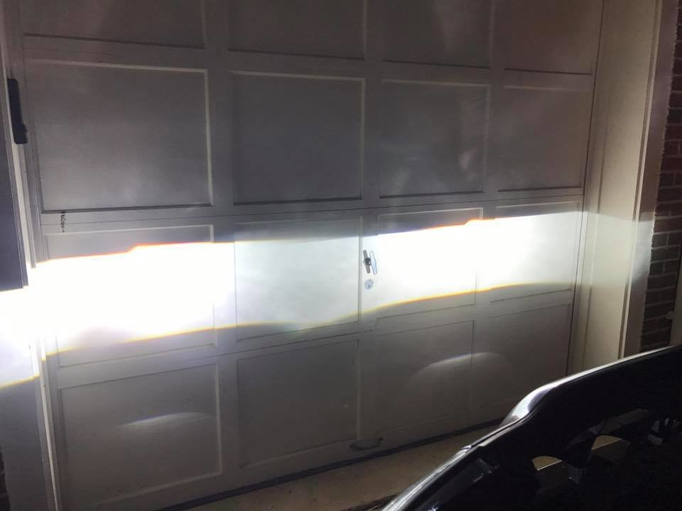

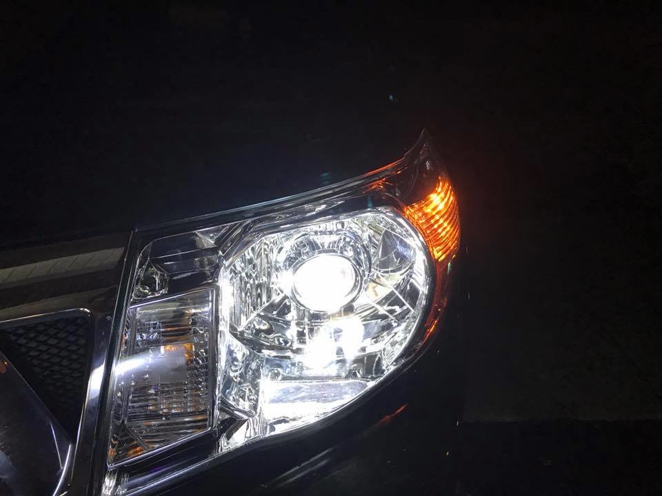

    first mods: projector headlights and HID kit
    20108203_1337477989706806_39723446464526_3b12d780cc09e8bf770ddaa2ed1cc7ac864b57d6.jpg
    19959431_1337477986373473_49848838147664_611576d8f0f3e21977d148ad4176b29137a4776d.jpg

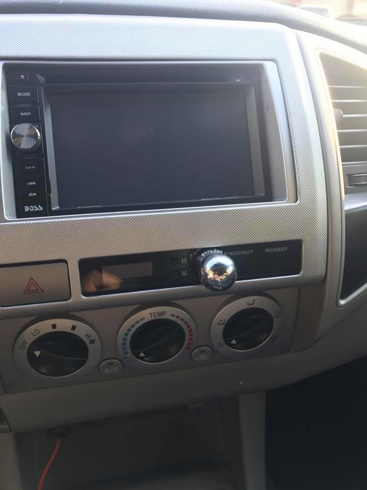

    DVD / Navigation / Radio and Magnetic phone holder
    19990347_1339433159511289_49852813340713_a91d276211695a054fe99a06eaa48bf499c5d6cd.jpg

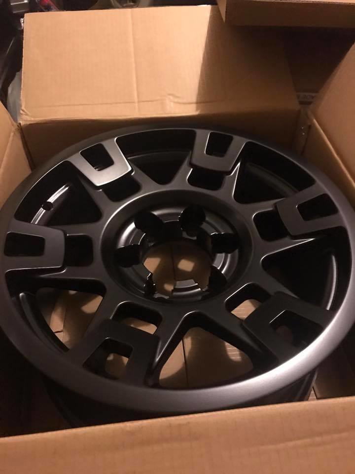

    wheels showed up!!!
    20108685_1341277705993501_73925293565268_08cf8cb900cab5a2a53c5a68255bcabd1c964ba8.jpg

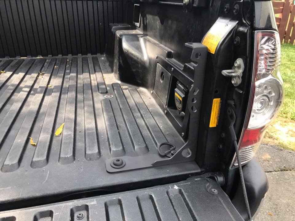

    Bed Stiffeners
    20374773_1352766471511291_38746951978657_053d654eb909099ca1129b26f8369f521d07b994.jpg

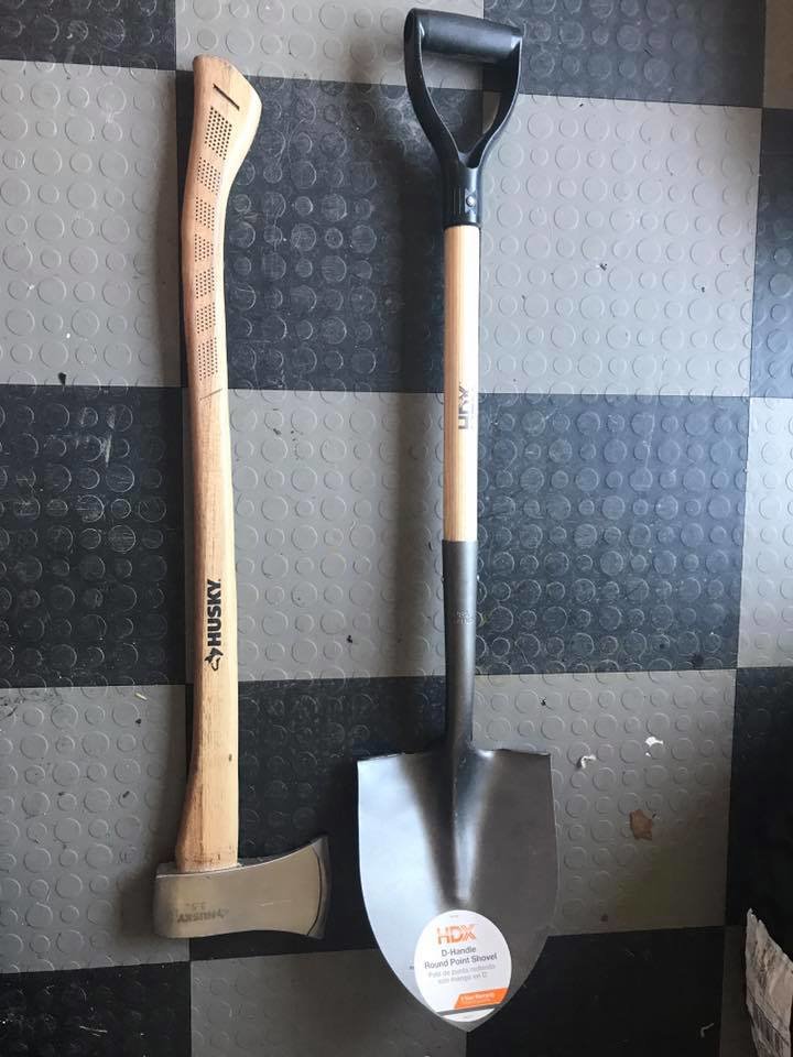

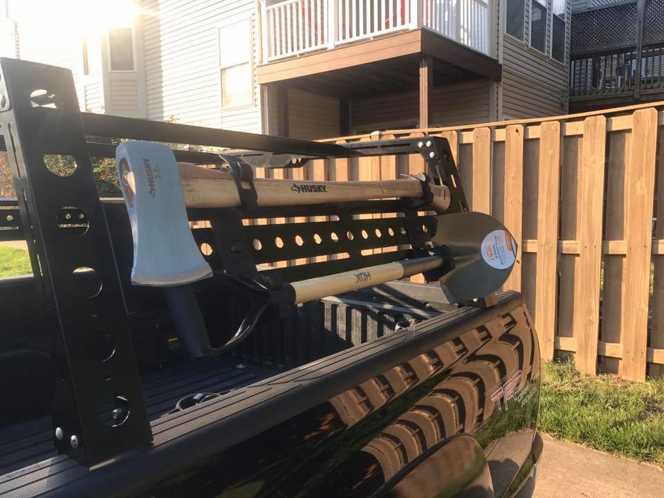

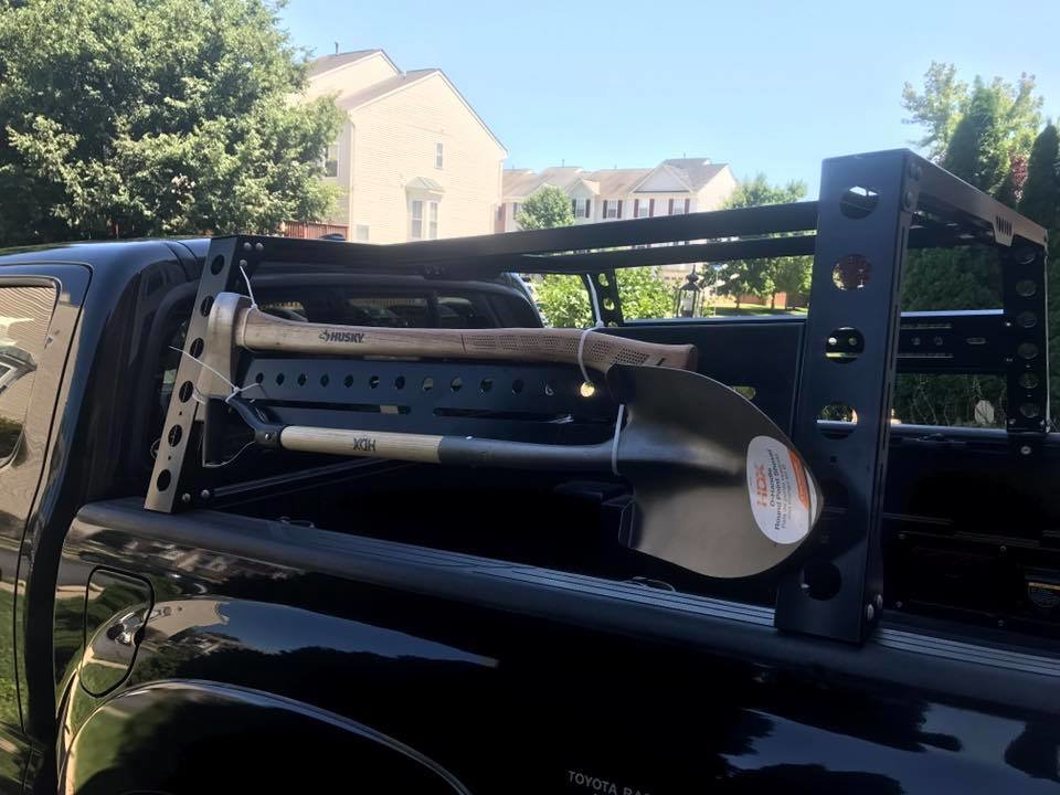

    tools to be mounted on the rack
    20525205_1352766478177957_45669532109464_e6c8707cd0efe4b3a0c4d8028e793c5a980b9fac.jpg
    Zip tie mock up (that should hold it ;) )
    20429662_1352826514838620_27663960722538_7b886fbec3b4679f95d9920c118058c5b7ab0bac.jpg

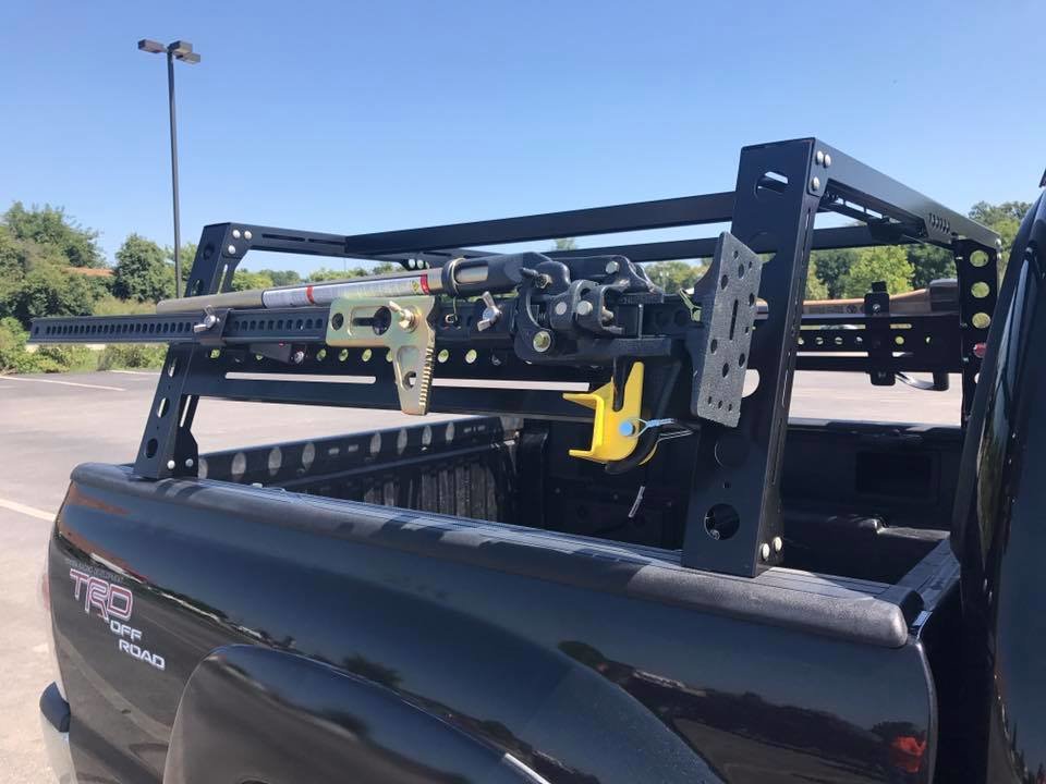

    Quickfists / Tool Mount done!
    20597324_1354036221384316_12762686099374_95f9c1bc7b8c71429a6ea9d4be69d153f15ee8db.jpg

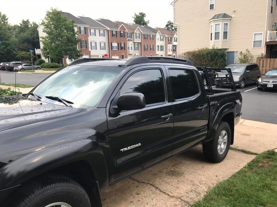

    OEM Rack installed and Chrome Door handles removed!
    20604535_1356994757755129_42368459169225_1d006f3c6ea2301a4a11cdca0a17f6b6bdc666ca.jpg

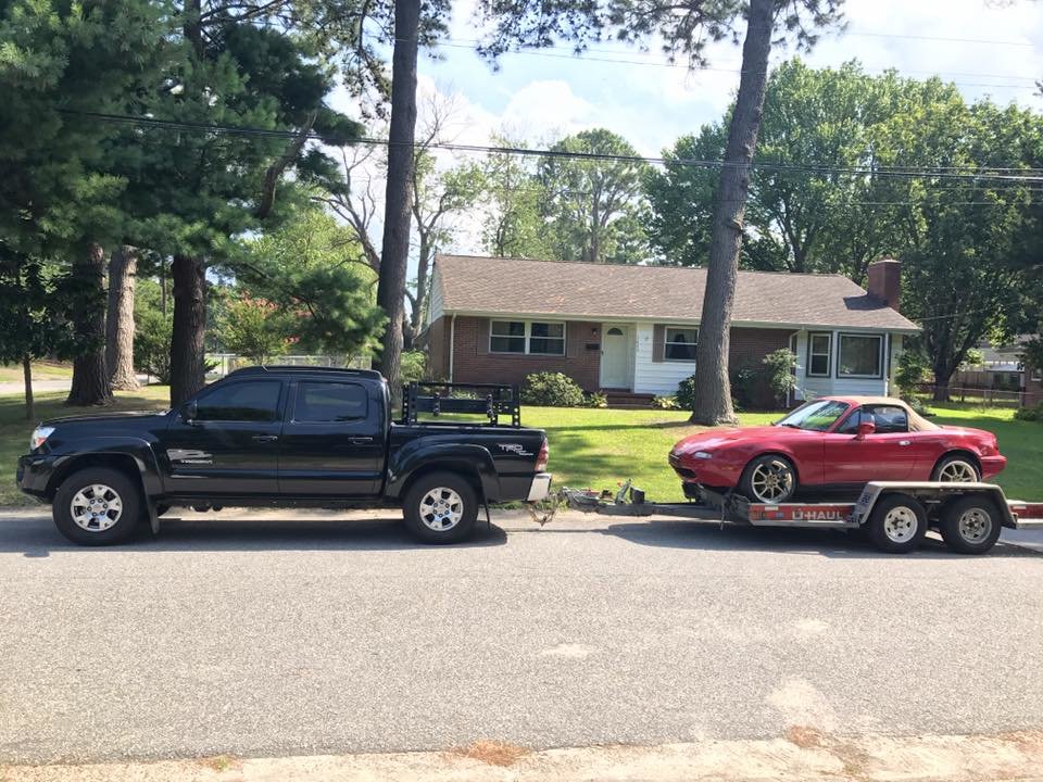

    picked up a Daily Driver!
    20597195_1358831100904828_24187453684600_d5f3c31f3f0e9fd52897a0dc4b9ef557995360c3.jpg

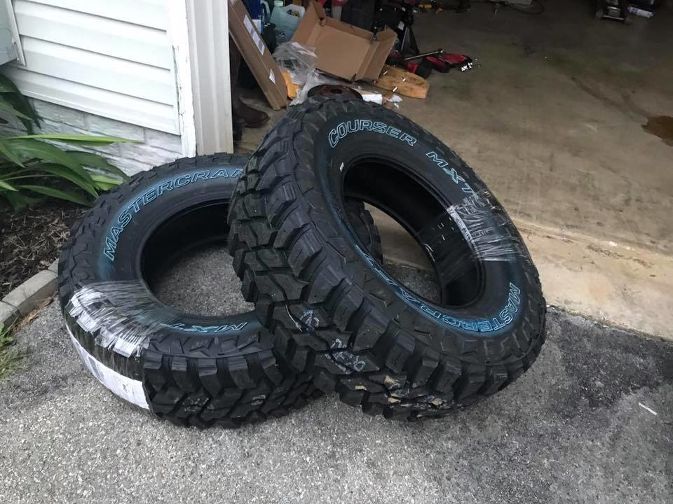

    Tires!!!
    21230829_1383037471817524_19613919025051_4d1f1e2942aa7c99065764dc4a816a0518a49155.jpg

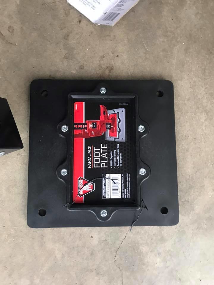

    picked up a Hi Lift base at Tractor Supply
    21271107_1385471681574103_75848630774727_973fd70d70be2b1d48d784a2a720597514dbb799.jpg

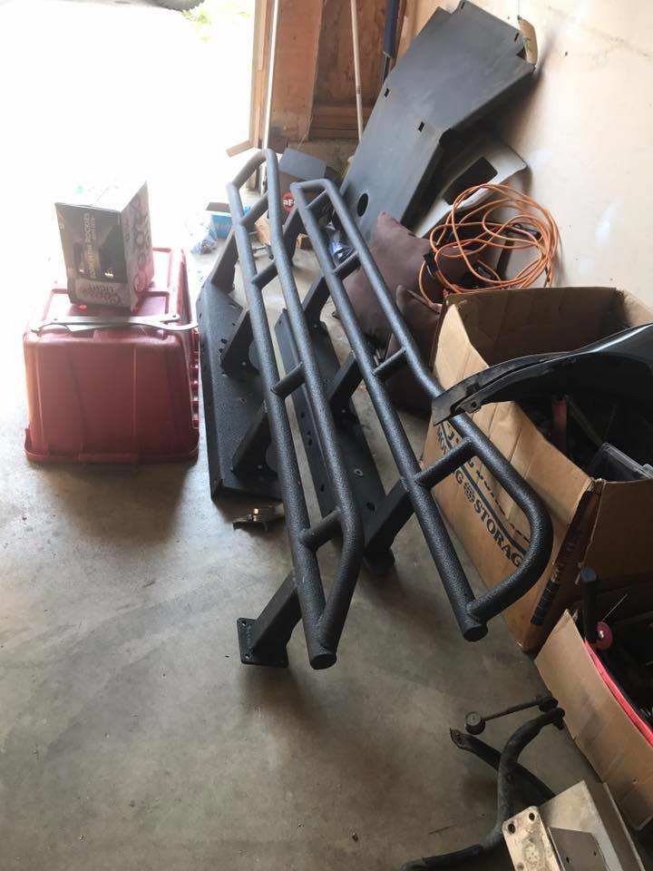

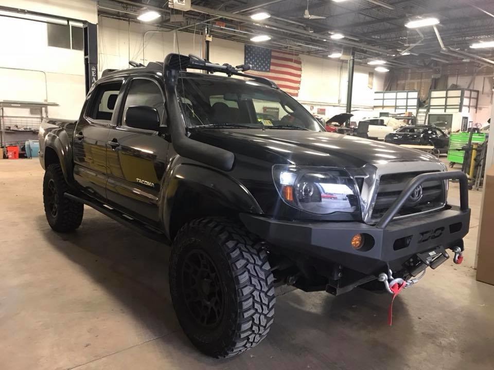

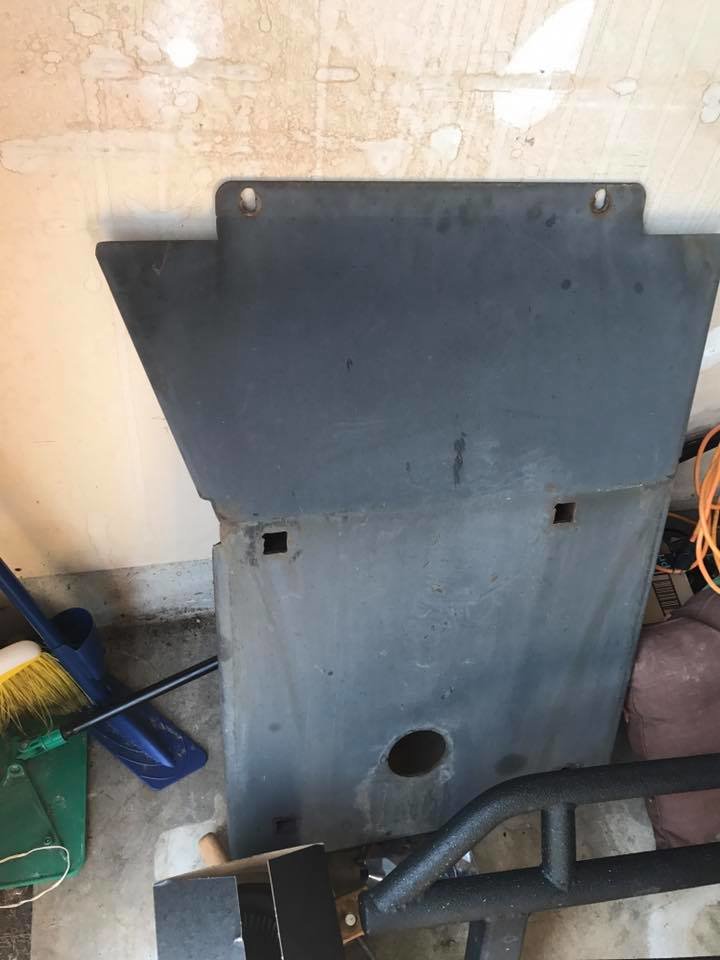

    sliders and skid!

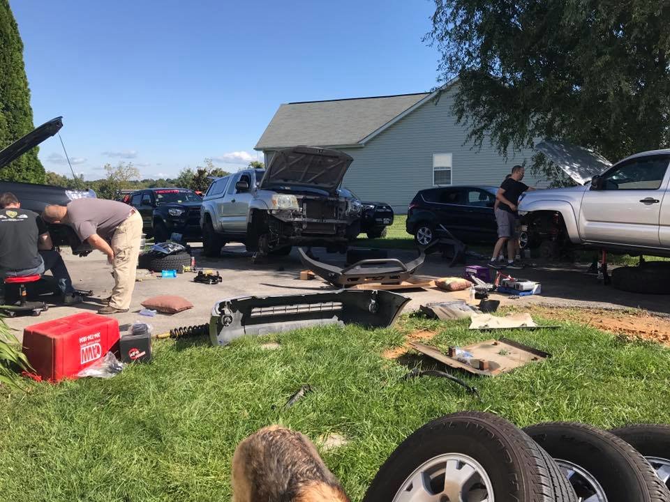

    21430071_1391882157599722_31935447239745_caf720807e46064c740be77fa7d1a5ab7181e453.jpg
    21433043_1391881970933074_74242922007629_5df2123a51b8582d7c21e48692fc8c2cdd38a0da.jpg

    the things that went wrong:
    1. I cut a sway bar end link (my fault) because I didnt see the Allen key to hold it in place to get the nut off
    2. we had to cut a castle nut off a UCA ball joint
    3. a strut mounting bolt had to be cut on one of the Toytec coilovers
    4. the AAL that we were supposed to install on my truck was broken in half
    5. my rear shocks have to be cut off (so we couldnt even touch the rear of either of our trucks)
    My solutions for said problems:
    1. remove sway bar
    2. ordered 2 new castle nuts for the UCAs from Fastenal (believe it or not, not one Auto Parts store had them)
    3. we put the Toytec coilovers in, but in 3 weeks I'm grabbing the Icons coilovers from ArcticElf... so I'll pull them out then and probably put them up for sale.
    4. Ordered a new Toytec AAL
    5. Ordered some el Cheapo eBay rear shocks for John's truck so I can cut mine off, and install the Icons
    ready6delta and Coot83[QUOTED] like this.

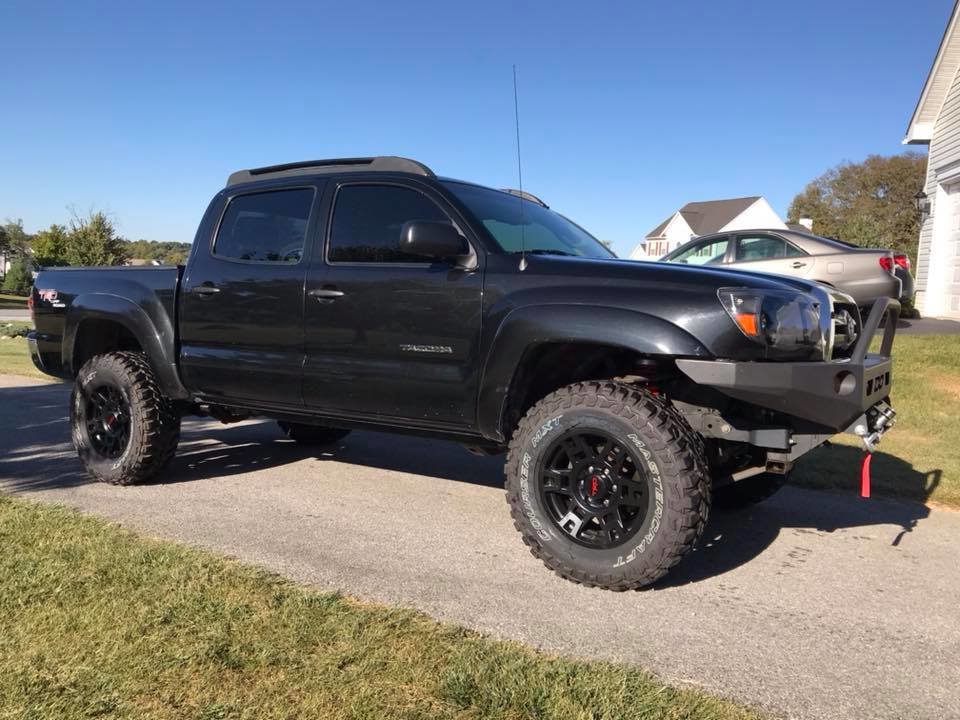

    updated with a new "how it currently sits" pic
    more to come soon as I start getting skids, sliders, etc.. installed... my garage looks like a Tacoma parts warehouse
