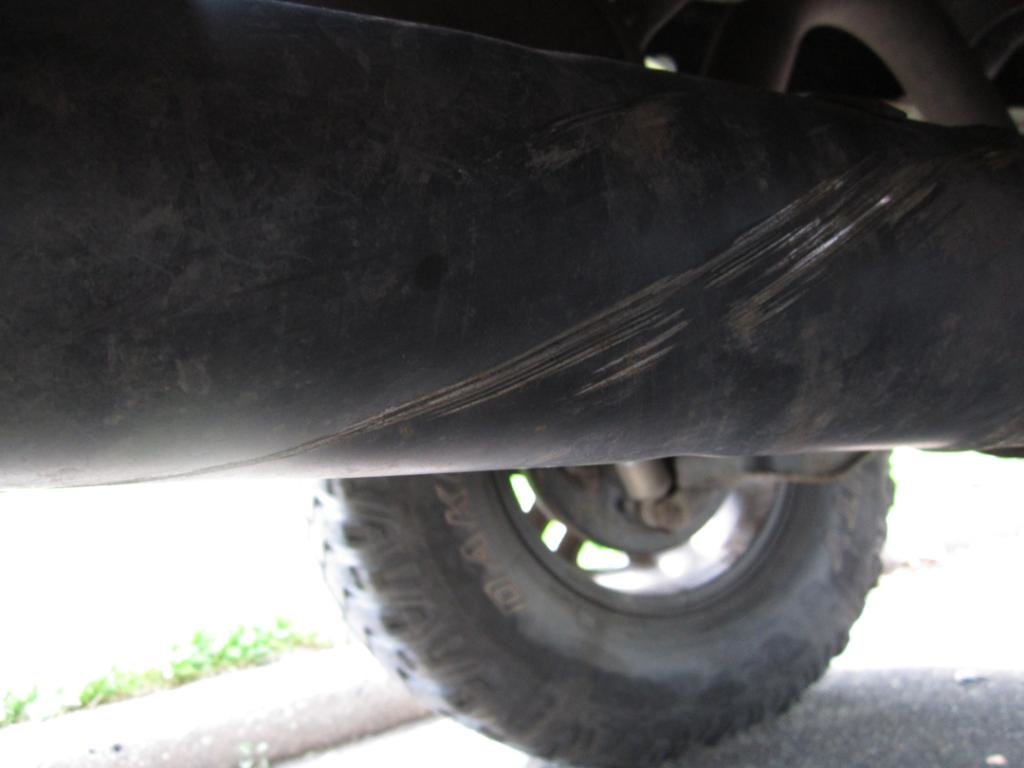

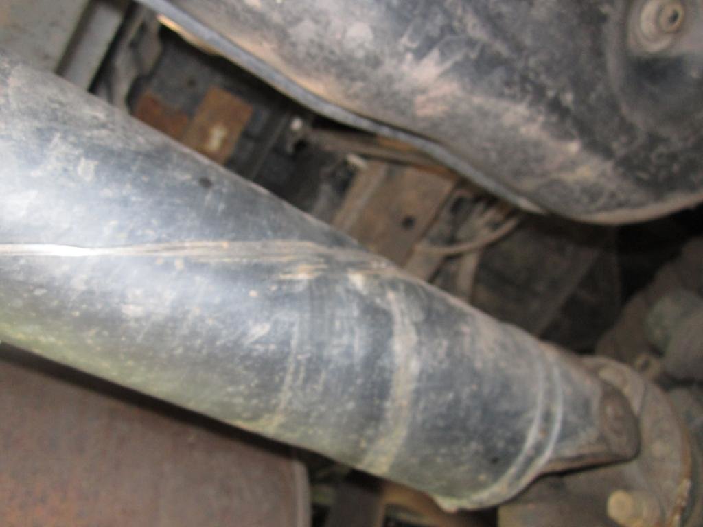

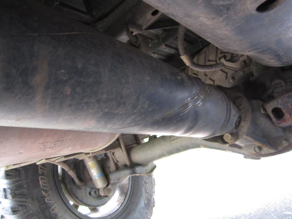

    Can anyone tell what the measurements, length, etc. for a '05 DCLB 4wd Driveshaft weld to weld is?
    Or tell me where I could get that information?
    I candy-caned mine at Rausch Creek PA this weekend and am trying to find a replacement.

    and why you no measure yours?
    just bring it to a shop and have them retube it and be done if it is bent that bad......
    i have c.c. mine more then once and have no ill effects from it.....

    What type of shop? How much $ for "retubing"...My CC looks deeper than those do....
    I found a used "propeller shaft" this am for $400.00....

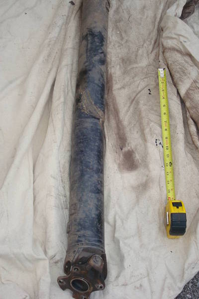

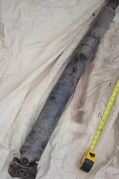

    Found a shop in Harrisburg, will Retube for $150!!!:D:D:D:D:D

    That includes rebalancing front and back shafts...and he'll get me a good price on the U-Joints!:)

    He said he will retube the rear shaft section and rebalance the whole shaft together......
