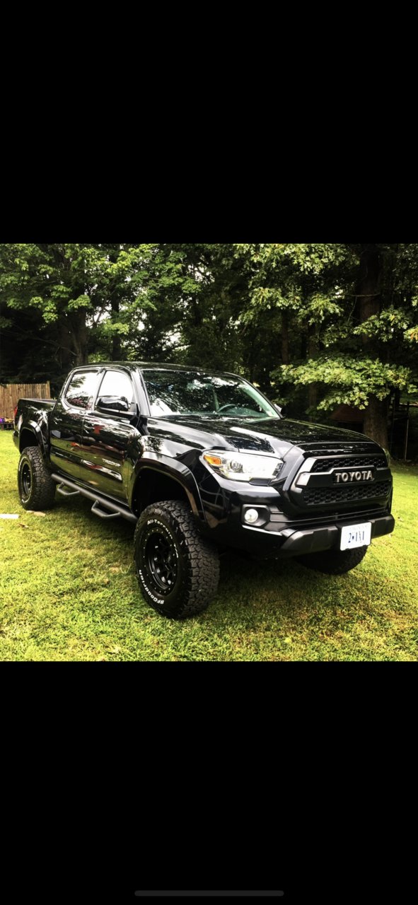

    DE6F9CAB-F09D-48B1-AA99-3D3FCDE380DE.jpg Here’s how it sets with the heavies and 887s at the moment.
