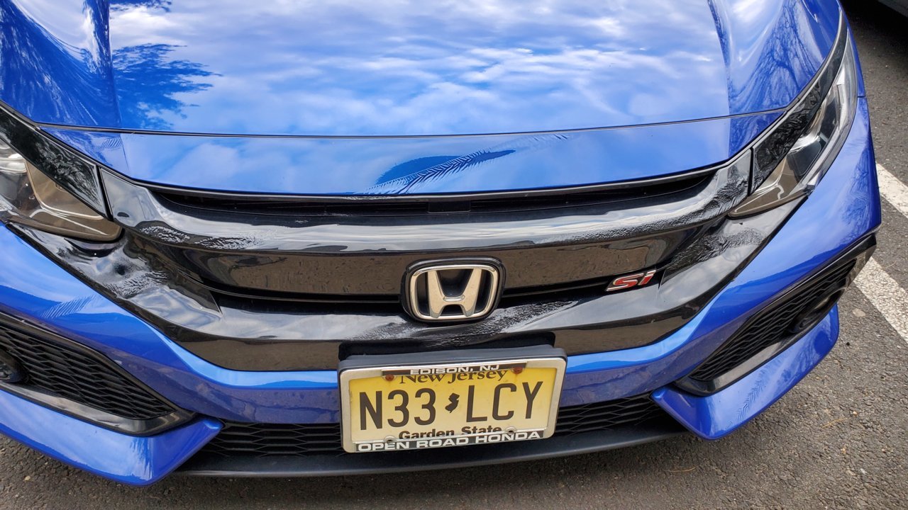

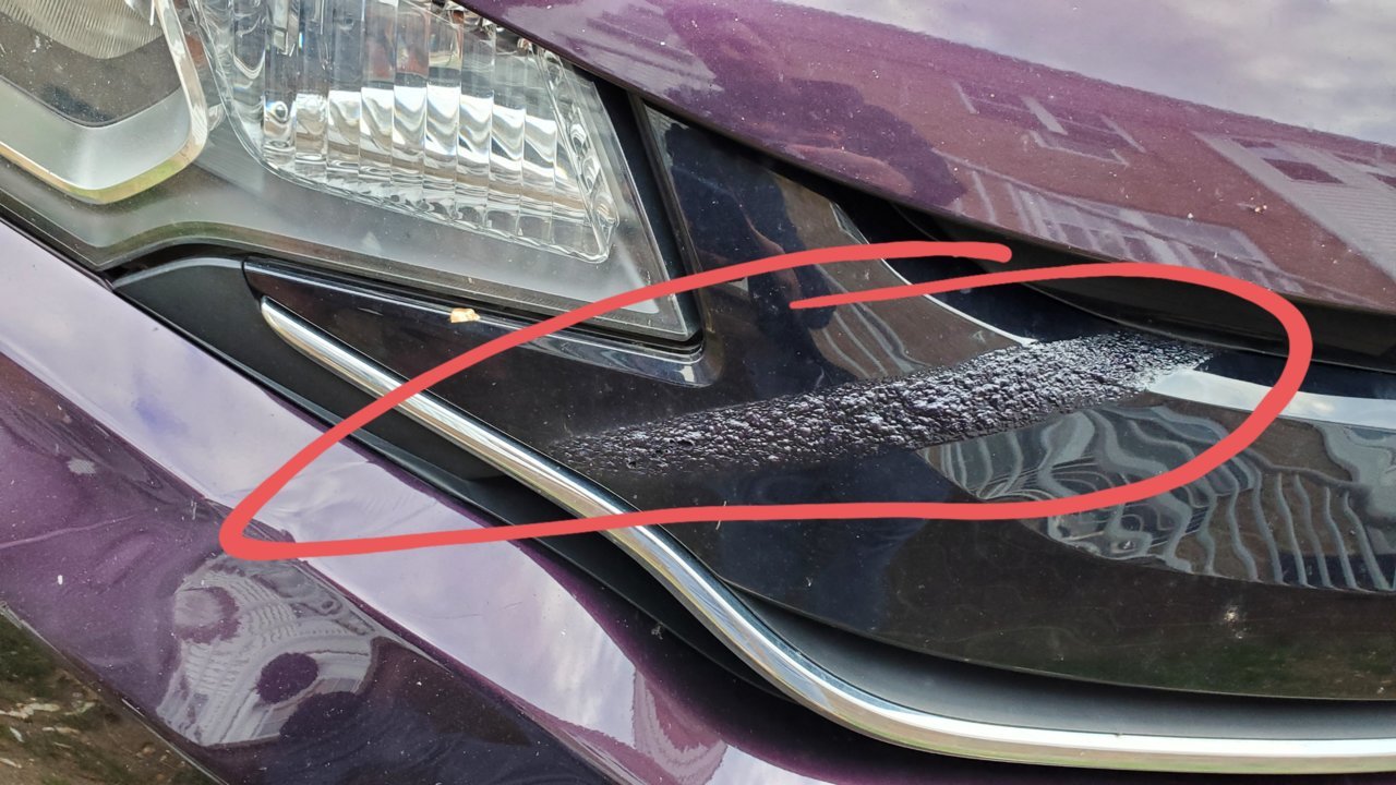

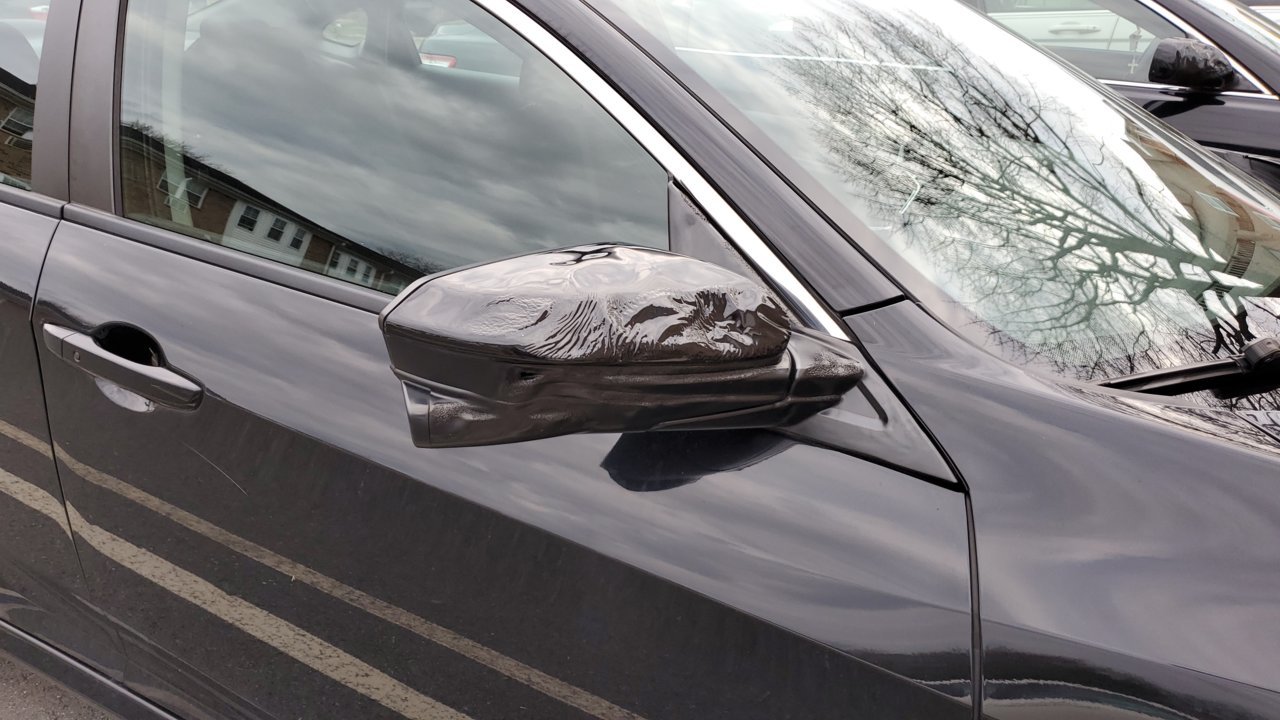

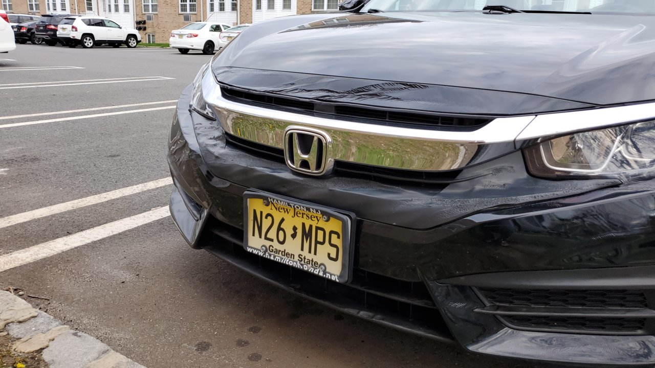

    I leave in New Jersey and it has nothing to do with Toyota Tacoma. I was really amazed by observing this and can tell you this one of the weirdest thinks i have seen in my life. I was walking around a building in a particular development in my town and took pictures

    You can see the direct path of the magnified light, across those cars.
