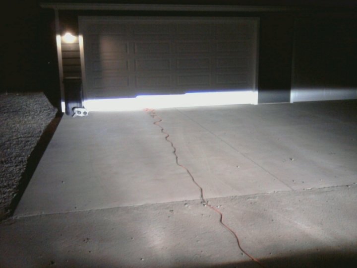

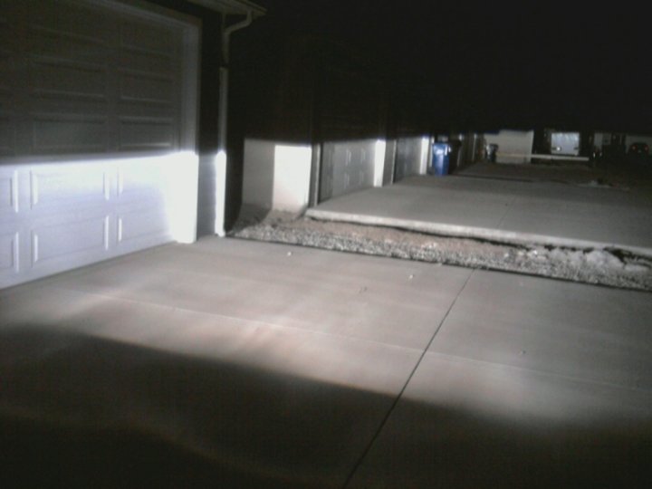

    Right with ya on the retrofit! I should be able to finish mine tomorrow sometime since the weather has been amazing! light output is super bright:
    (sorry for crappy cell pics, all i have atm)
    48f1cd86-7eb3-4283-98c3-53f549f4310b_zps_6deb24705a4801da16befc24436f96cfd5bf4d4e.jpg
    Shooting a lil high, will readjust.

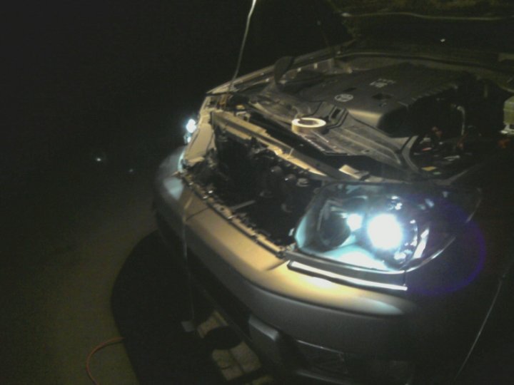

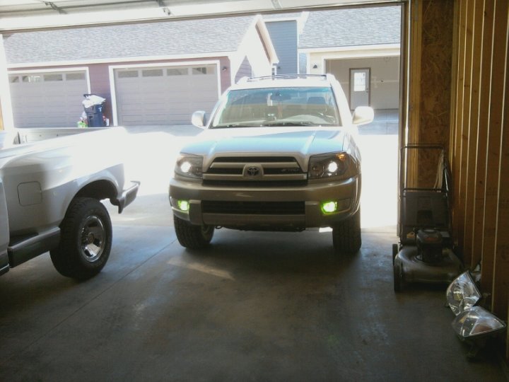

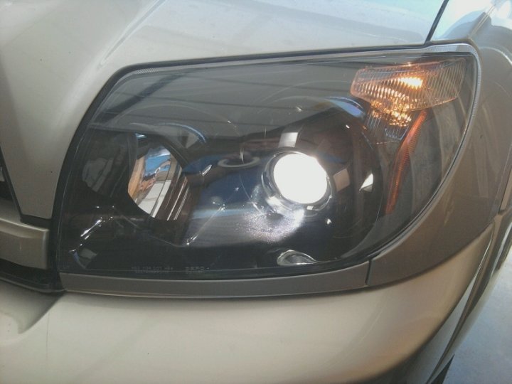

    Damn that sucks bad... Time to go buy another headlight. I just got mine finished an hour ago. I question if my right projector is on tight enough, I guess I will find out soon enough. I mainly just used cold steel to secure and aim them; I was origionally going with the bolt on design. Also a heads up, dont scuff the lens with your hand before you put them together, I failed, and have a little scuff on the left lens.
    Here is the finished result, havent plugged in my ccfl lights yet, that will be for another open weekend.

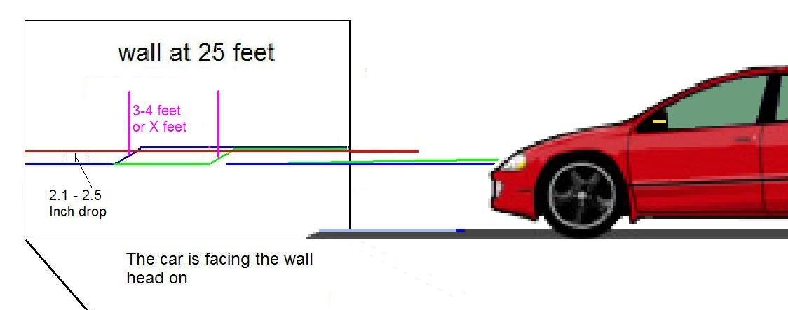

    Also I have a question, do they say that your cutoff should go down 2" for every 20ft?

    Looks pretty good! Here is a pic for you to give you an idea of how to aim them... But yes, 2" every 25 feet or so. 20 feet for a taller vehicle like yours or mine is very applicable as well
